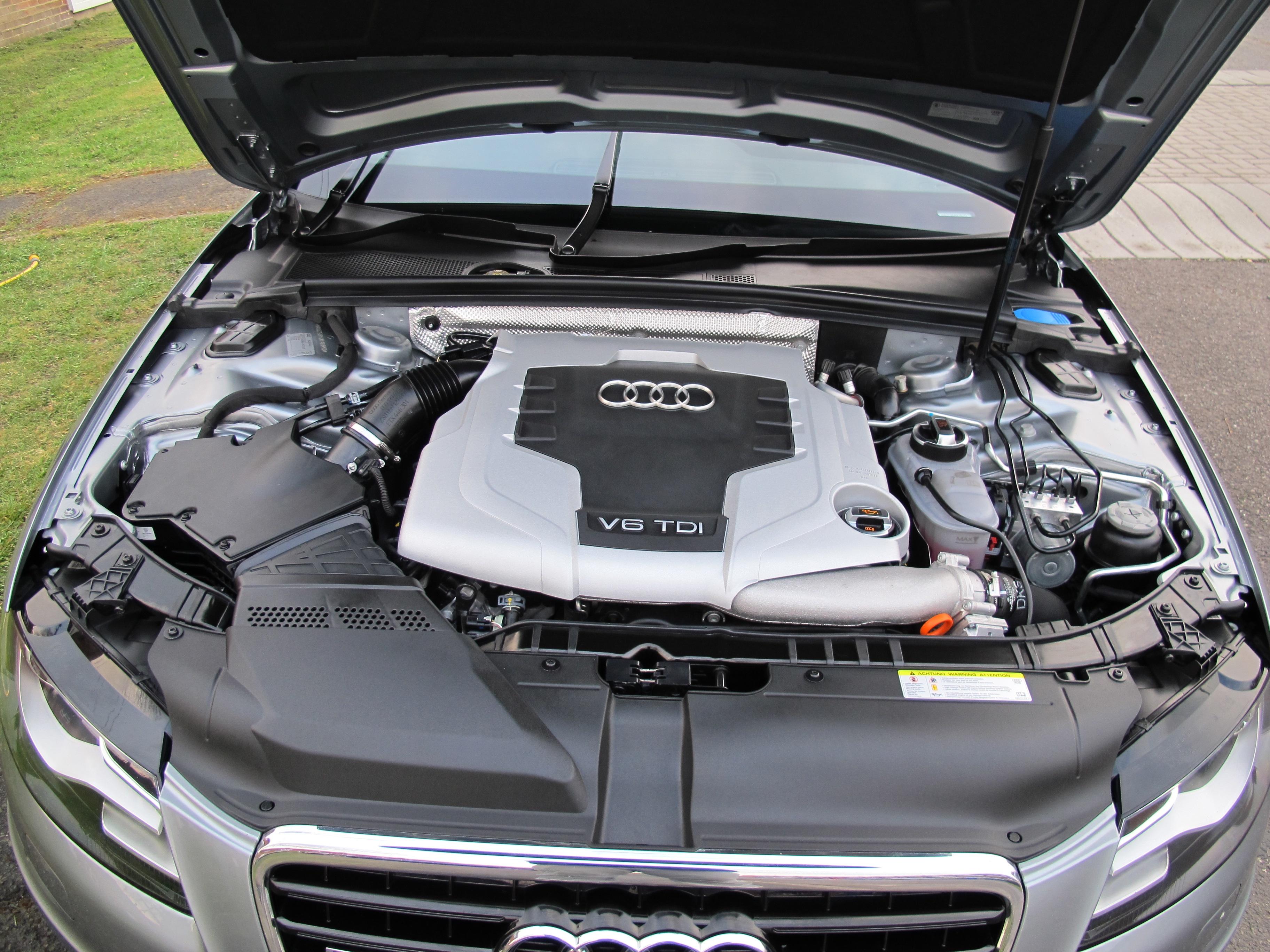

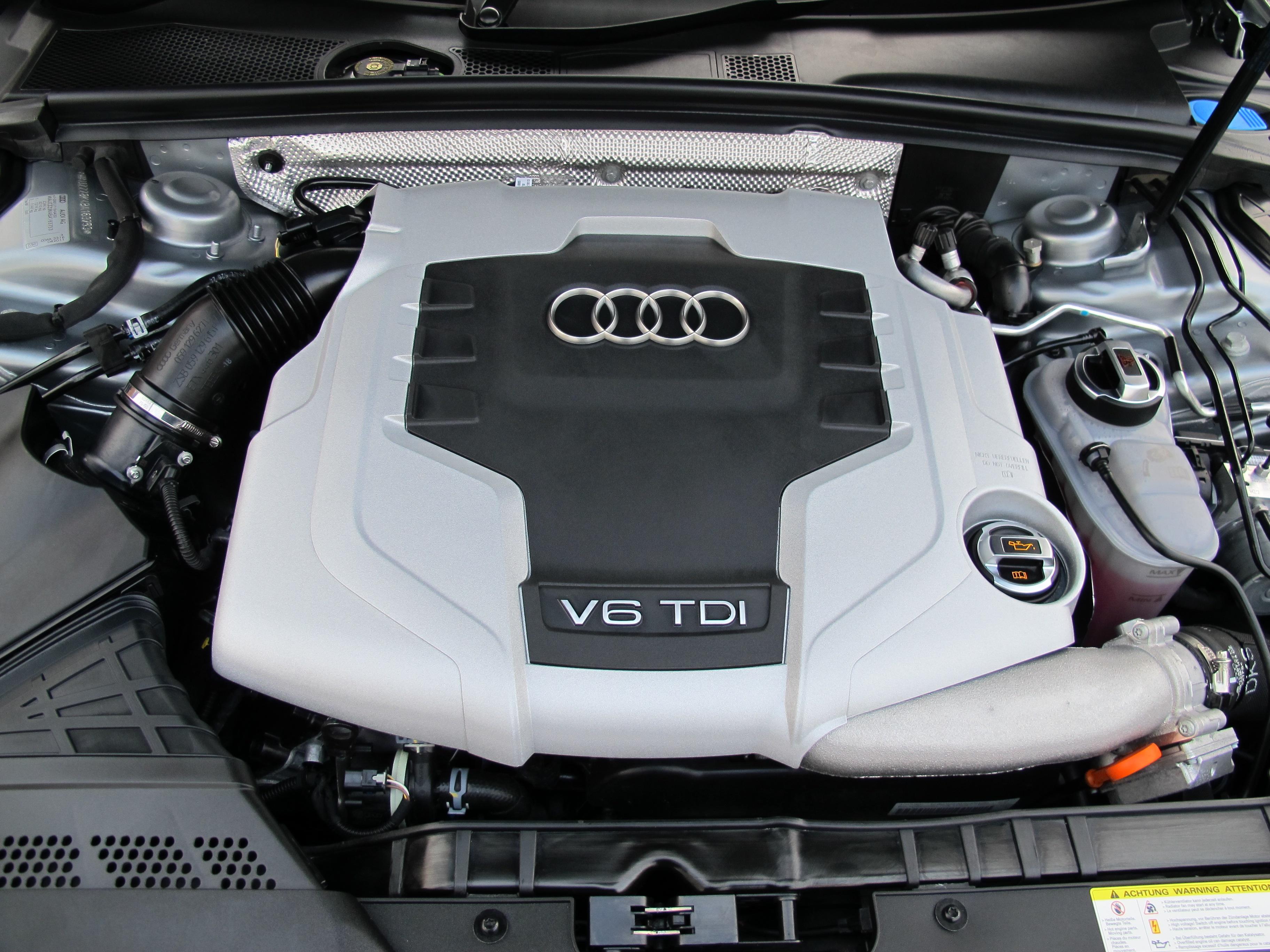

Engine bay cleaned with APC & dressed with 303 Aerospace Protectant

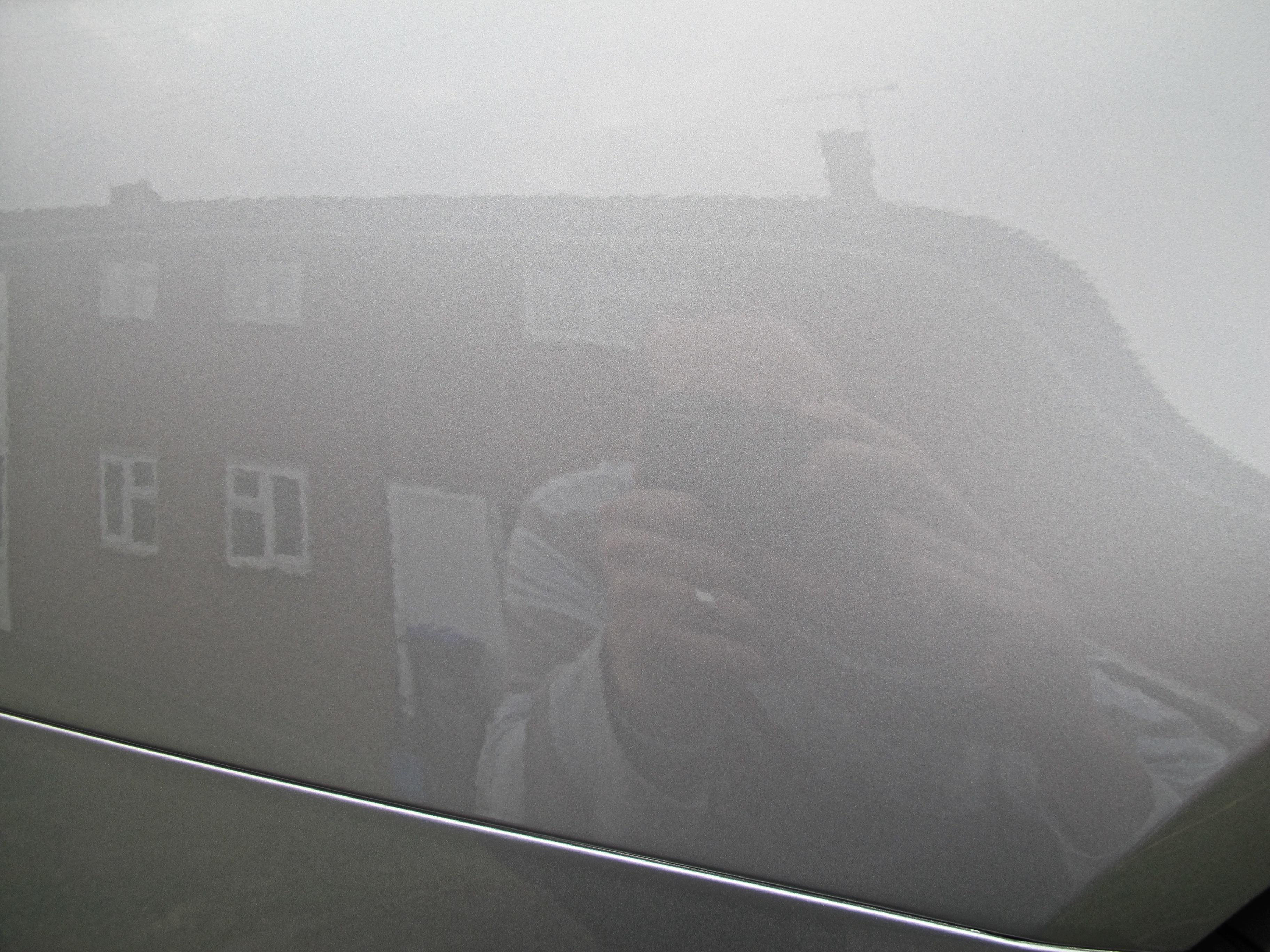

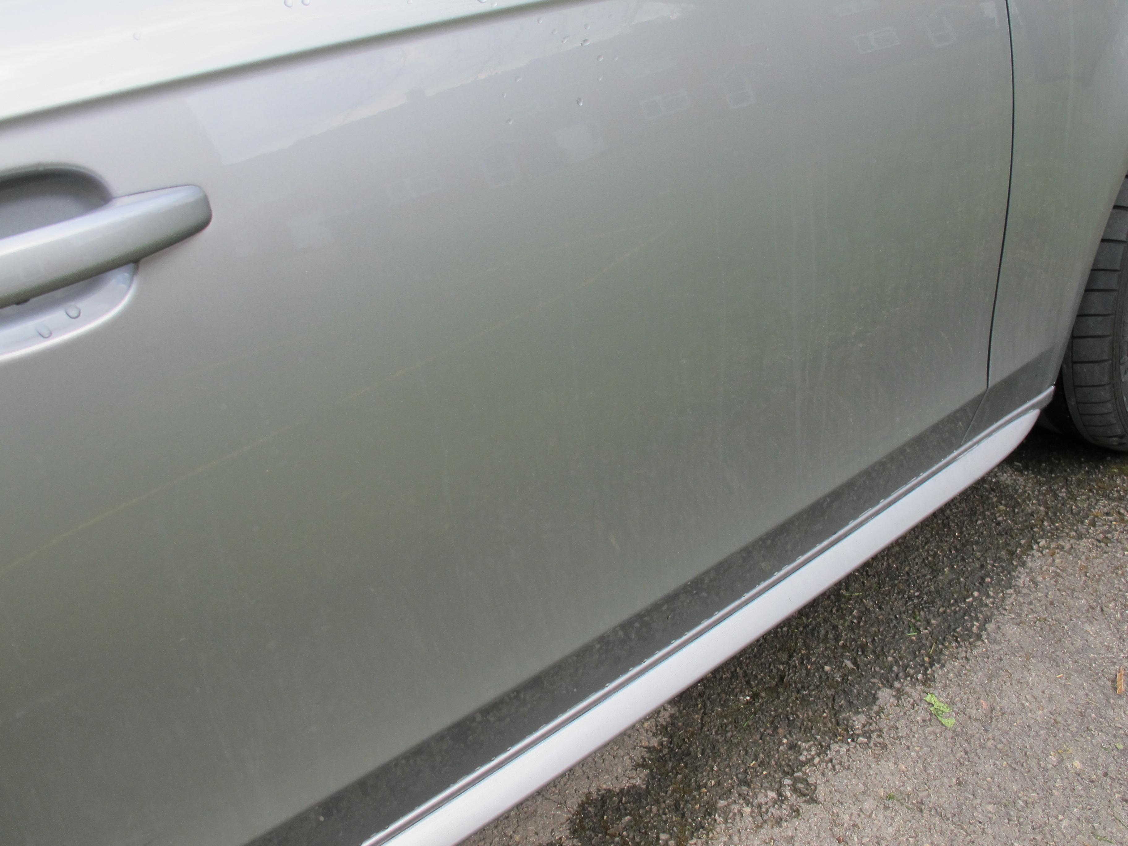

As for the polishing problems. I first tried a Yellow 3M pad with Menz PO85RD 3.02 however the swirls seemed to stay :confused:. So i switched to an Orange compounding pad and this did very little. So i changed to Menz S500 and that still did very little. At this point, due to my inexperience, i decided i wouldn't go any harsher as i didn't want to ruin my mates car. So if anyone has any tips for polishing Audi Diamonds i am all ears  :laugh:. I was tempted to switch to the 3M Perfect it system as i have all 3 Polishes and Pad combo's but I never had the time to spend on the car. So i spoke to my mate and showed him what level of correction i was able to achieve and he was happy as he couldn't see what i could see  :signLOL: Maybe i'm too anal  :grin:

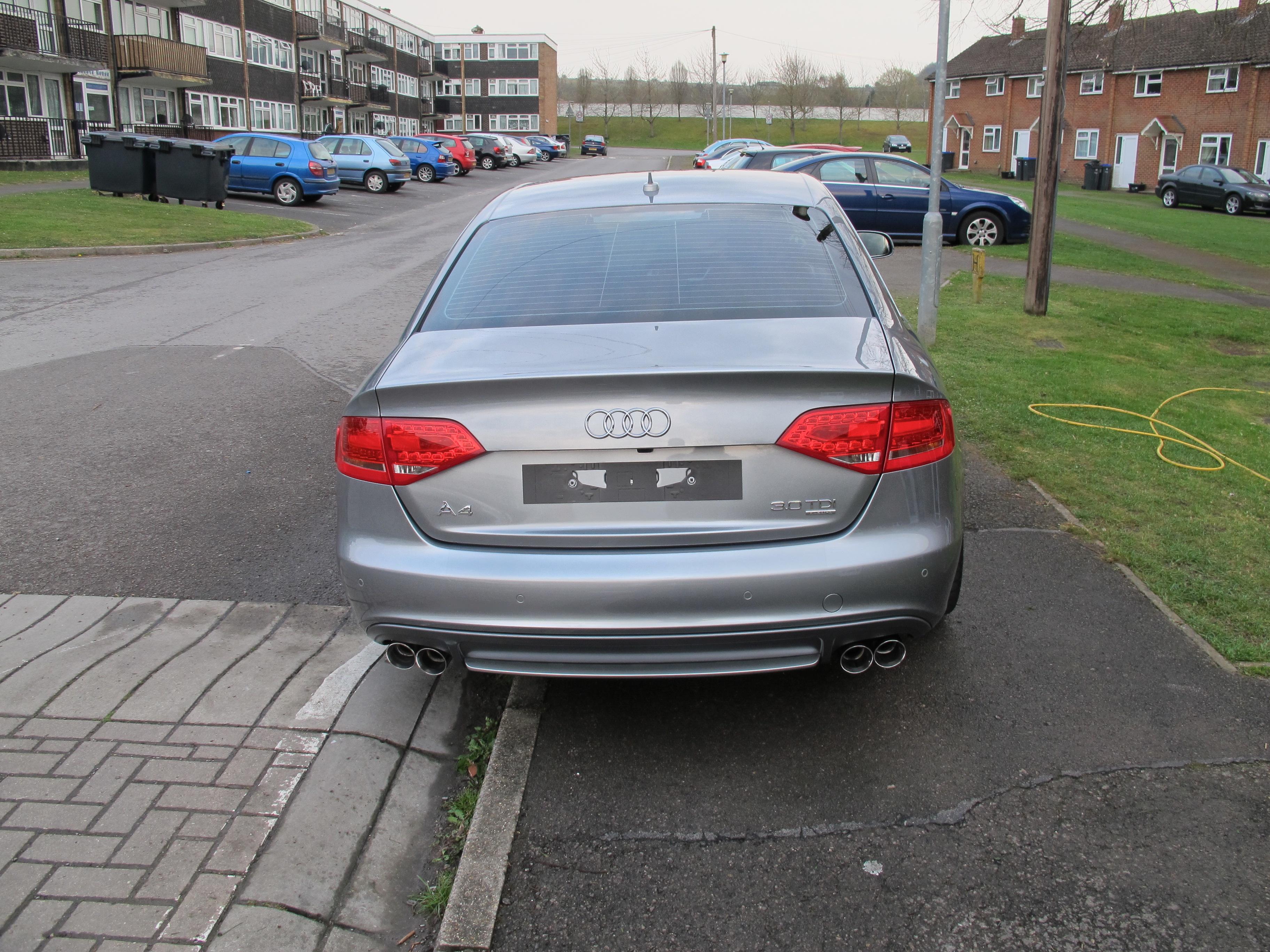

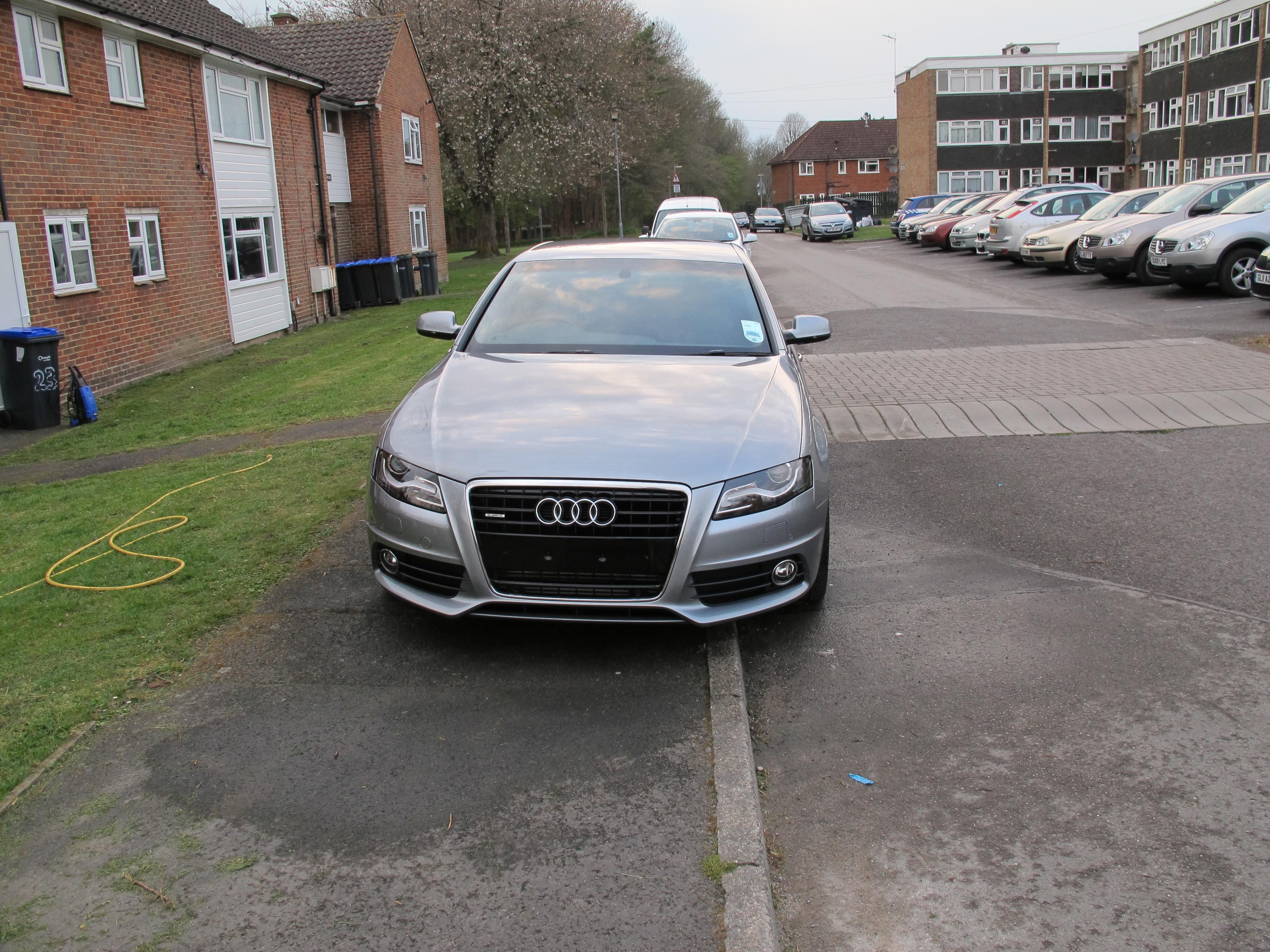

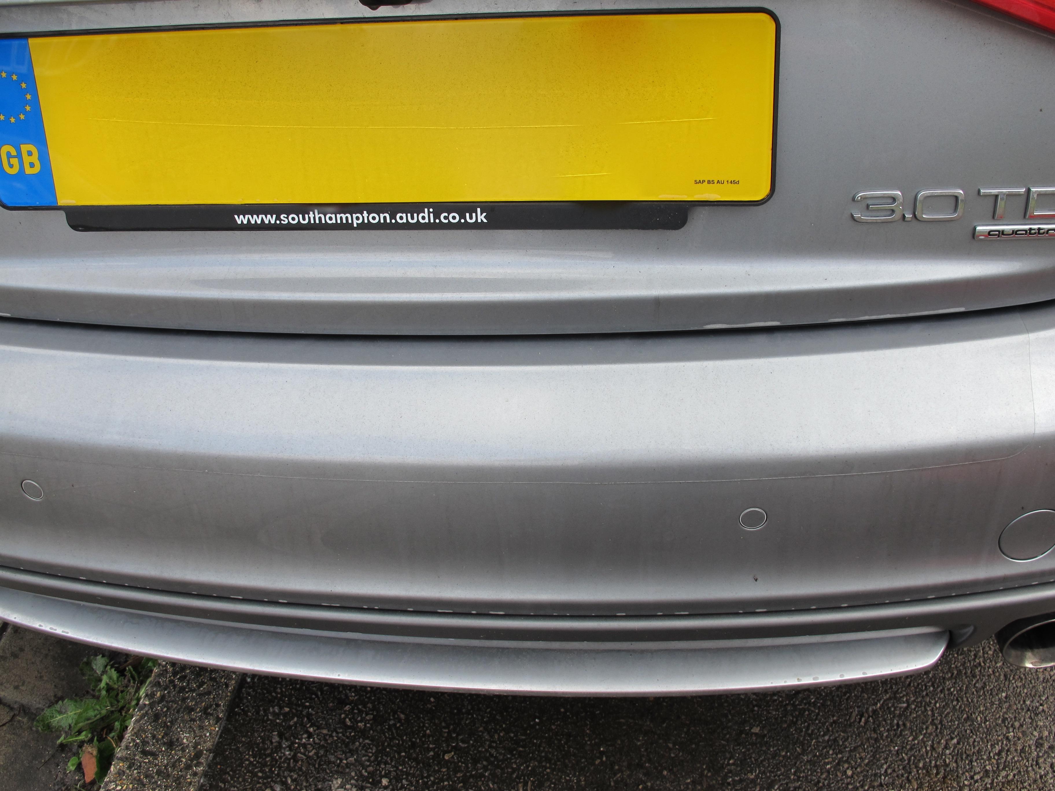

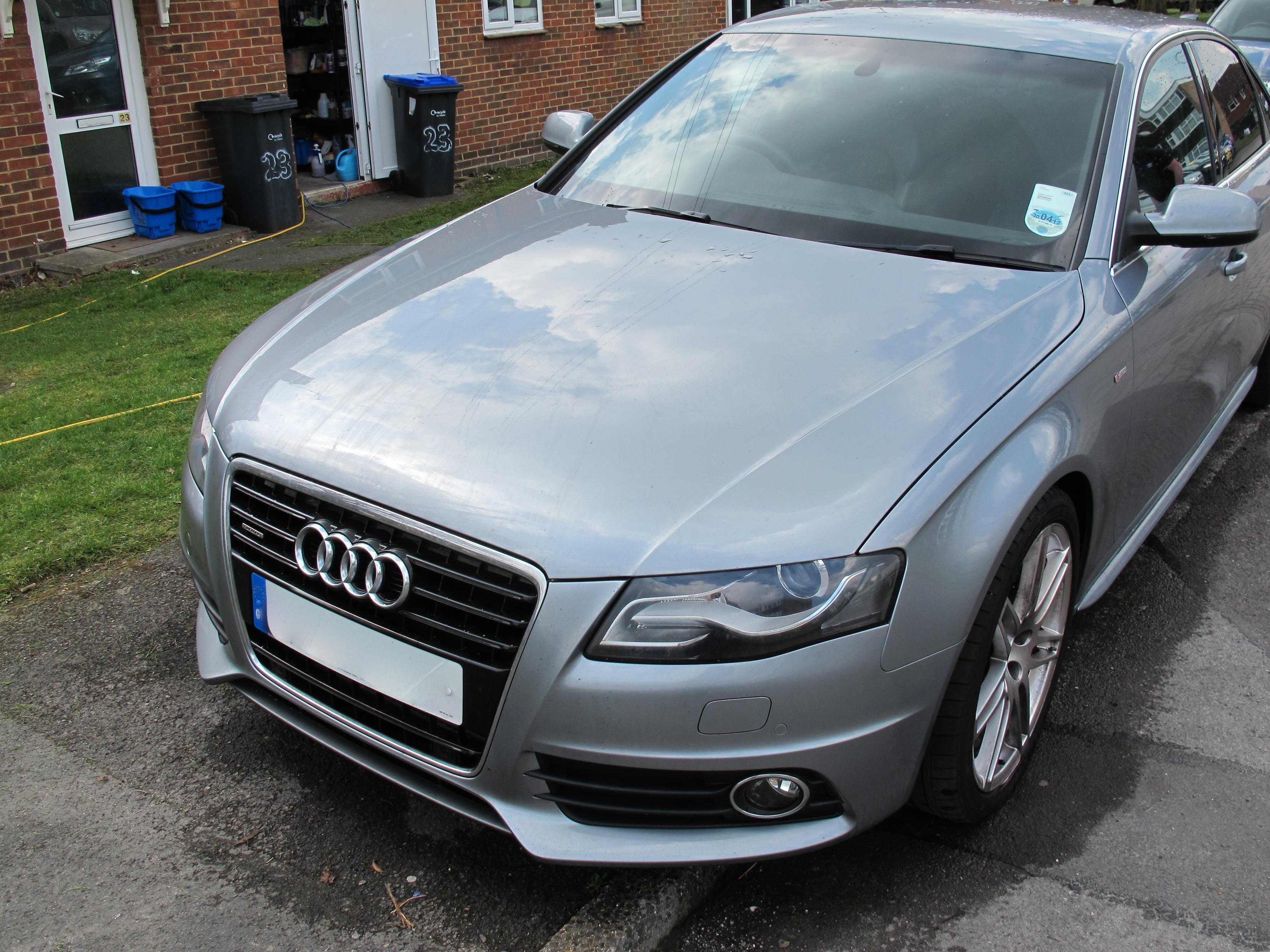

Anyway this is how the car turned up
Not great pics but you can make out the traffic film etc on it.

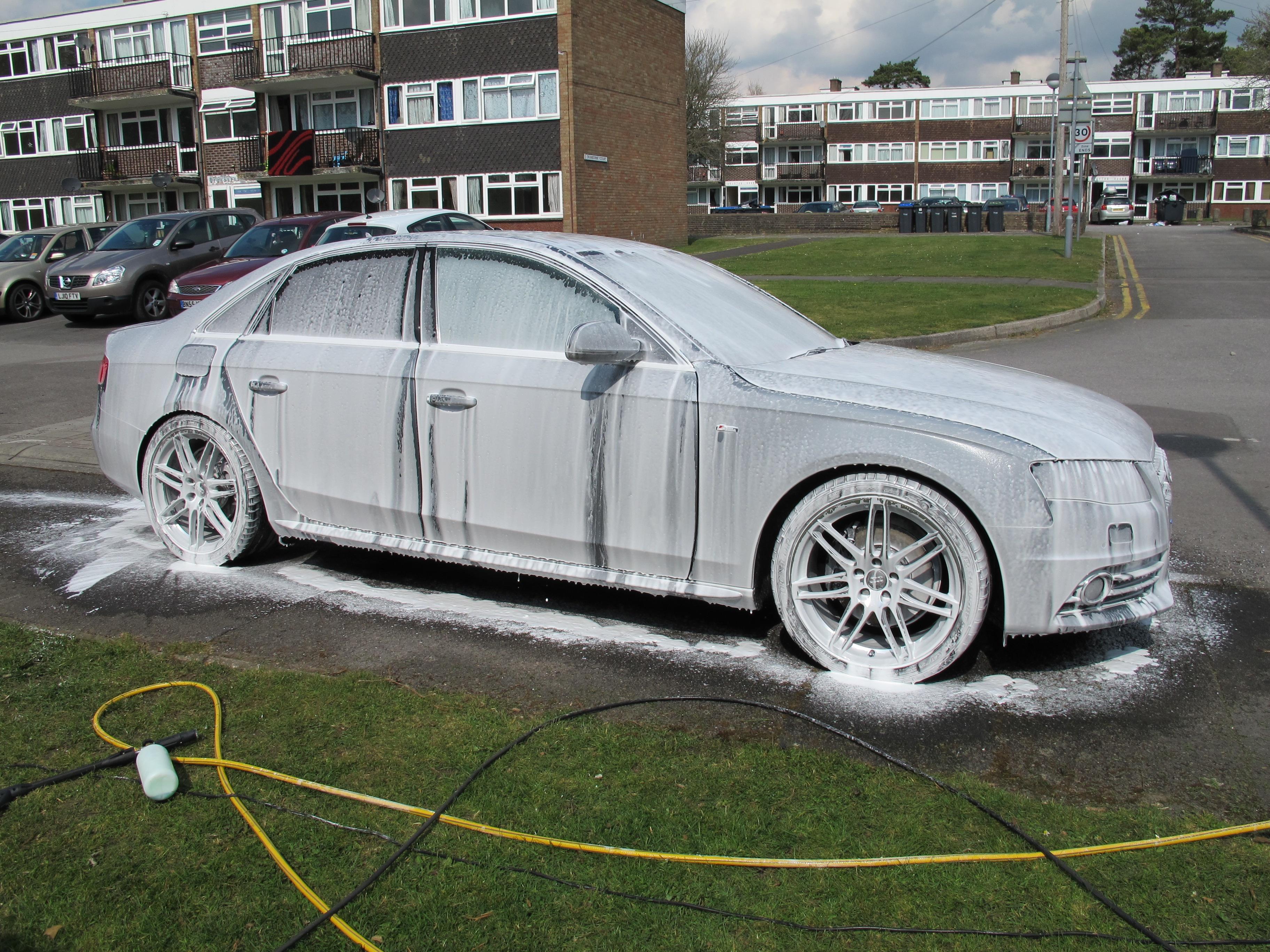

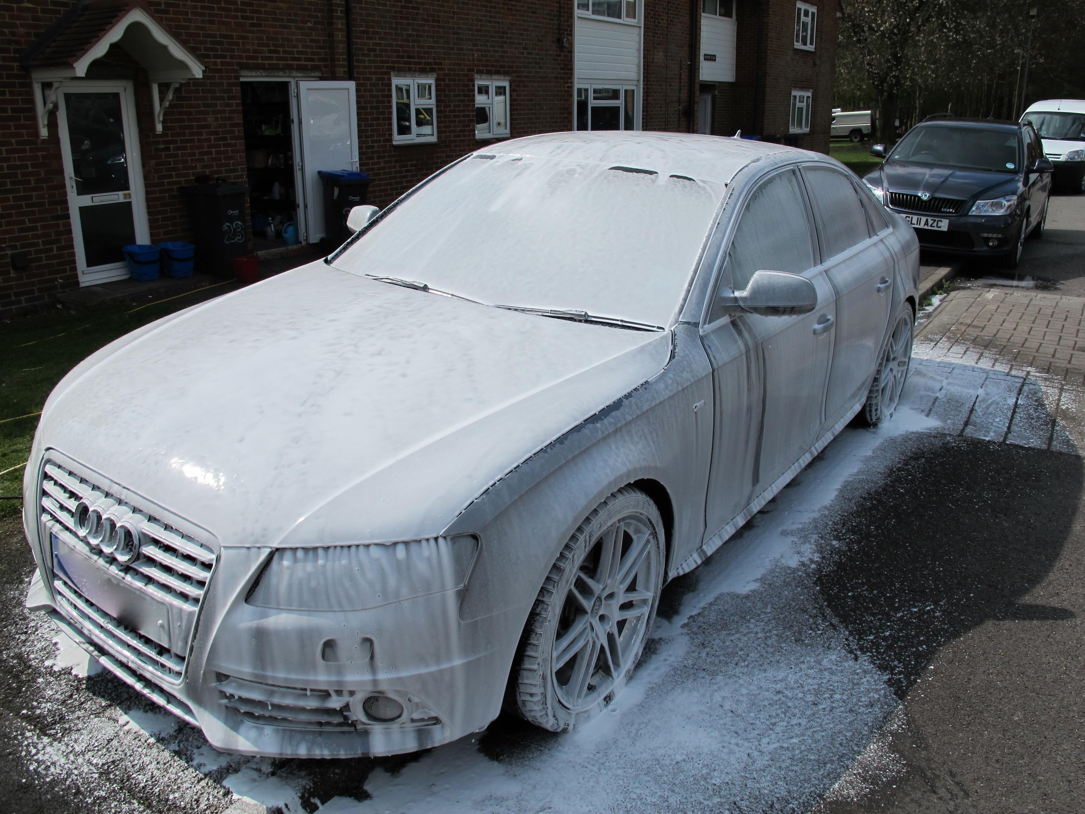

So the car was then cleaned - Requisit Snowfoam pics

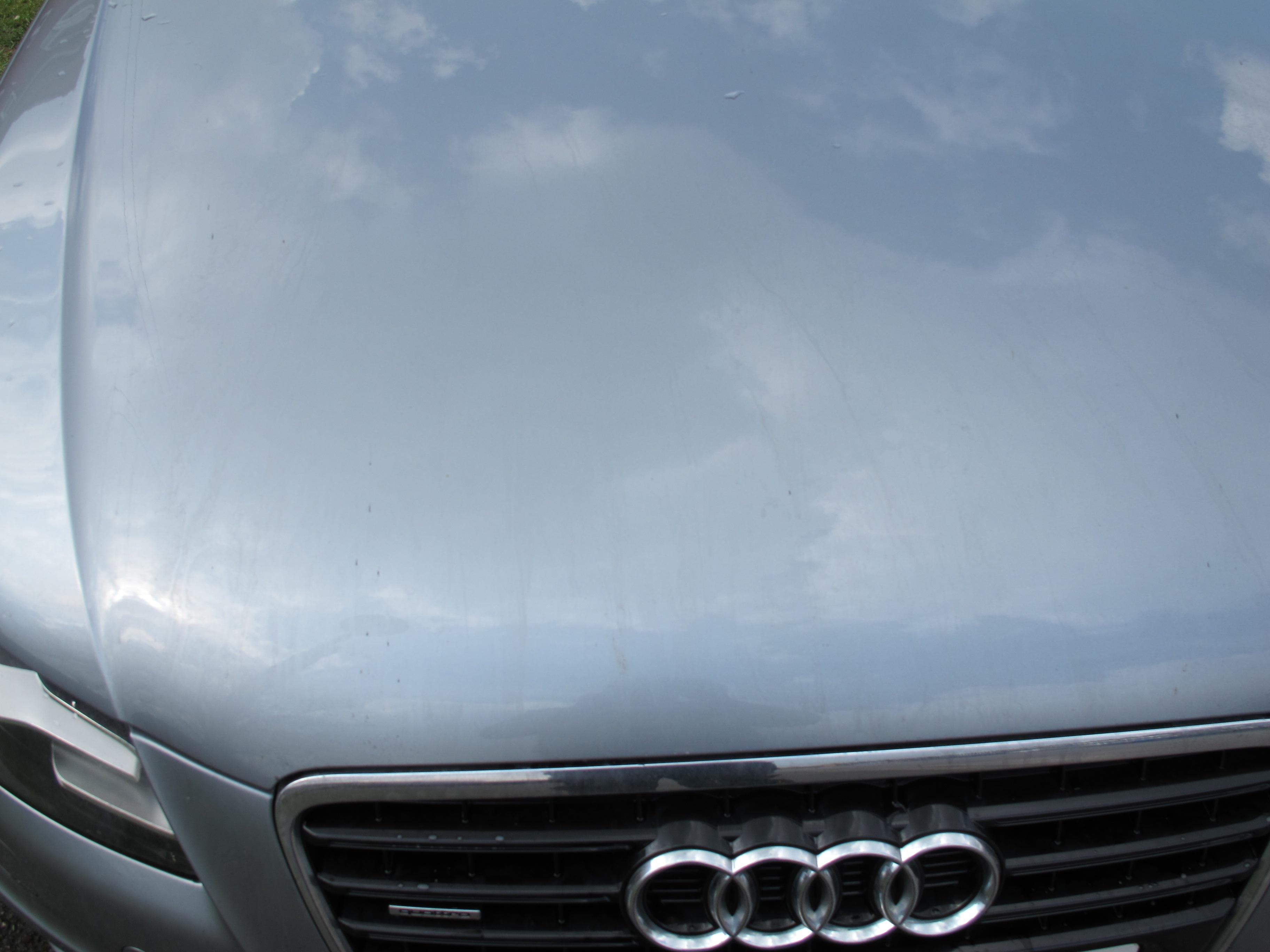

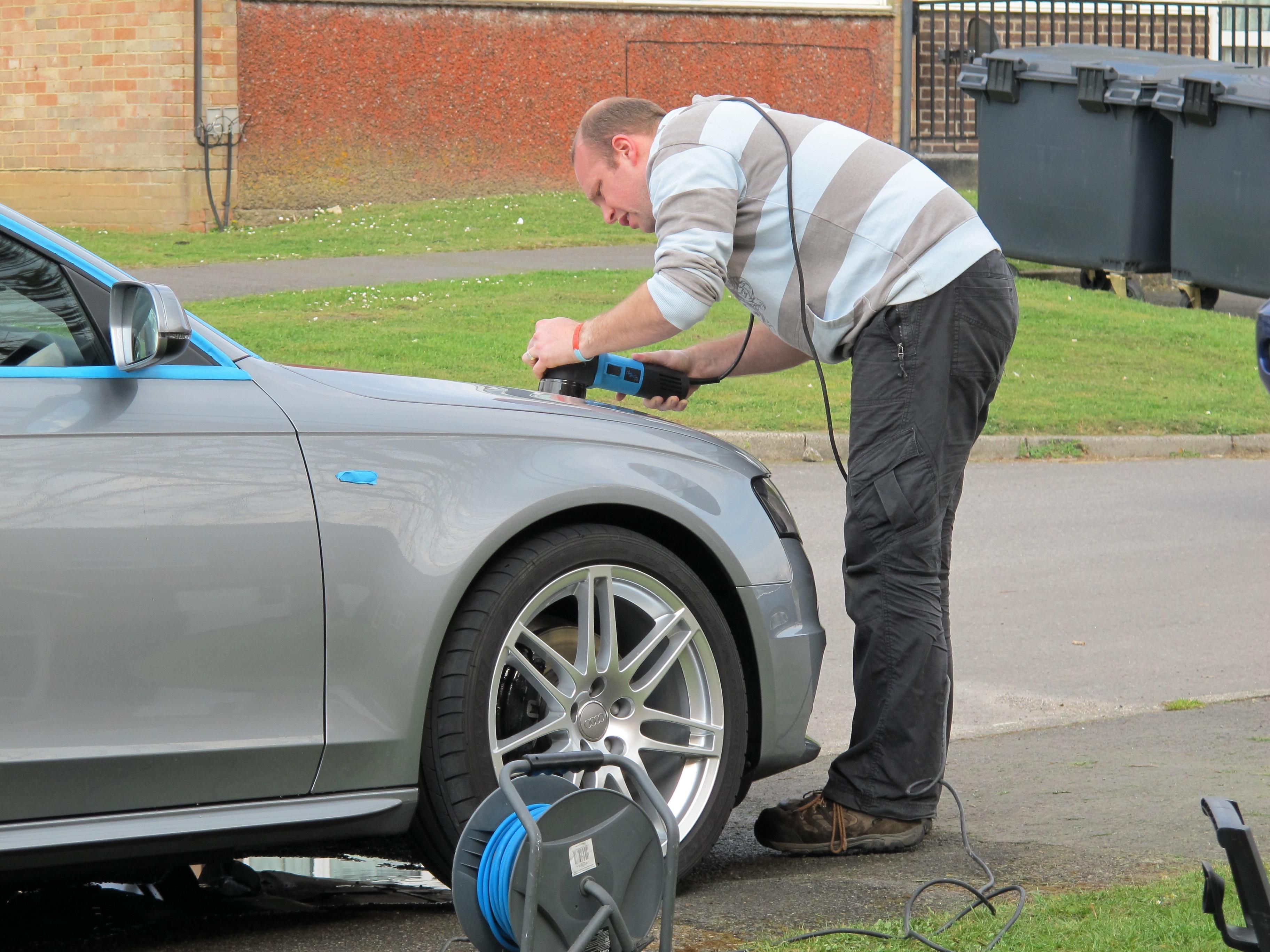

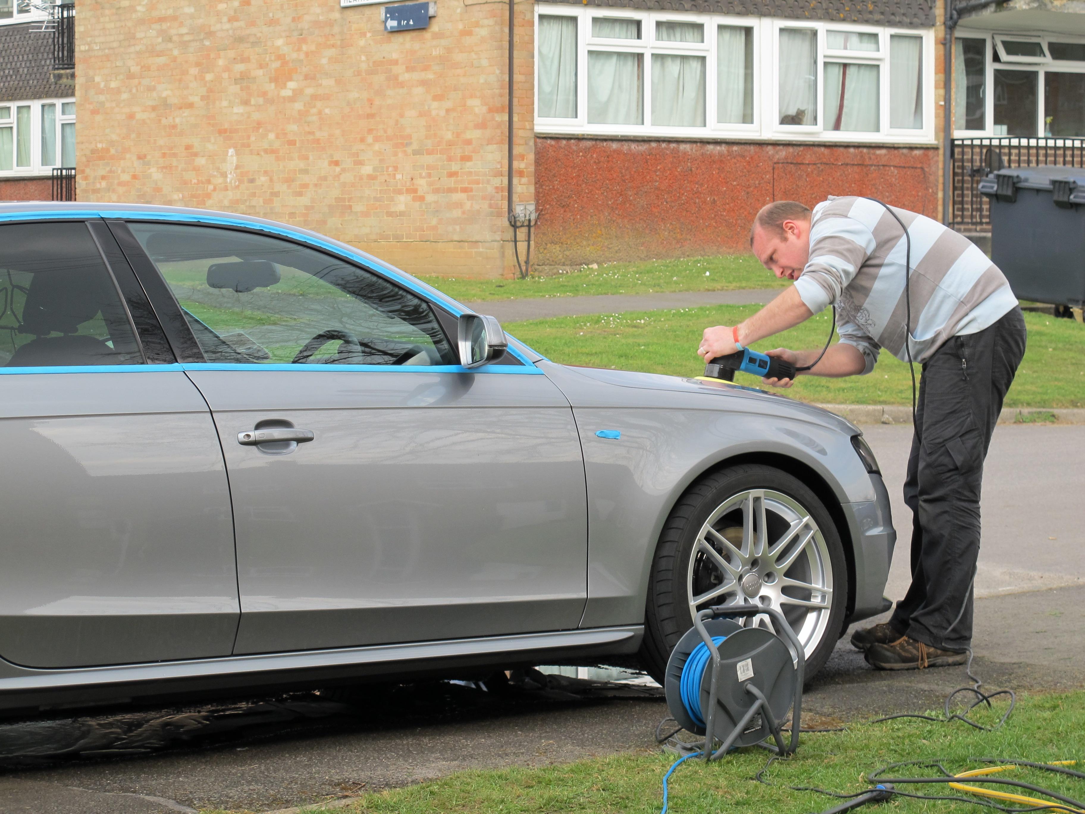

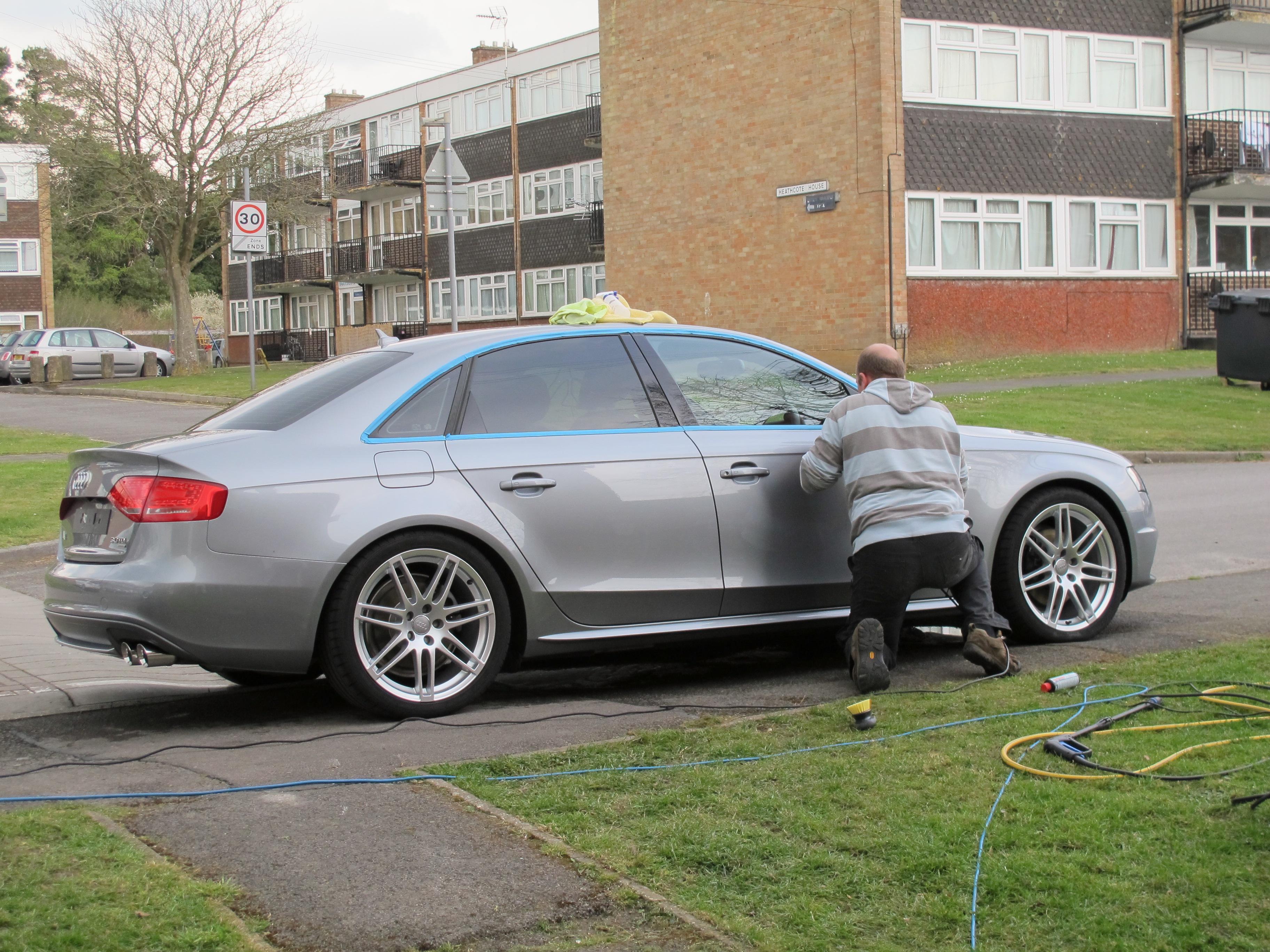

Then all taped up and the polishing began - No comments about the bald patch please as it is actually a 3rd eye  :grin: :grin:

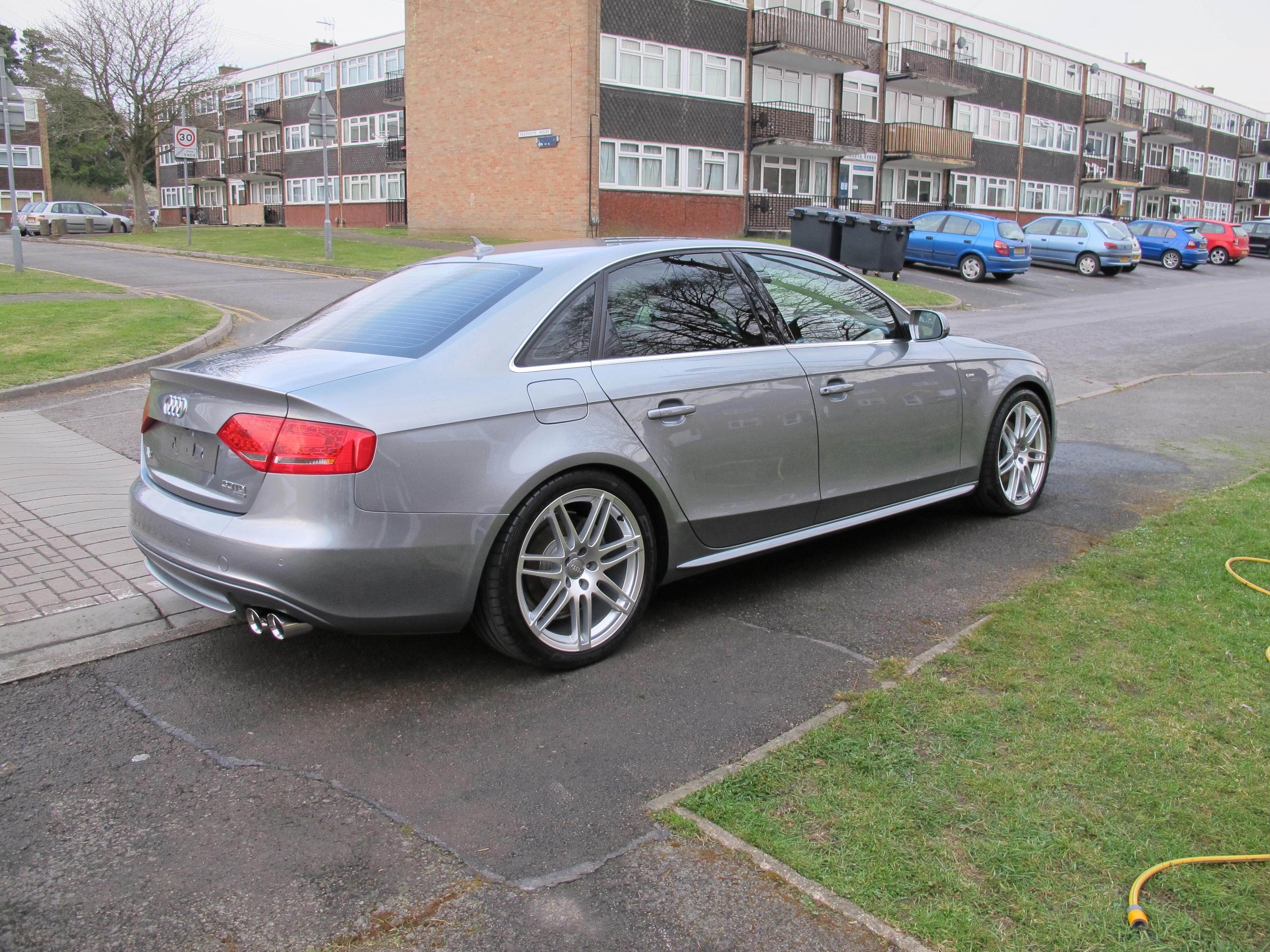

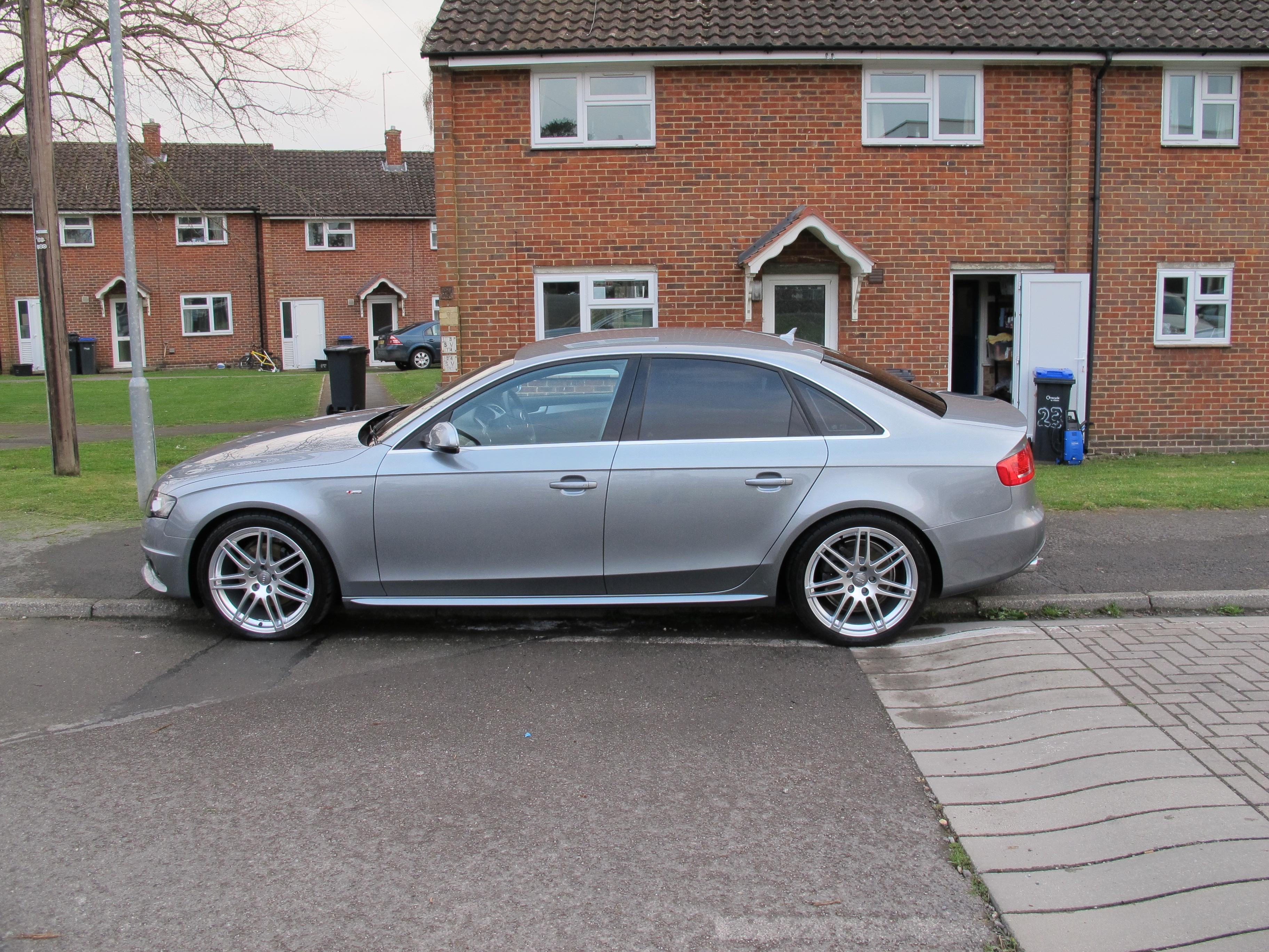

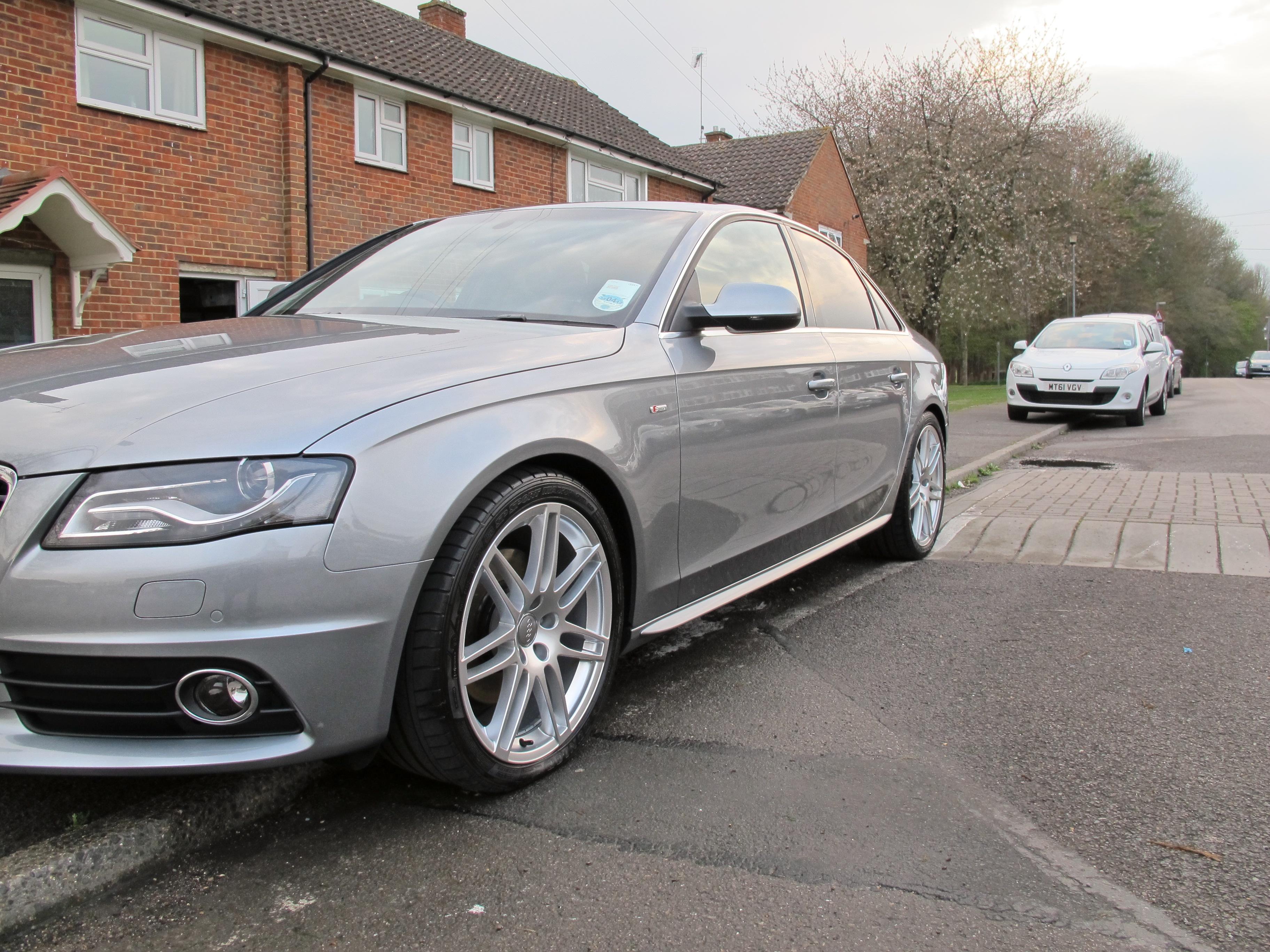

The Results

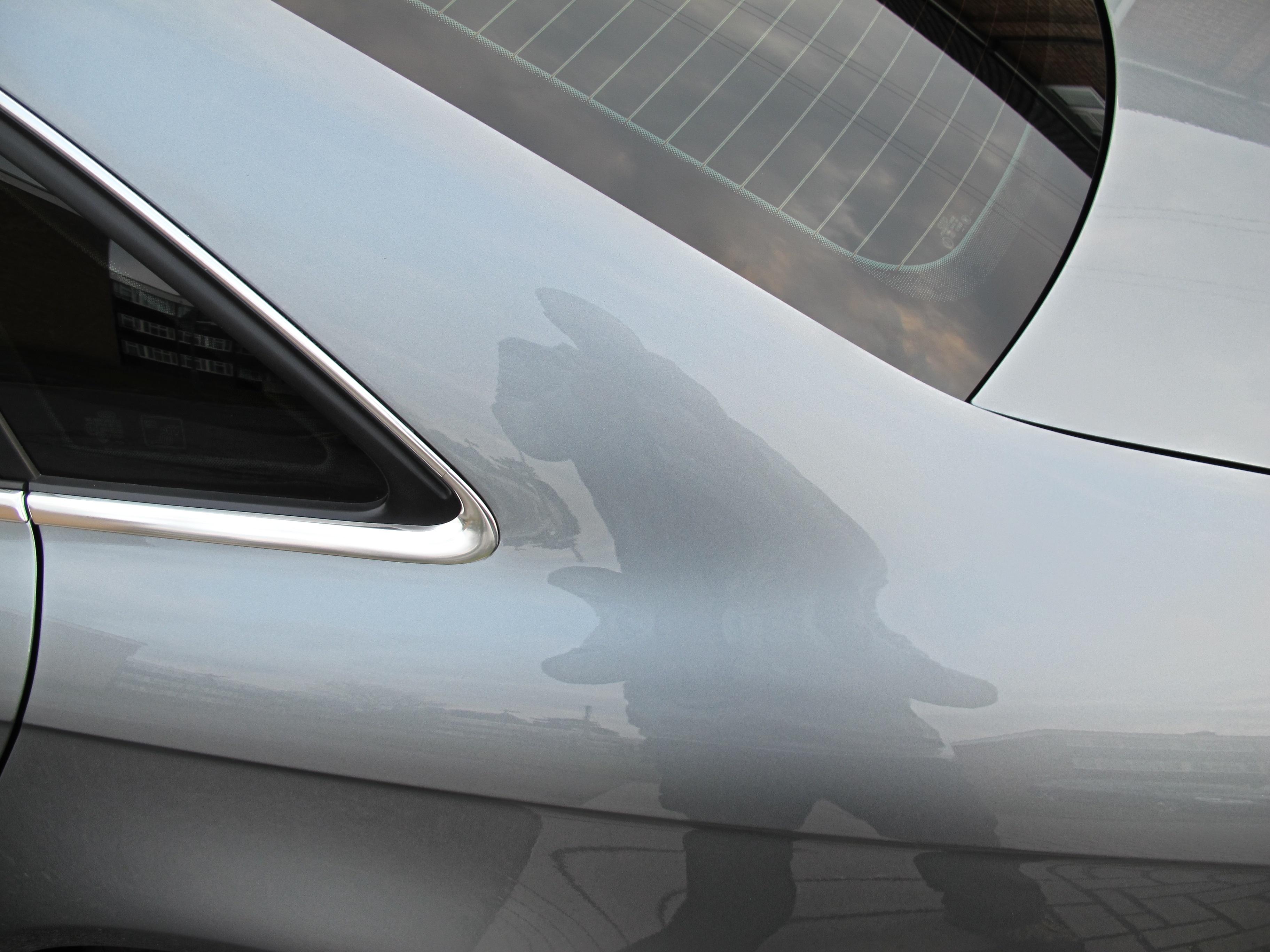

Close up of Shine from C2 & C1.5 Combo
My mate was happy as he said it looked better than the day he picked it up from the showroom. So i was fairly happy.
