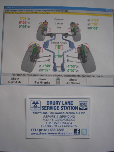

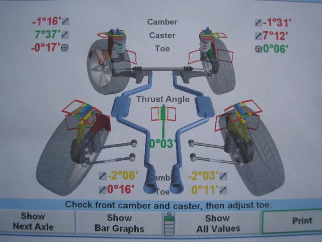

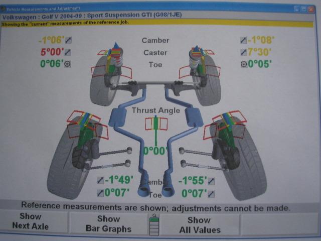

Basically i have been getting weird noises front end since fitting suspension and wider wheels geometry was set up, i posted a pic of results on here, pritty much every one said looks ok.
Now it didnt get rid of the noise so i have been to another garage a guy off another forum who has looked at it to see if i was missing something, the only  thing he noticed was that my front wheels were toeing in!!!
He said on fwd cars usually the norm is toe out, he went on autodata and said the specs were 0 to -30clicks if i remember ritley so parallel to negative toe.
i understand why you have -ve toe as front raises under power but on lowered vehicles is this still the case.
He has put some -ve toe on it feels different heavier steering to be honest pritty good maybe bit too heavy but before with positive toe it felt lighter.
Any thoughts???
oh he isnt charging me so i am presuming he is being honest to the best of his knowledge.

Yep it was standard figures. But that's what the hunter machine set it too with toe in, was done at a Porsche garage in Warrington.
Last night the guy changed it to toe out slightly we marked the original setting so possible to put back exactly.
Just abit confused really, some people say toe in others say toe out
