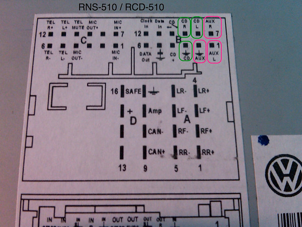

Offline MarkMarked
  • Posts: 62
Re: Installing MDI Kit - But have error 03138
« Reply #2 on: March 21, 2013, 11:13:07 pm »
Sounds like the pins are wrong on the AUX connector (the magenta ones in the image)
Double check them, which MDI kit have you fitted (armrest or glovebox)
