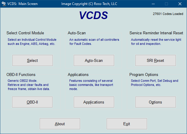

Since you have the vcds cable, just plug it in and do an autoscan. It should pick up a stored fault code to help troubleshooting as your engine management light came on.
To do the scan, start vcds and you get to this screen
Click on Autoscan choose you model Golf mk5 then click start. Copy the scan result in the right pane and post it here.
