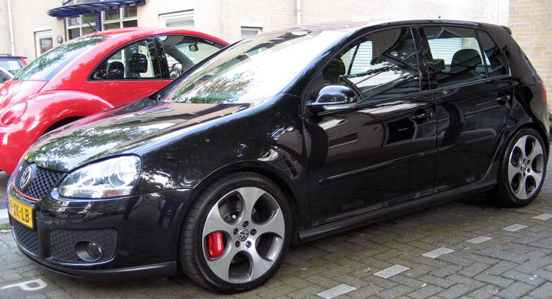

p.s. the car :
« Last Edit: May 10, 2009, 08:18:24 pm by Mark_GTIV »
