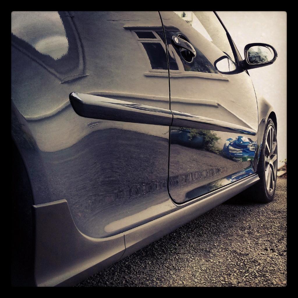

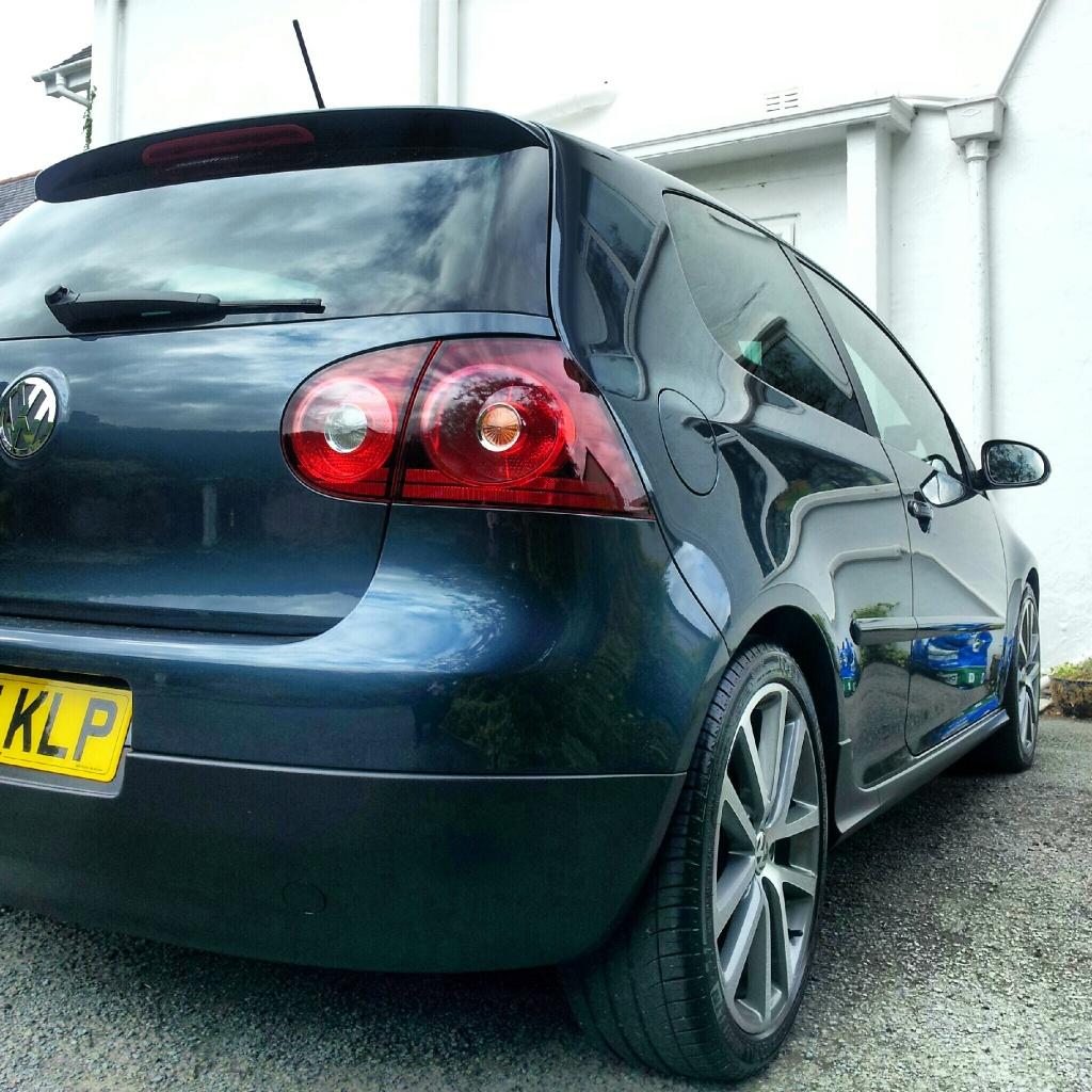

Another little update. Inters was a blast, I'm sure I met a couple of you on Saturday night - and made a tit out of myself too I'm sure!  :drinking:
This is how it looked for Inters;
GTi Sideskirts fitted. (Undecided on a colour code at the moment, so I went for the textured black ones!);
Fitted the bigger intake? foglight grills;
GTi grill installed. I have the originals, so I can swap over accordingly;
Hopefully looking into a GTi / Edition 30 rear valance colour coded next, H&R lowering springs and a GTi front splitter (again colour coded, save the centre piece).

Photos don't work for me.

Strange? I'll work something out. I can see them  :scared:

photos work for me--car looks excellent :notworthy:

Can see them now. Looking good mate  :happy2:

Looks great, graphite blue is certainly my preferred colour although I'm also a fan of shadow blue.
How easy was it to switch your GT front grills for the GTi grills? Is it just a straight swap? As I'm looking to do it the other way i.e. GTi to GT

Not difficult at all. You have two torx screws under the bonnet on the slam panel, two snap clips, and under your numberplate surround - there are two screws also. Pull it towards you and lift slightly. As for the foglight grills and lower grill, there's one screw on each fog grill - and pull towards you. They're quite tough, don't be shy. Hope this helps you buddy!

Looking very nice!  :happy2:
I love the alloys, what are these called ?

Theyre 18" Charleston alloys (opt. extra) Theyre also available on the Mk6s. VW have also made shadow versions of these (alongside the Monza II's).

Charlestons (...and Pescaras) = My Fave 18" OEM wheels  :drool:
Although Charlestons are mega bucks and like rocking hoss cack to find!

...and dont last all that long. I have water worming around my VW centre emblems already. Theyre only 4yrs old! With 36k on them :-(
