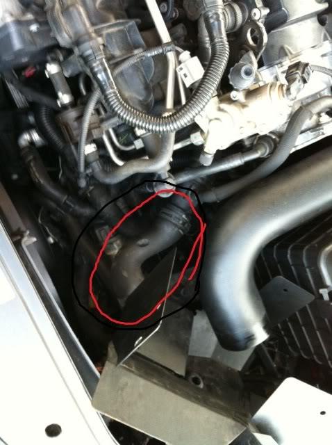

Had coolant warning light pop up on dash. After further investigating it looks like the sheild/box supplied with the k&n induction kit seems to have rubbed its way through a coolant pipe over last 5k miles (Well the bolt).
I work full time in week and VW shut by time i leave so going to try get a relative to pop in for me but would prefer to send them in with a part number.

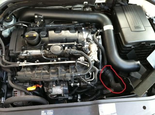

Its the part circled in the pictures. If anyone knows part number or able to find it out if they have access to the etka (if thats it) system.
Thanks in advance.

If its the top rad hose then it should be 1K0 121 101 BT - about  £9

Yeah pretty sure goes round n connects to rad then. Cheers will get one ordered.

I would also get him to take a copy of your pic as well to be sure you're getting the correct part.
