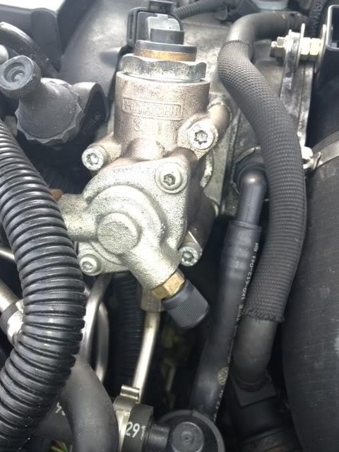

I'm buying a pump off of a forum member, but have learnt, that there is a cross over period, and that they are two types from 2005/2006.
Is mine pictured, the later version?

The pump is the same it's just the fuel lines in the bottom of the pump that are different. Yours is the later version without the banjo fixing by the looks of things.
