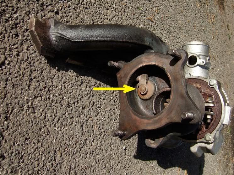

RedRobin's turbo was fine when he changed it, the problem was the exhaust housing had a crack in it causing a boost loss.
....It was a crack in the wastegate part of the cast manifold which is permanently fixed to the turbo so the whole assembly had to be changed.
It has always struck me as a bit of a design flaw by VW to fix the turbo permanently to the manifold.
