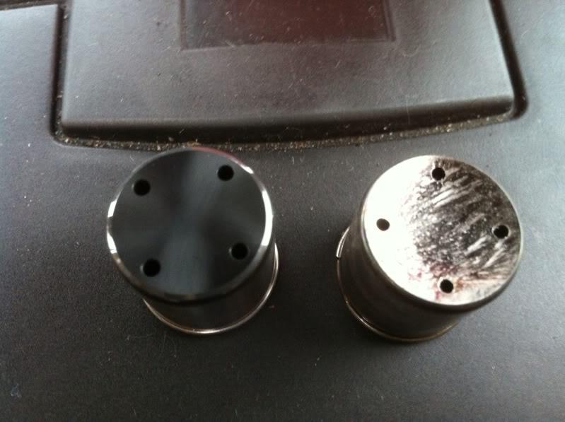

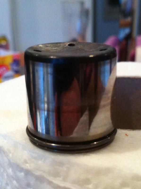

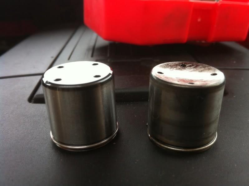

Well the car has slowly gotten worse and going into limp mode more, then on weds night the engine management light came on and stayed on!
So I went and got a new cam follower today and changed it and I think i have caught it just in time :surprised:
I also changed the seal on the fuel pump just to be safe too, what a rip off that is! £10 for a bloody O ring,
I can't feel any wear to the cam lobe Either luckily  :happy2:
On the test drive after the engine light went straight out and the car is driving faultless now  :laugh: soo much quicker now than when we 1st got it  :jumpmove:

Wow just caught the cam follower in time.  :smiley:

Yeah glad it's sorted and I sorted via info from this forum :happy2:
Yep think looking at it it's the original it's done  101k  :confused:

That cam follower  :surprised:
