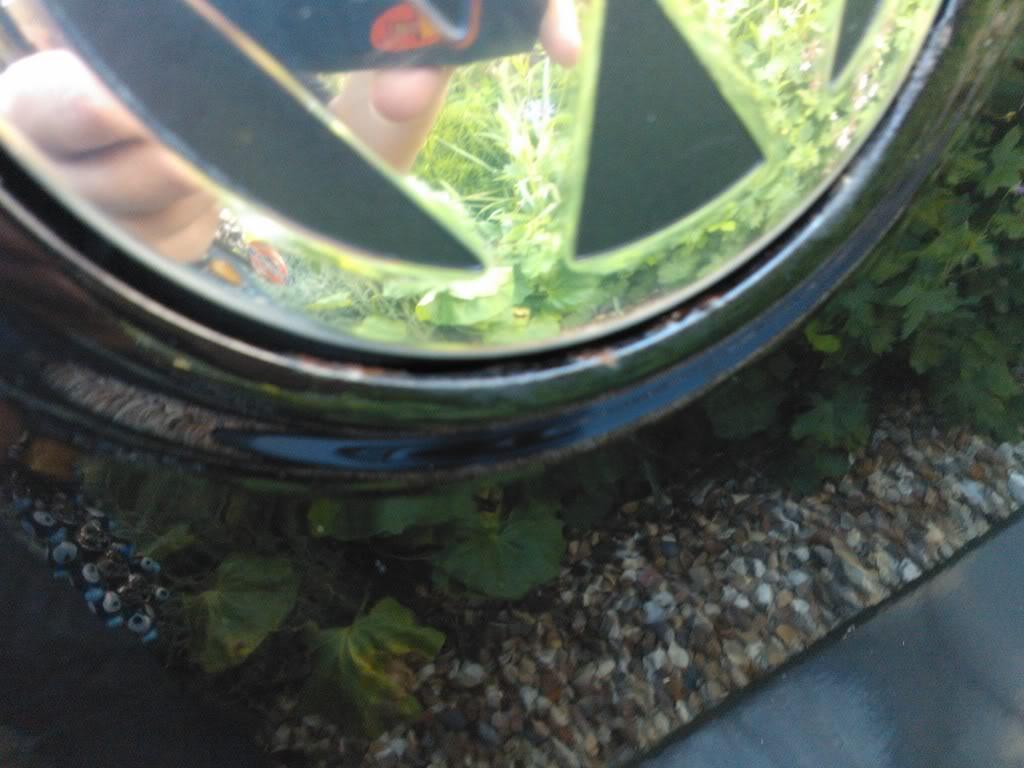

Just been to Chelmsford VW and the chap from the bodyshop was more than helpful. He knew exactly what I was on about, didn't argue and when I mentioned the sills had no problems including them in the "good will gesture" claim. He took pictures and paint depths of wings and sills. He said he had a few on the go at the moment and doesn't mind doing them. He's processing it tomorrow and then its a 4 - 14 day wait for confirmation from VW UK and then drop it to them for the work to be carried out with a hire car if required. He also said I had gone at the right time as VW are using the neglect get out with some.
So fingers crossed
Did they mention what 'neglect' means? Is it leaving it too long before reporting it, or just having a generally scruffy looking car?

Basically leaving it so you can see the rust on the outer of the wing not just bubbled paint work. My car had the paint bubbling on the outer of the arch and the underneath had just started to go. The rust on the sill you could see on the off side but not on the nearside so hoping they do the near and will investigate further when they strip it down. My car was filthy when I saw them today but it has been constantly raining. Basically as soon as you notice it go and see them

Ive had mine inspected , just waiting to hear back now , its just bubbling paint just now and you have to be closer than about 3 feet to notice it at all on the drivers side , however , on the passenger side , one of the rust bubbles popped when I was drying the car and a small bit of paint flaked off , and it was like that when I got the pics taken , I just hope that doesnt go against me! (has been crudely covered with a touch up pen for now)

It shouldnt do, as you say its not noticeable unless your close and you've had one bit flake and you've gone in for the claim instead of leaving it so there's more rust than paint so it should be fine  :happy2:

They took a general pic of the car , one of each wheelarch , one from underneath each wheelarch looking up and one of the milage on the dash (49600) , also took paint depths which from memory were either 100 or 110 each side (im a nosy get and was looking at the digital gauge!)
