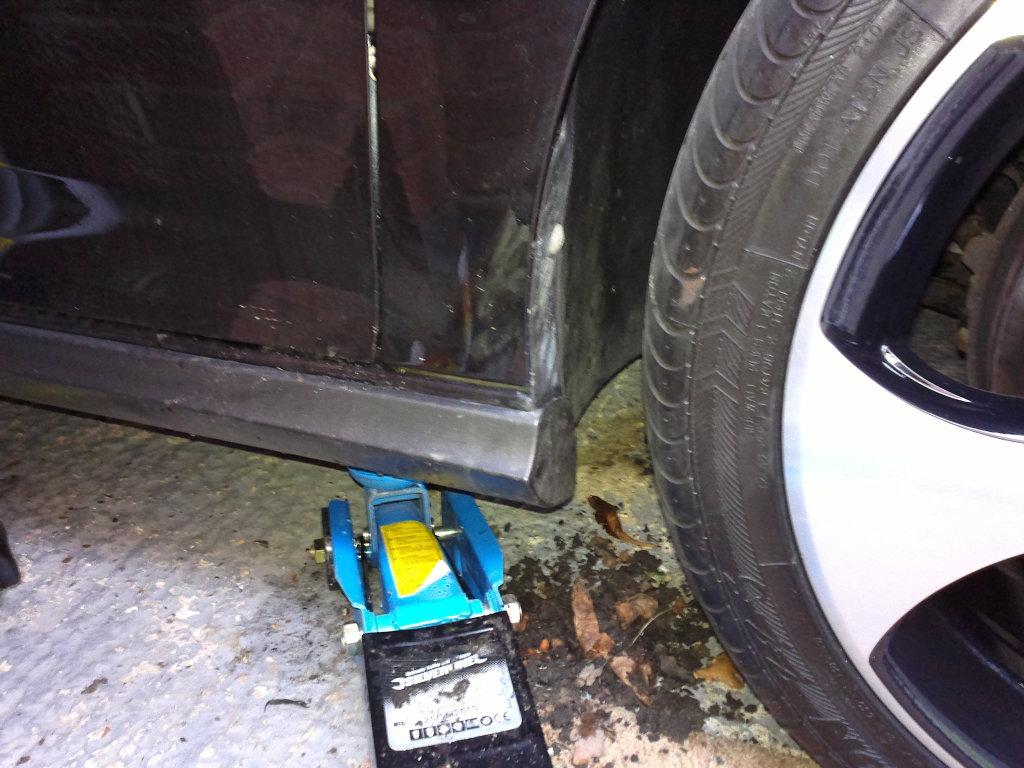

Re: Front wing rust warranty success!!
« Reply #87 on: July 06, 2012, 06:30:00 pm »
A friend with a Mk4 R32 recently found plants growing in his wheel arches and he regularly cleans his car.
I can vouch for the plants growing, I took the front arch liners out of mine at the weekend and you can see in the photo how much mud and leaves were trapped behind the liner down the bottom near the sill! (another area people are having rust problems with)
I checked out the inside of my wings and the area where all the mud had collected (06 plate) and there's no sign of any rust  :happy2:
Good idea to do this yearly!  What surprised me was the passenger side had hardly any mud trapped atall.
