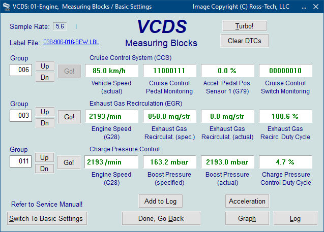

Do you know how to bring measuring blocks up?
Re: how do i check the dsg torque limiter with vagcom?
« Reply #3 on: June 12, 2012, 04:48:20 pm »
http://www.ross-tech.com/vcds/tour/m-blocks.html
You will need to scroll through the blocks to find the appropriate one.

The correct block is in the 120's. I cant remember exactly. Try 121 and 125 first.
With the block open go for a 3rd gear pull and see it it says the limiter is engaged.
