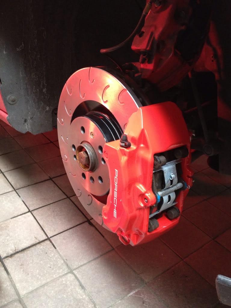

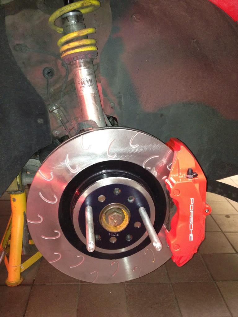

Re: Brembo BBK
« Reply #9 on: June 20, 2012, 10:43:54 pm »
During fitting
