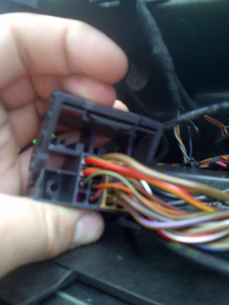

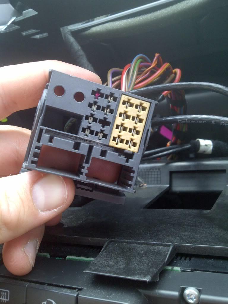

Alright guys took out a bodged up sony ericcson hands free kit that the previos owner put in today and theres not a lot of wiring that plugs in the back of my stereo, just wondering if theres enough for when i want to put an rns 510 in?
Thanks
Neil

Thanks for the link , do i need multi pin conenctor (5) ? As there is alot for video ? When i install a rns 510 i only want it for the sat nav and radio not fussed about films etc?
Any help would be great
Thanks
Neil

Your connector is standard Mate. It will fit into RNS without problems. Don't worry about Multi pin connector (5). It is used for Video in and out, i.e. reversing camera etc. And You can still watch a DVD on your RNS.
