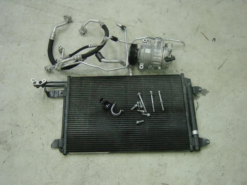

I have a picture from Jonnyc's thread so know what needs to come off.

Looks like this little lot.

Hi we removed Johns Herdys A/C & Mikes plenty of others too
The belt you need you can get from Euro-C-Parts
Their no : 202660555
Remember to seal the a/c expansion block up in the bulkhead so moisture cant get in
Hope this helps Jnr :happy2:
