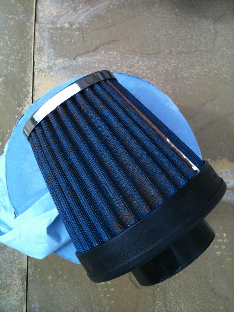

I take back what I said about them being "unlikely" to be fitted wrong way round....cos they are!  :fighting: :stupid:
Took the 2 canisters off just now to have a look and switch round. As soon as I got them off I thought hmmm.
Think I will just order 2 new cans now. Easy to remove tho. Side one has no crap so didn't take filter out, but front one looks bit worse for wear.

Ask Forge to supply you 2 new filters free of charge - It's their fault that they originally instructed the wrong orientation. John Withers is a helpful person to speak to.
Is their any sign of rust/corrosion on the metal gauze?

There is on the front filter....
