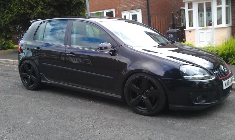

Here are how my JOMs sat.
On 17s with 225/45 tyres.
rear adjusters still in, about 2/3rds of the way down.
Fronts at lowest possible setting.
Here's my car on Eibach Sportlines
Basically same angle.
Same wheels
Same tyre sizes.
« Last Edit: October 31, 2013, 09:14:00 pm by xjay1337 »

would the gti have thicker anti-roll bars than the 1.4?. Your jom's sit much much lower than mine did. The first pic is on 17" wheels, not sure of the tyre profile though, im pretty sure this was before i cut the spring at the back but the fronts were about 90% low and the backs were with the adjusters out.
2nd pic is with the spring slightly cut but on 18" wheels, not sure with 35 or 40 profile though
3rd pic is my gti now on eibachs.
Not the best comparison pics i suppose. They surely have changed the design at some point if mine where that much different to yours and so much stiffer, mabie they just sofened the springs up on the joms a little bit? im sure you've figured i go for the black car/ black wheel idea....
