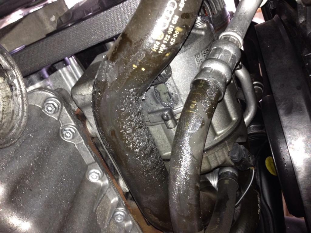

Not good news for me....  :sad1:
Can't believe my compressor would literally blow a hole in its casing  :surprised:
I've seen this before I would guess that some Guys don't refill the oil when the cars are gassed at the A/C shop
The compressor is a little engine really it needs oil and servicing, if it's starved then this happens
Remember this things runs at engine speed all the time they are clutchless by design
