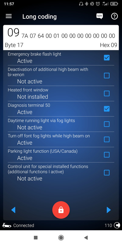

Hi, this is the menu I have under 09 central electronics - Byte 17
Have also scrolled through but can't see anything relating to the command I posted above..
Anyone know a way around this without using vcds?

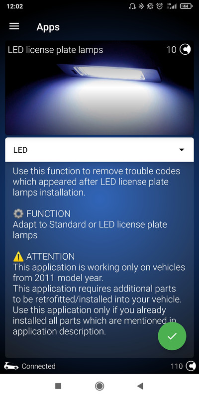

Edit: Just found this under apps, but says it for 2011 onwards vehicles :-(

Offline LC5F
  • -Receive: 80
  • Posts: 1110
Re: LED bulbs causing dash light
« Reply #5 on: September 25, 2021, 12:24:51 pm »
I installed Mk7 LED's recently, despite switching of the check number plates it still was throwing up occasional error - but MOT is looming, law of sod an error will pop up in the test.
Just tried looking for:
09 Central Electronics -> Byte 17, Bit 7
My 2006 Golf stops at Bit 6
To be absolutely sure I am going to revert to filament bulbs in the original bulb holders.
