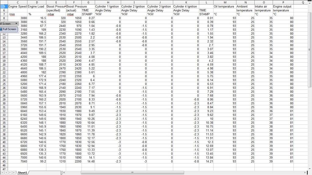

« Reply #15 on: August 13, 2012, 07:36:29 am »
This is my stage 2 with 649 settings.

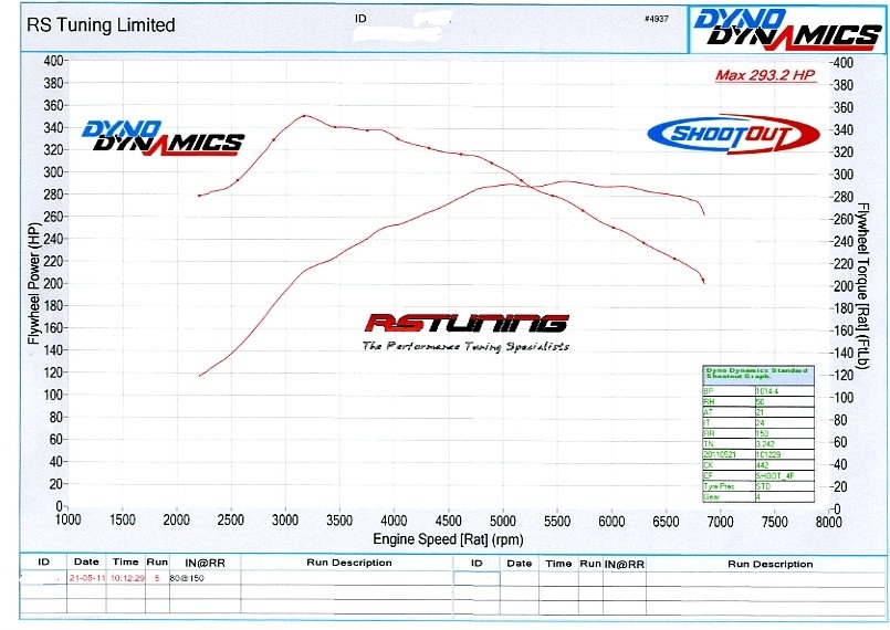

« Reply #16 on: August 13, 2012, 11:26:44 am »
This was the best setting after many logs. Timing pull almost zero and everything matches with requested.
I run 98 ron pump gas. No wmi.
How much boost is B9? B7 for my car is around 23psi. If you run your car at fuel 9, is that a lean fuel setting for you or rich? I'm confused, are all cars different they way they respond to settings?
Sorry for all the questions. I'm really intrigued with your settings and results.

« Reply #19 on: August 13, 2012, 02:25:14 pm »
I wonder why both previous RR graphs seem devoid of any torque spike ...

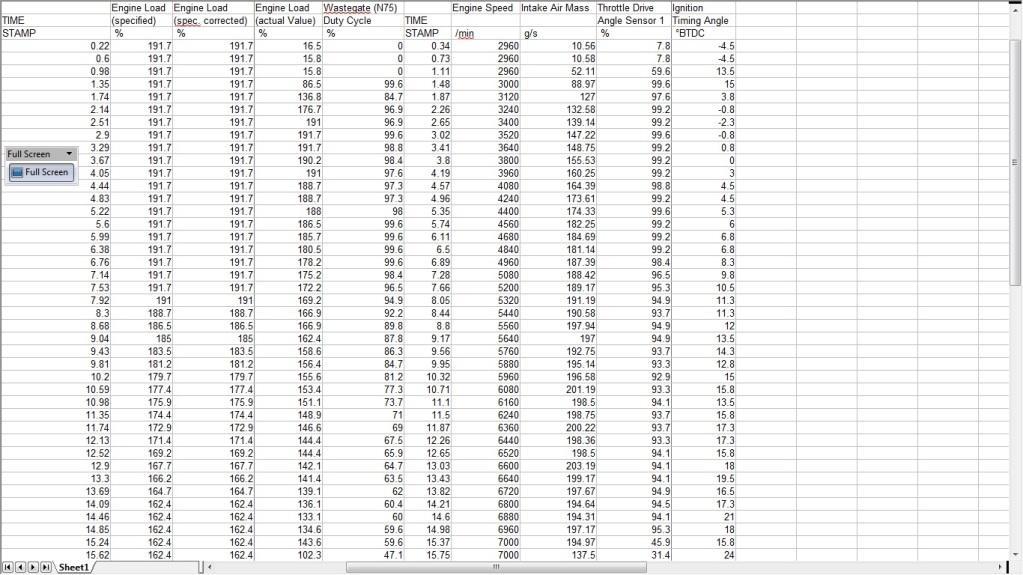

« Reply #20 on: August 13, 2012, 04:57:43 pm »
This is one of my logs with 959

« Reply #21 on: August 15, 2012, 04:54:36 am »
Excuse my ignorance but how can you tell with these values whether you are pulling timing?
Where's knock correction?

« Reply #22 on: August 15, 2012, 10:26:43 am »
He hasn't shown any block 020 logging so there is no way to say what his CFs are from those logs.

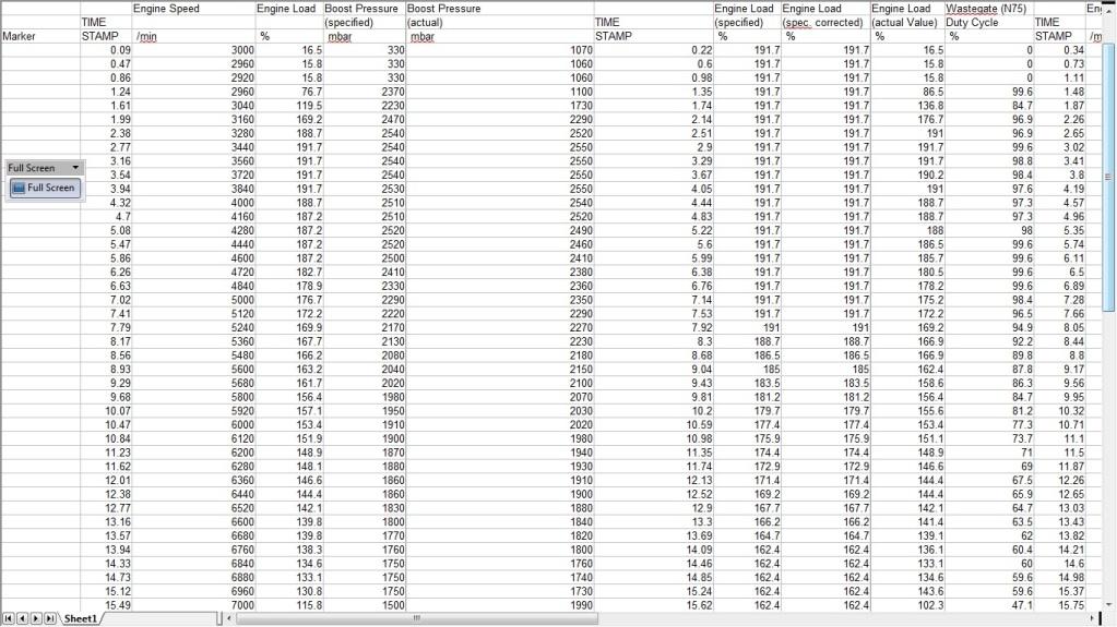

Re: MKV K03 advice
« Reply #23 on: August 15, 2012, 03:11:14 pm »
On the same 959 setting.

« Reply #24 on: August 16, 2012, 11:42:30 pm »
Thanks. That's what I was talking about. Great logs. Your car is a mystery. Glad it's working out for you. I must have a boost leak because my actual to specified boost is a lower. 15-20hp low who knows. Bloody cars!
