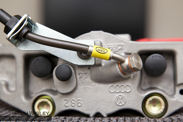

THe fronts should have 2 plastic grommets... yours appear to only have one!  :confused:

Thats strange :S Also do I remove the hard line off the back of the caliper to fit these ? Don't wanna start job and realise nothing fits :(

The fronts.. yes. Take off the hard lines.
R32 Caliplers HEL Hoses by Rich Wigley, on Flickr
The terminating banjo connector should also be angled, and its doesnt look like yours are.

Mine is just straight :S not looking good so far lol cheers rich

Call them tomorrow and raise the issues i have mentioned above.
Only one plastic grommet
Straight banjo (should be angled)
