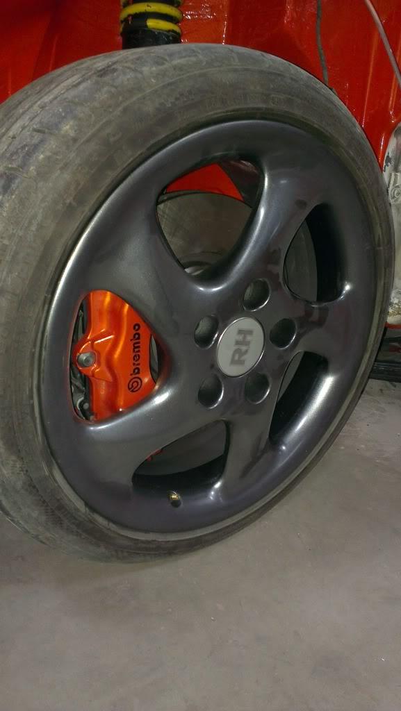

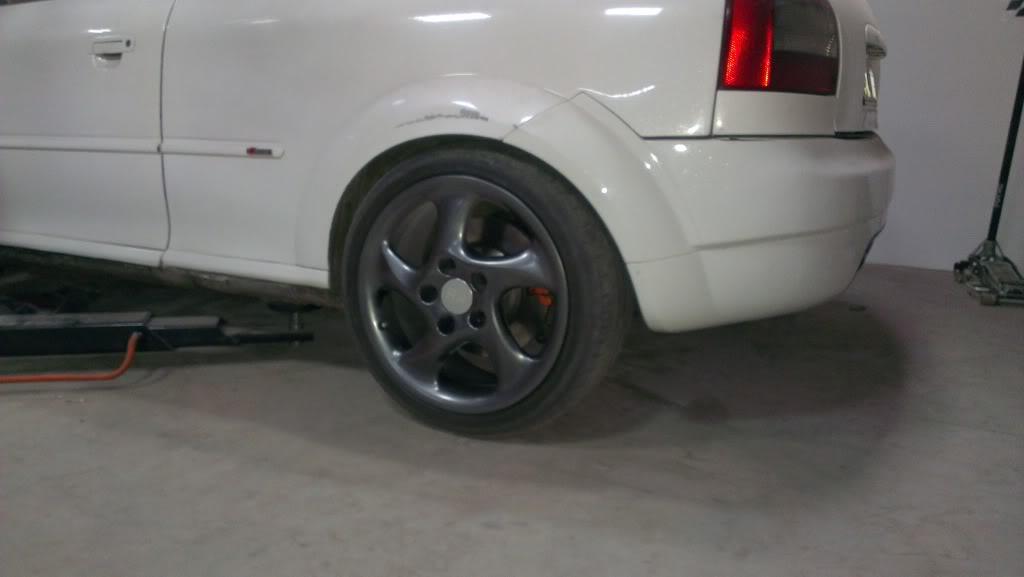

Wheels painted

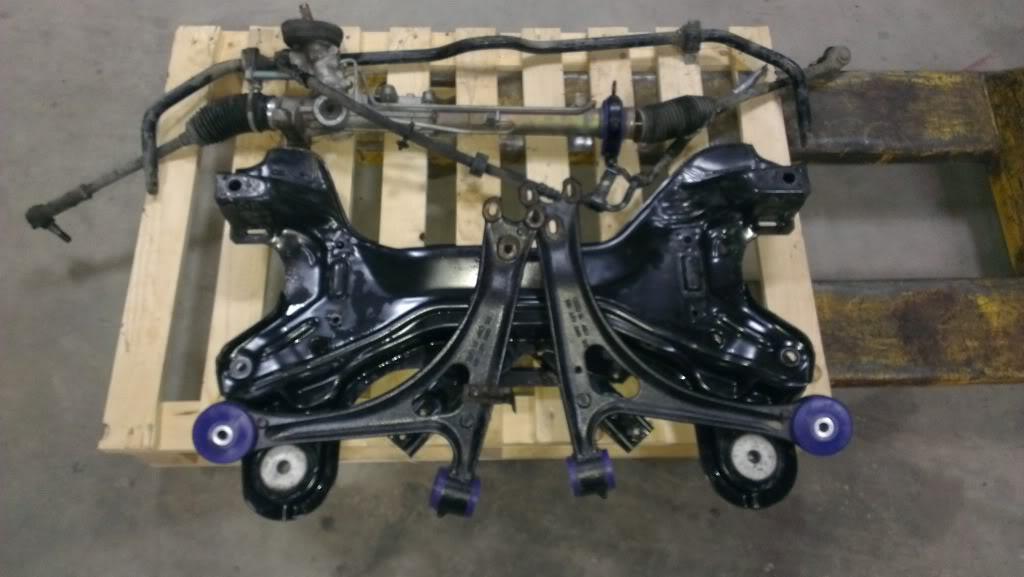

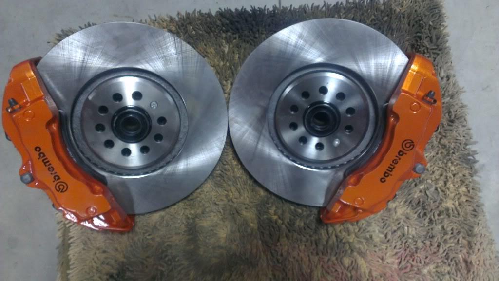

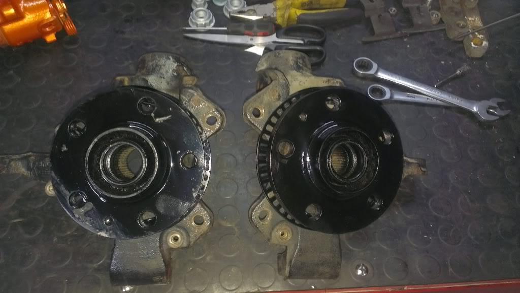

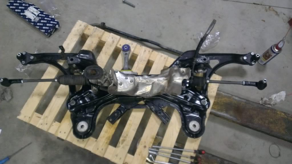

front subframe out dissembled, washed, powerflex'd and assembled with new parts
Wheels got tires (continental CS3 225/40)

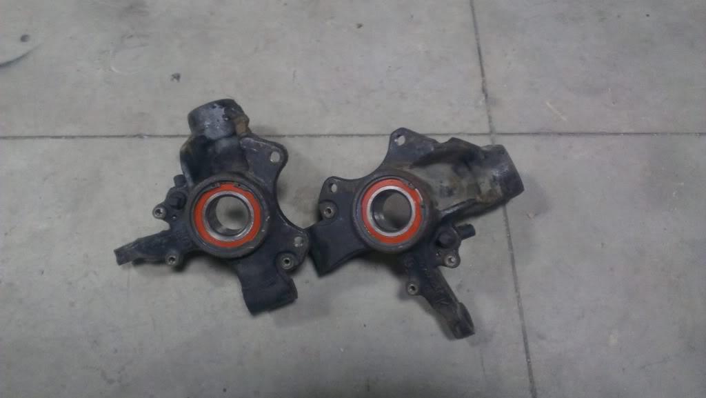

new bearings

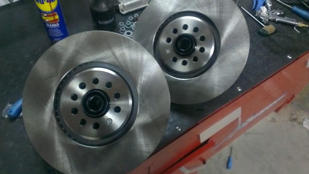

new discs
and ...

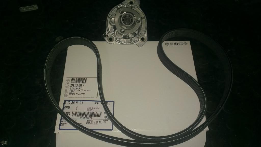

new water pump and belt for the engine
and a good clean up of the engine
I'm now working on the rear subframe ;)

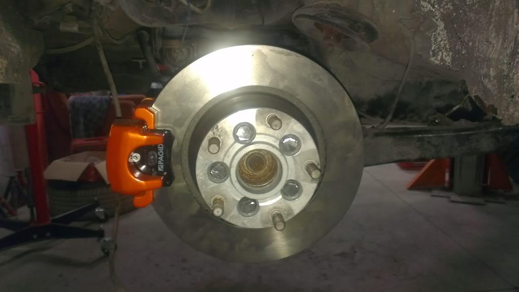

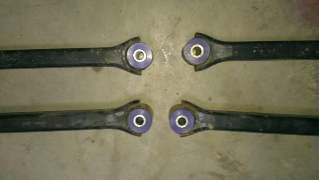

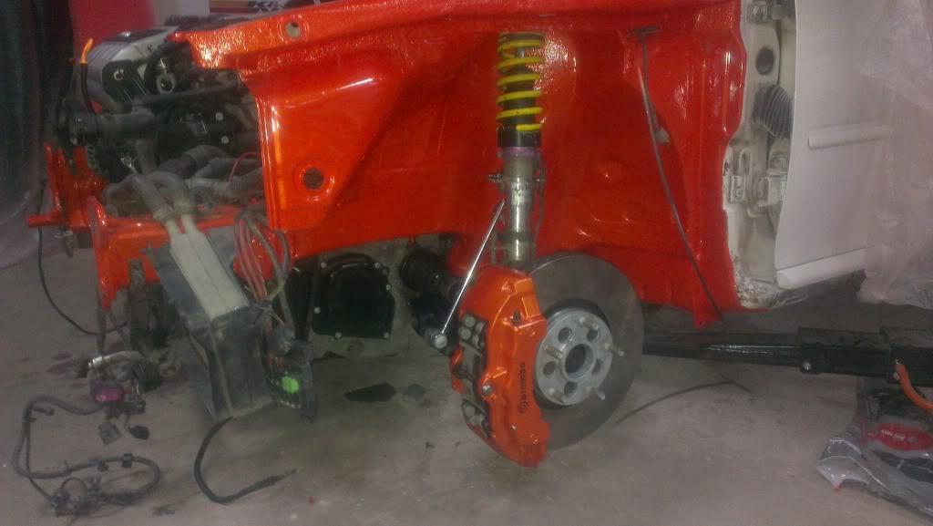

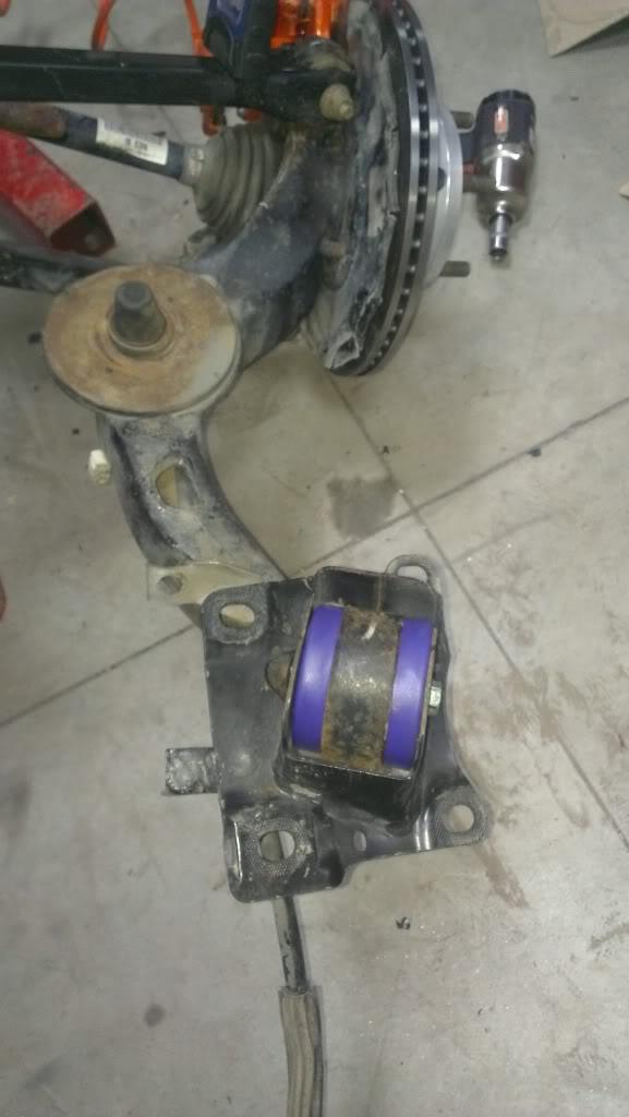

Powerflex on the rear subframe

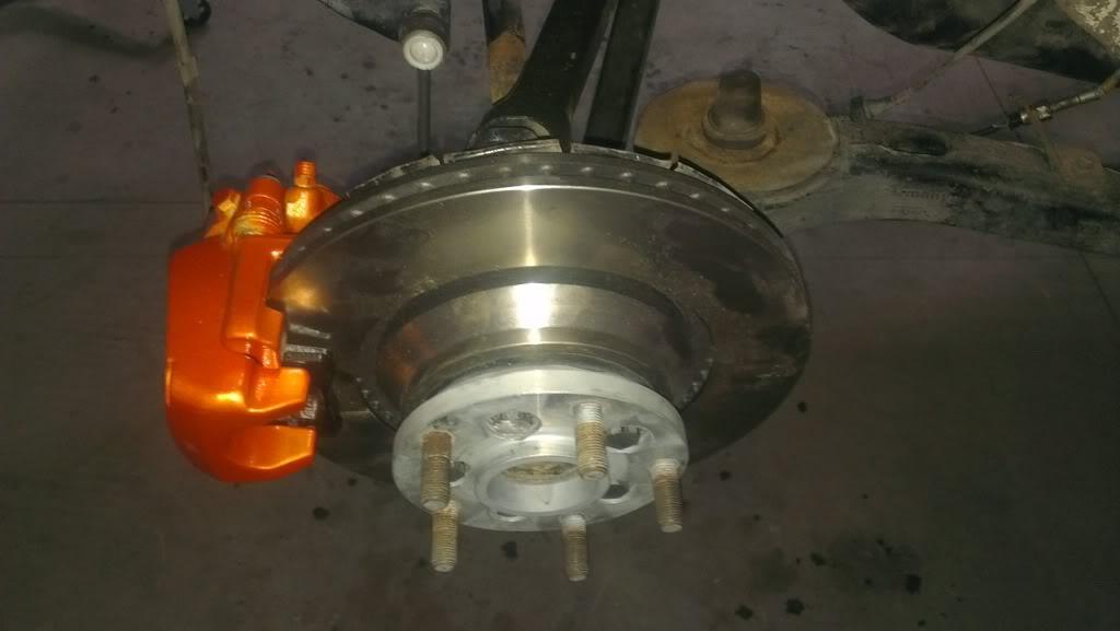

rear subframe with new discs and pads
the engine and gearbox came together again

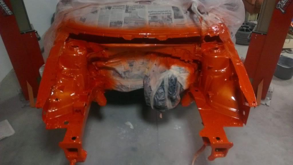

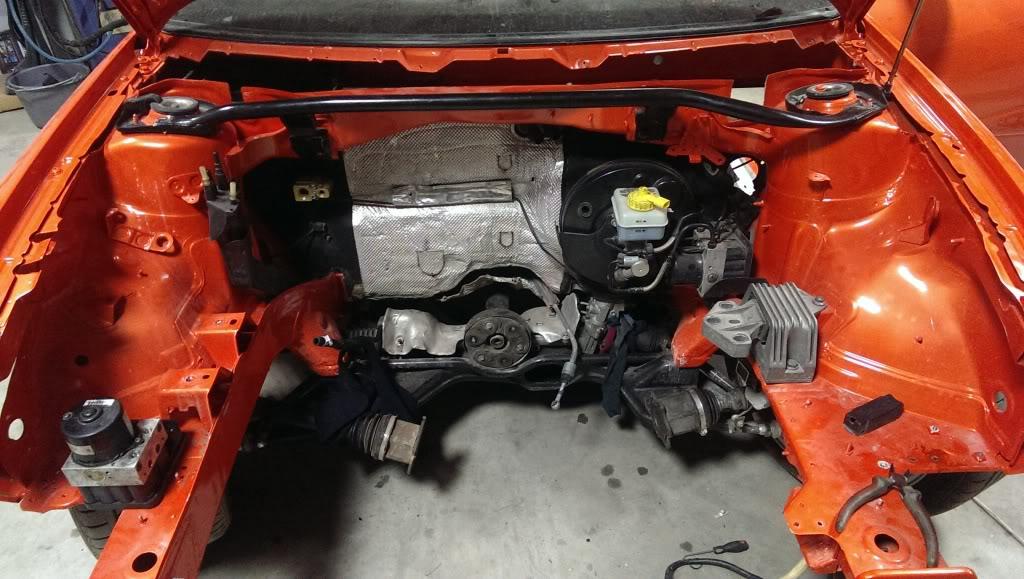

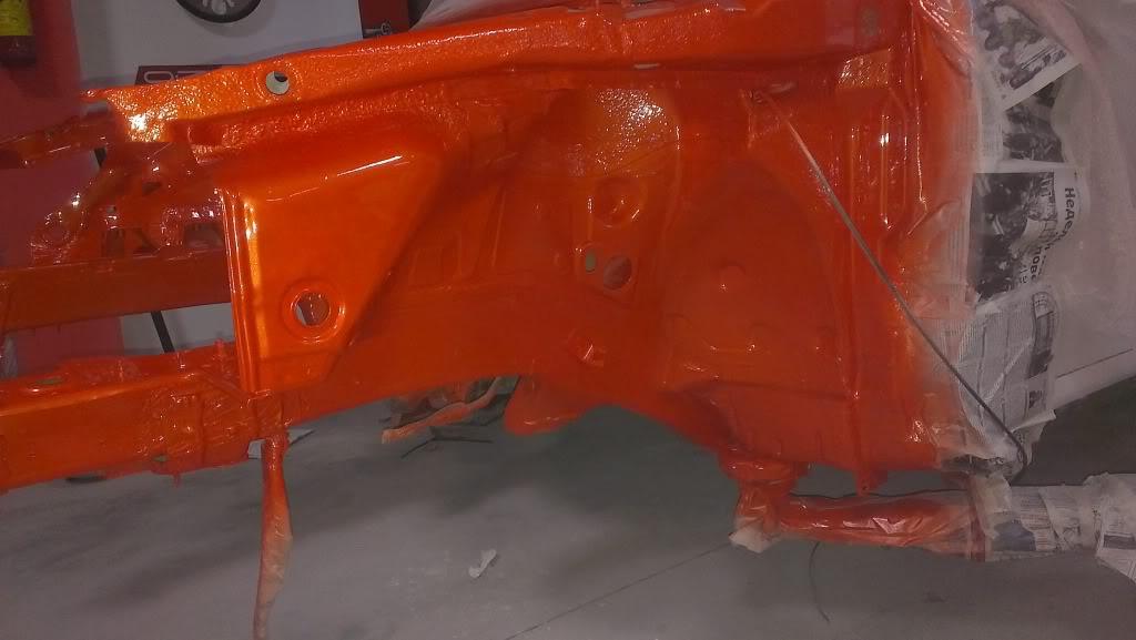

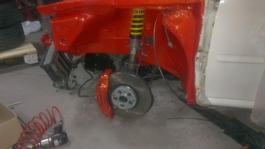

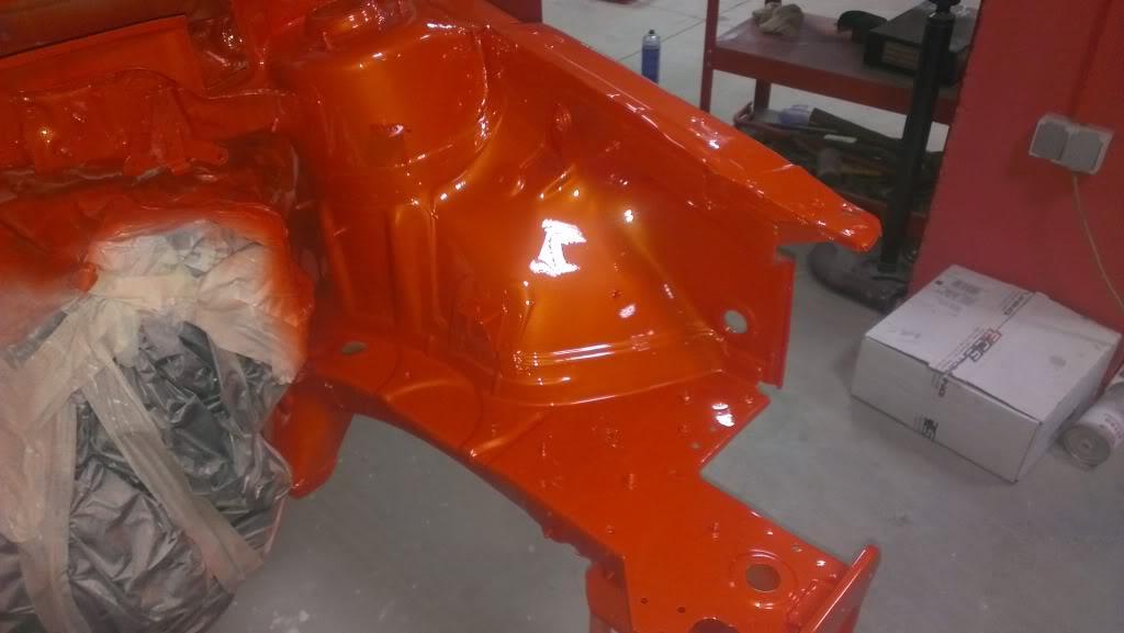

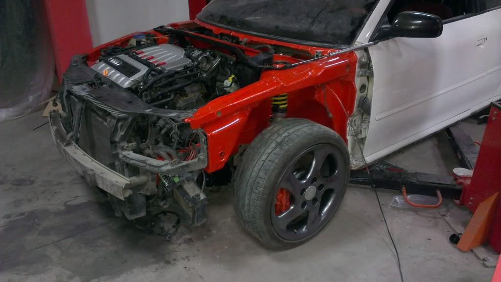

the engine bay in filler and ready for paint
painted

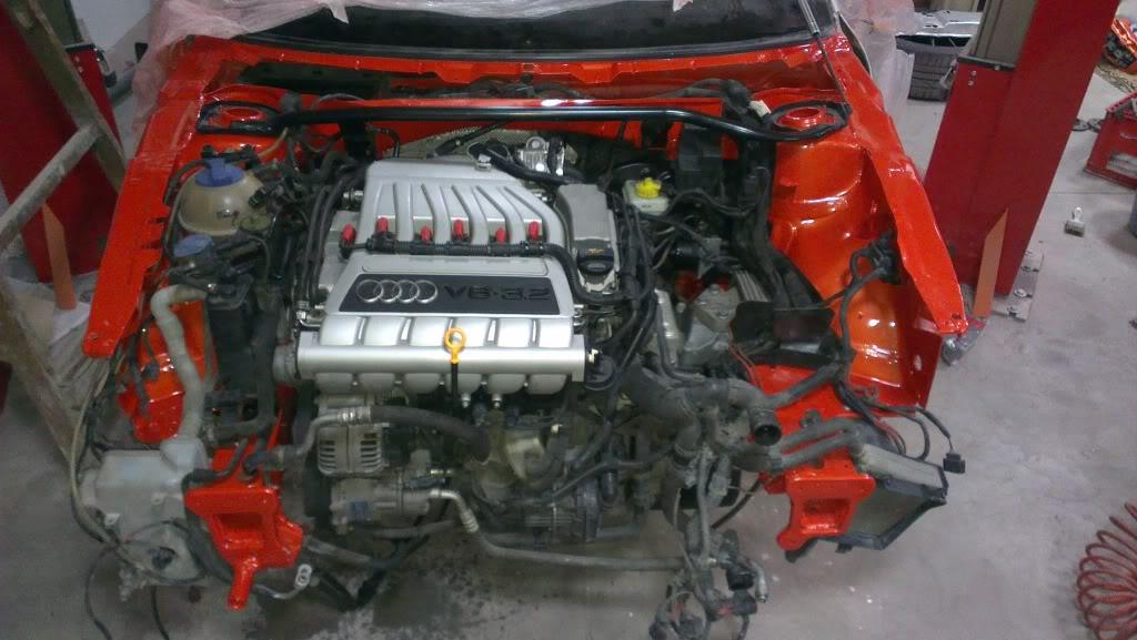

engine is back where it should be
front subframe complete
and the tires are on   :rolleye:

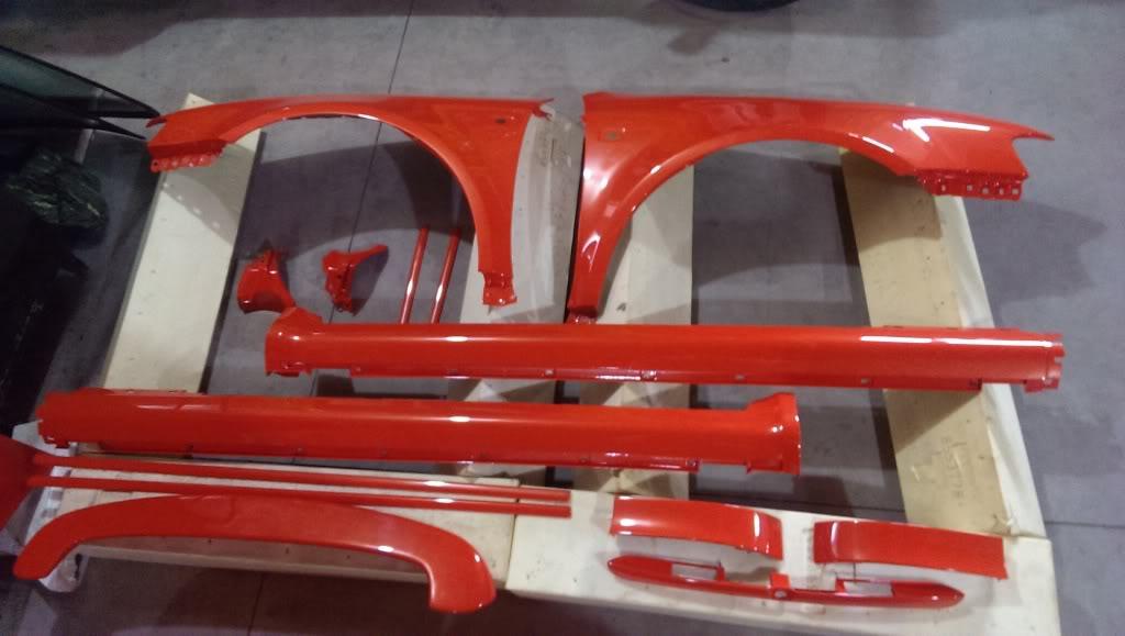

« Reply #20 on: April 20, 2013, 08:44:14 pm »
Finally !!!!!

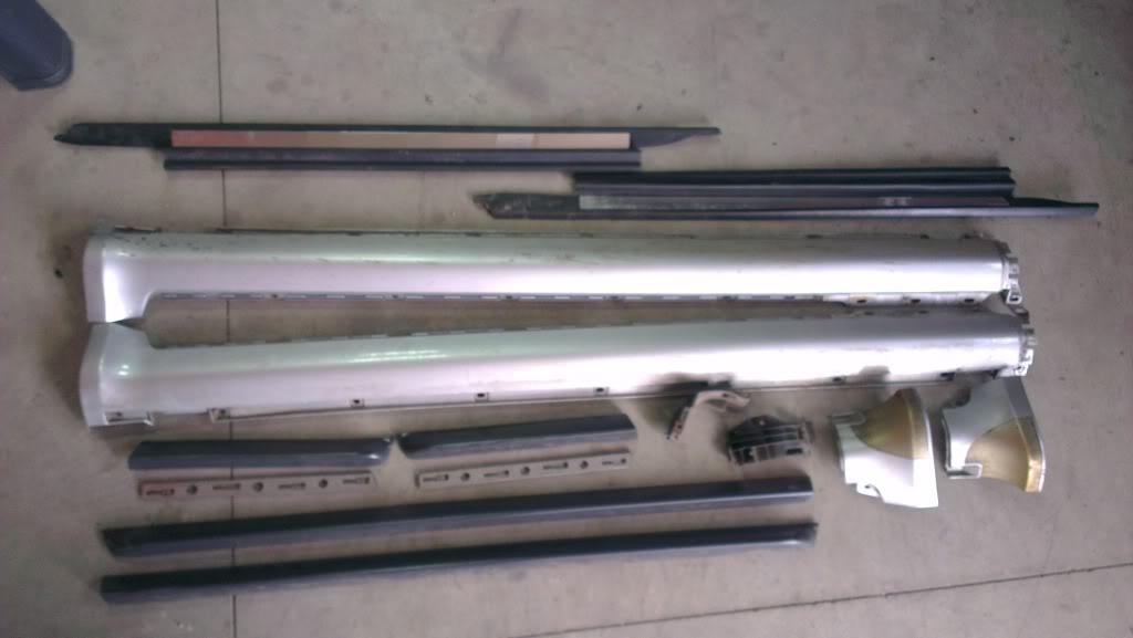

Arrived some of the ordered parts

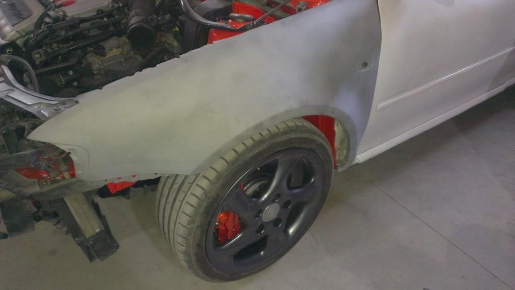

Audi S3 wings (they were sandblasted right away )
and in primer
Audi S3 side skirts

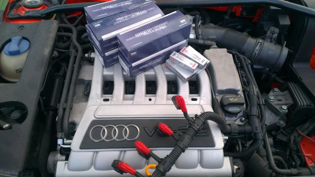

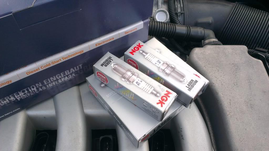

NGK spark plugs and I decided to change them with the pencil coils

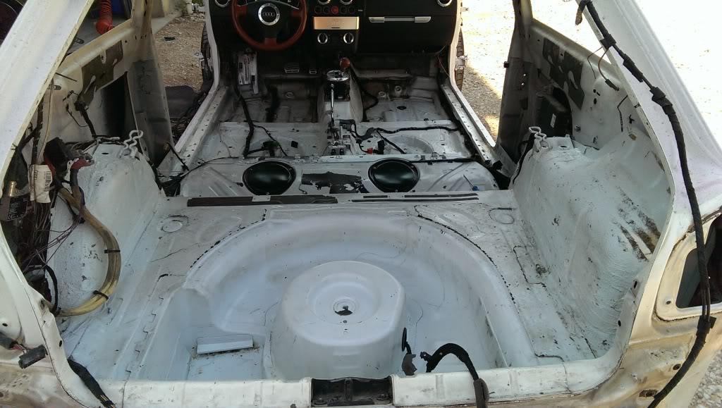

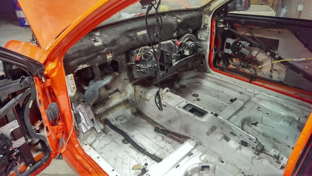

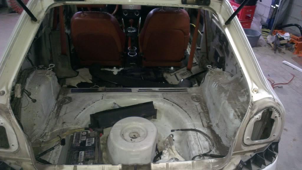

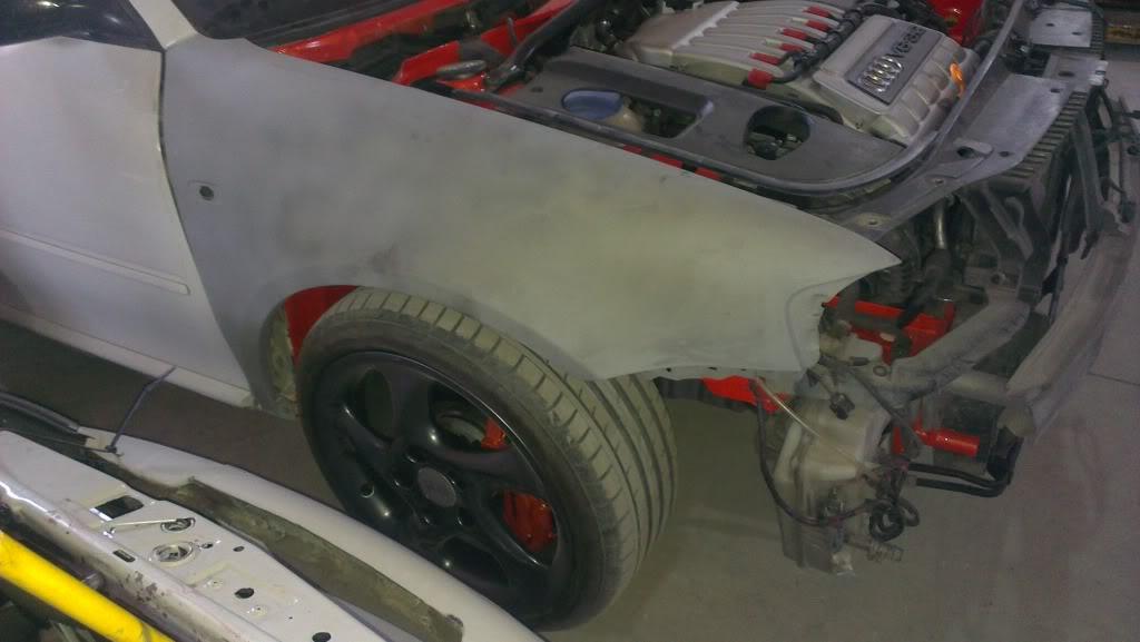

the car is striped and ready to go to the paint shop

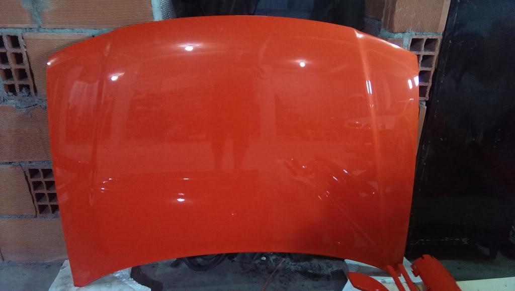

« Reply #22 on: July 24, 2013, 01:03:03 am »

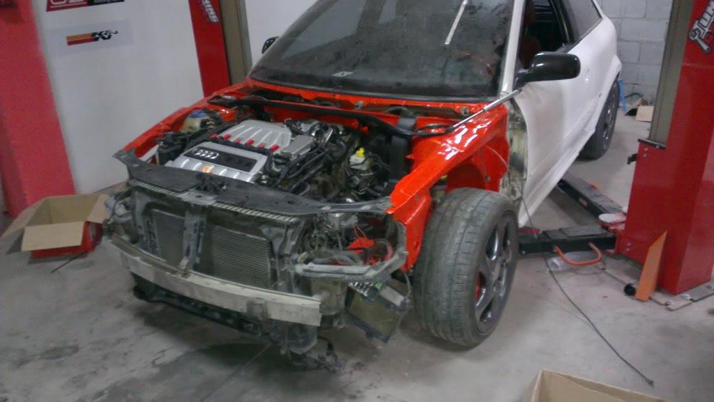

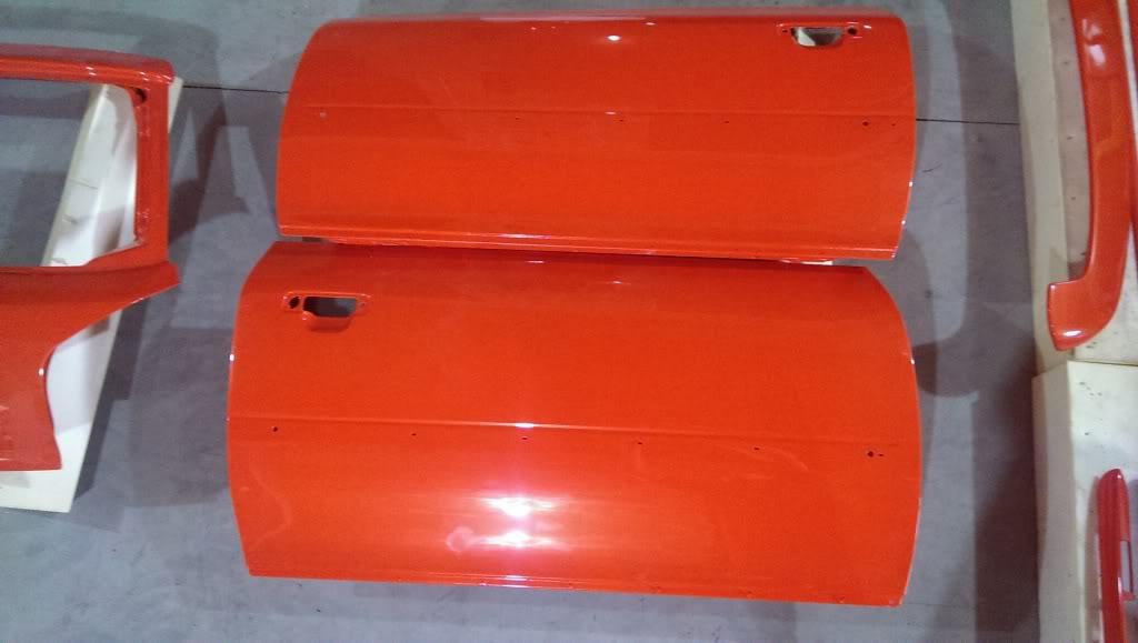

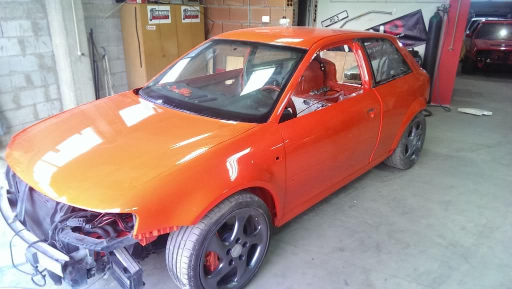

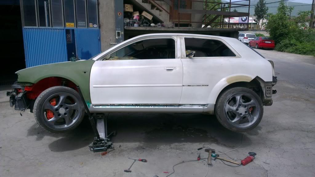

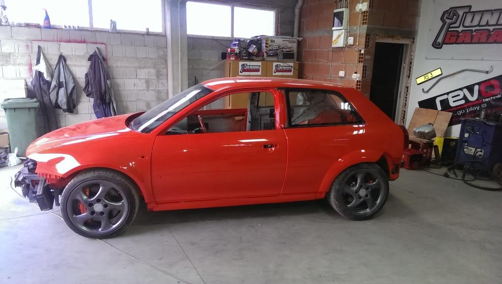

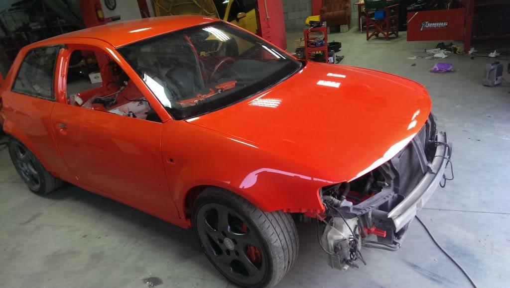

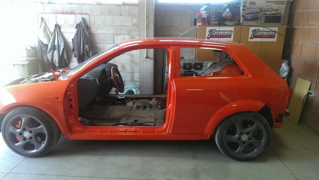

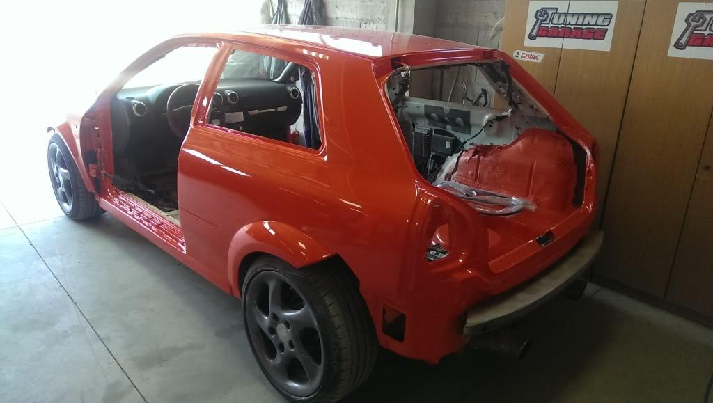

OK the car was taken to the paint shop and ...
Cheers  :drinking:
« Last Edit: July 24, 2013, 01:04:54 am by 2fast4you »
Offline 2fast4you
  • Posts: 153
  • Some drive to work... I work to drive!
Re: Audi A3 8L 3.2 V6 DSG Quattro

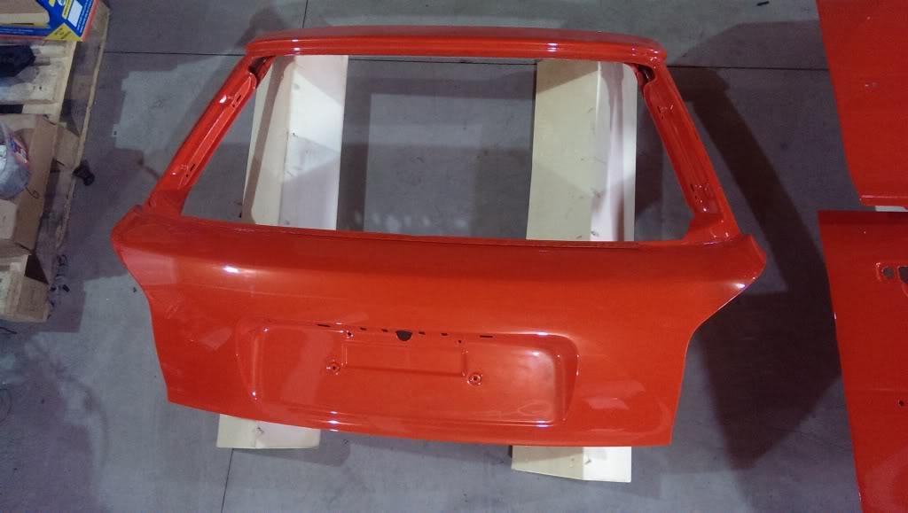

« Reply #23 on: October 12, 2013, 11:53:53 am »

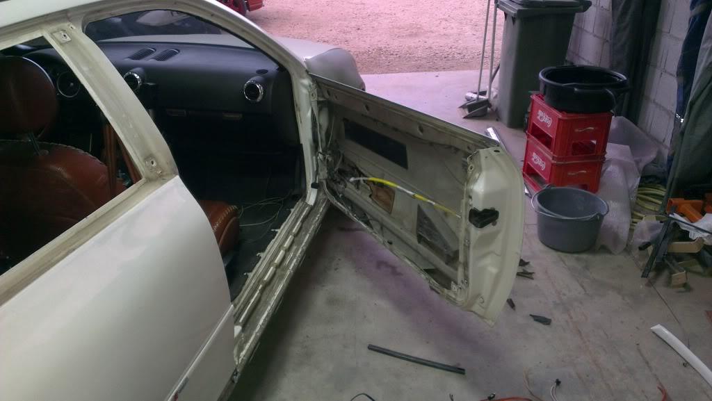

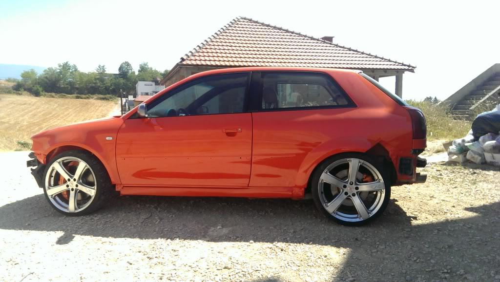

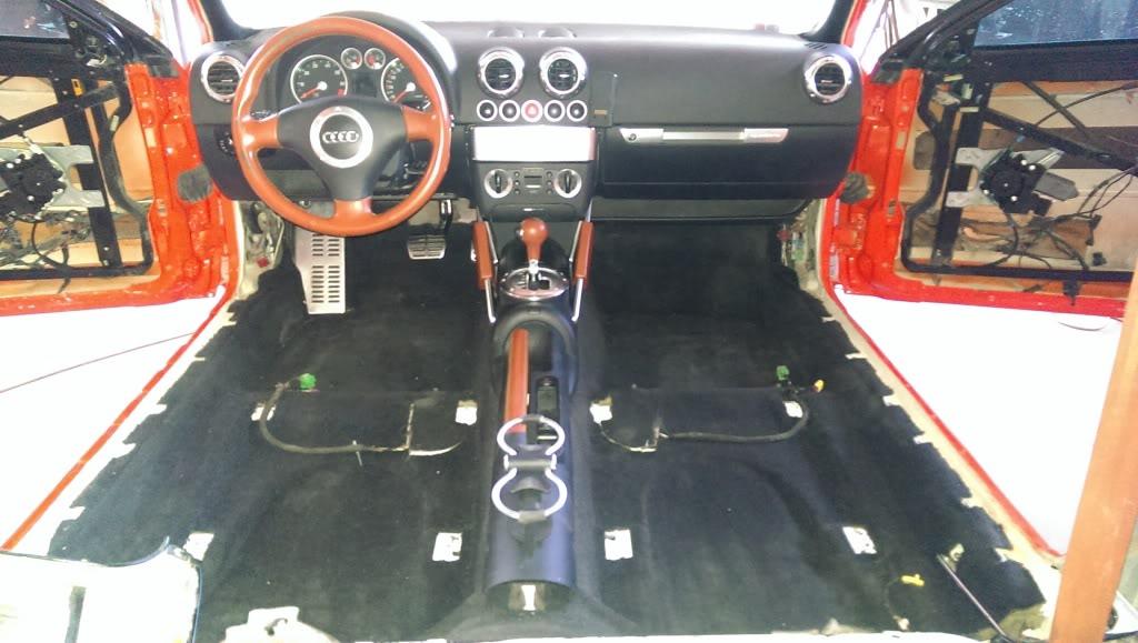

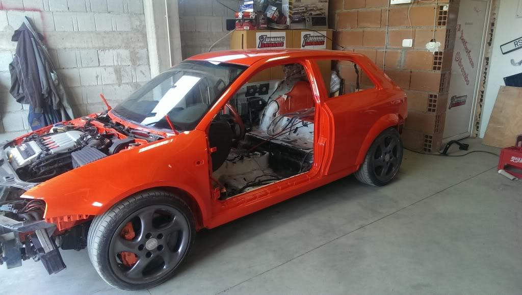

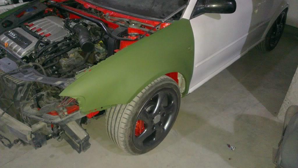

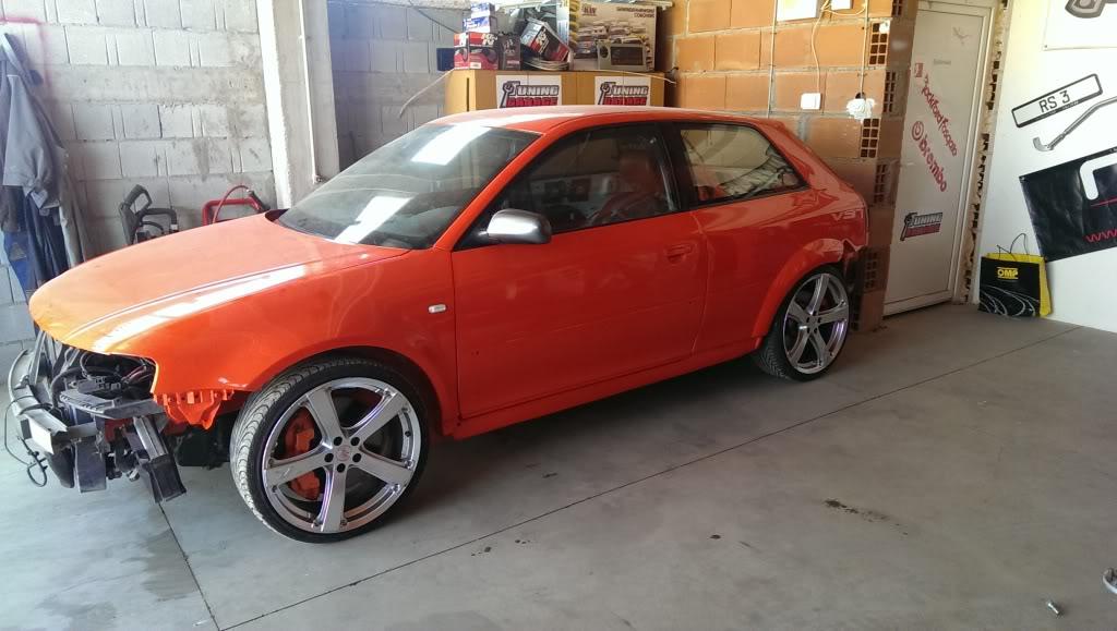

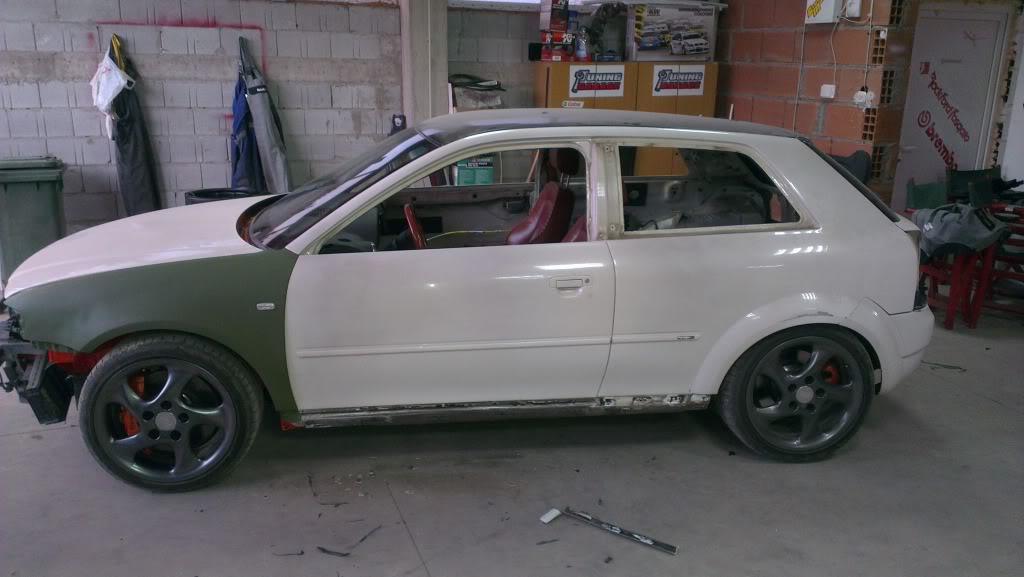

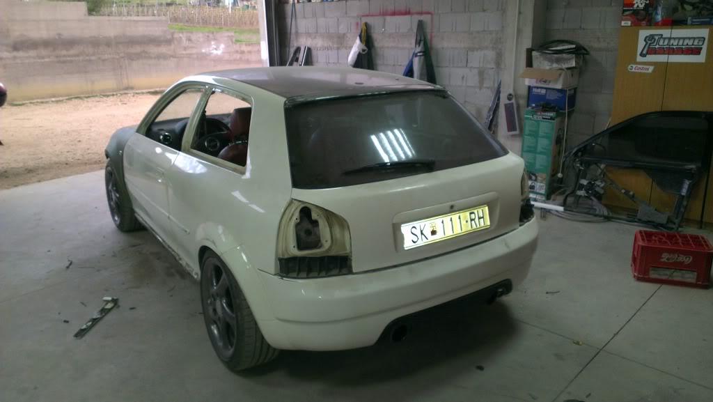

The car has been partialy assembled

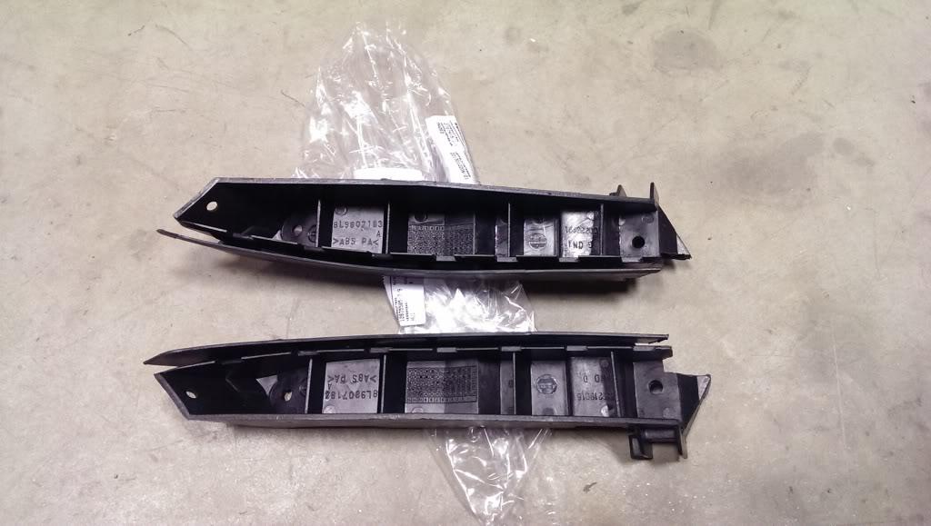

front bumper gudes

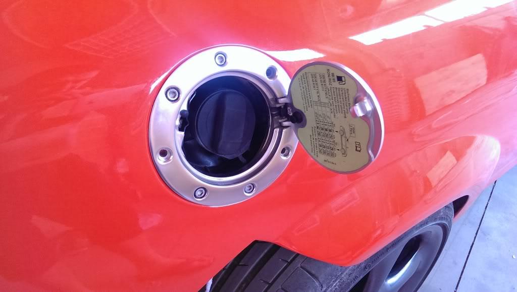

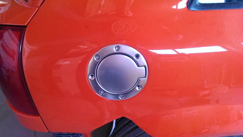

New TT fuel cap

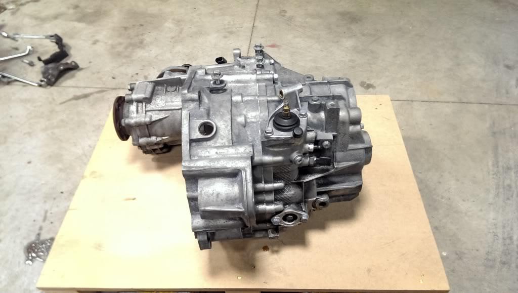

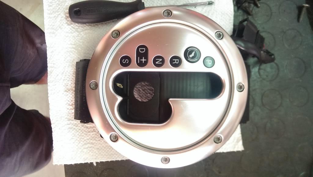

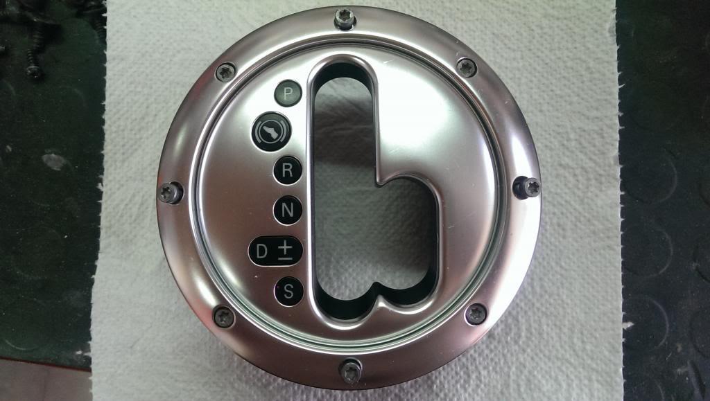

disassembled cleaned and assembled the DSG shift mechanism

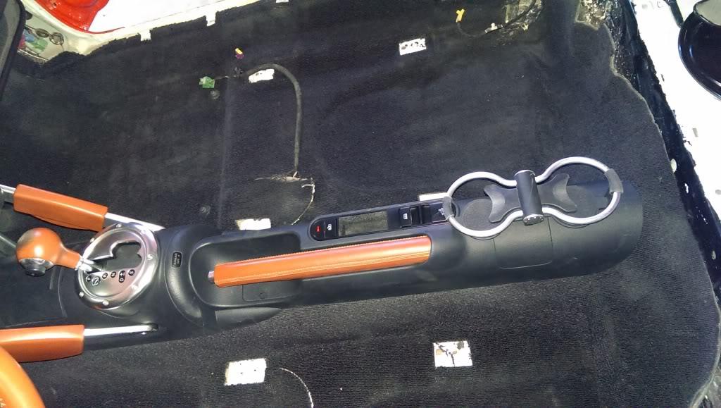

the enterior has been partially assembled

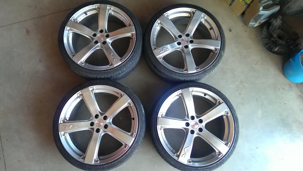

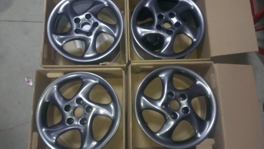

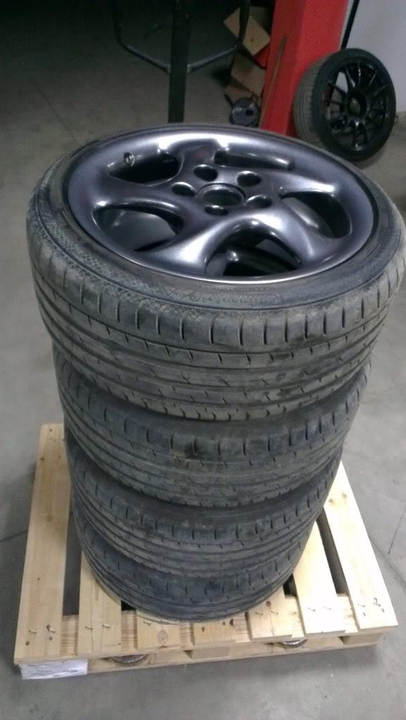

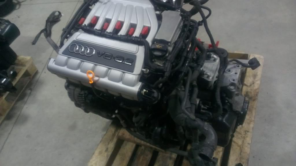

bought 19" wheels for my Audi just to sell them later  :grin:

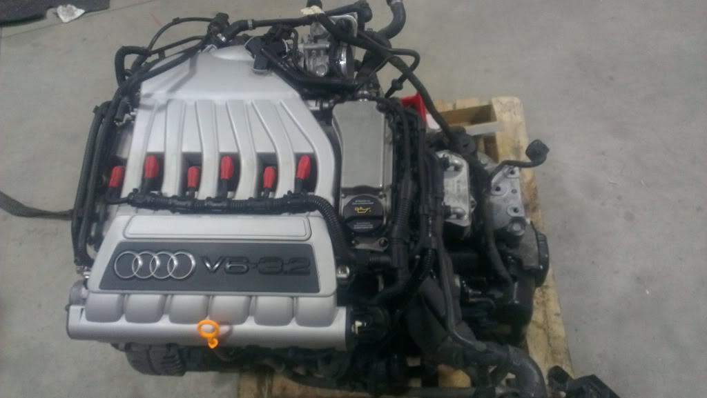

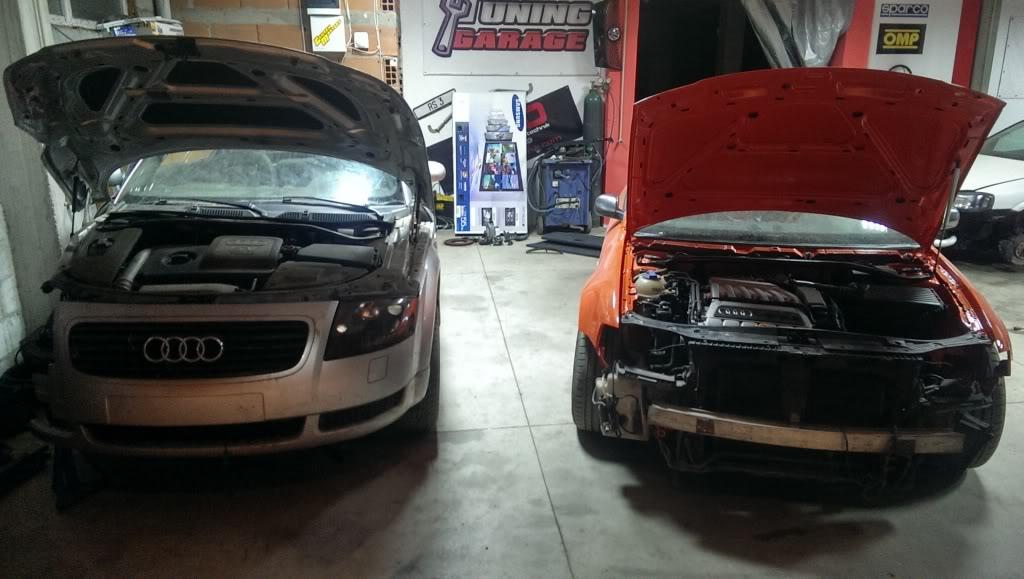

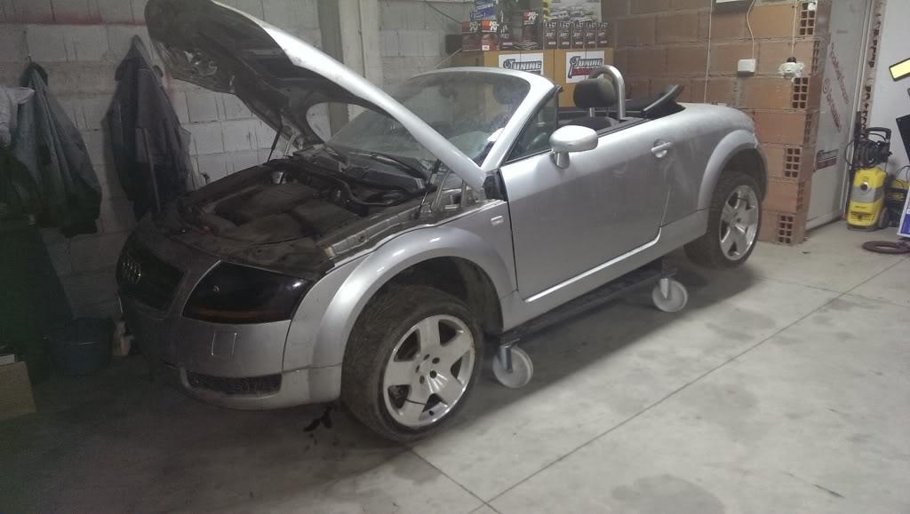

but then bought this: Audi TT 225 Quattro and everything changed  :P
so next thing a SWAP!!!

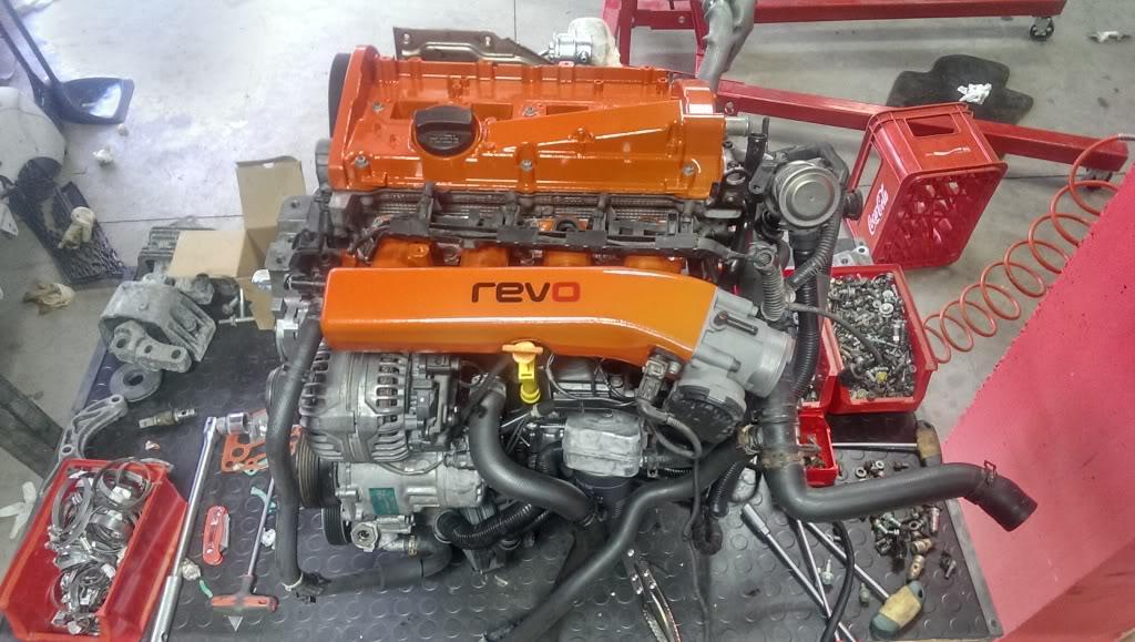

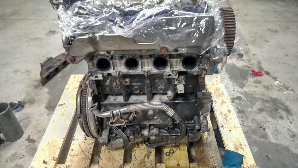

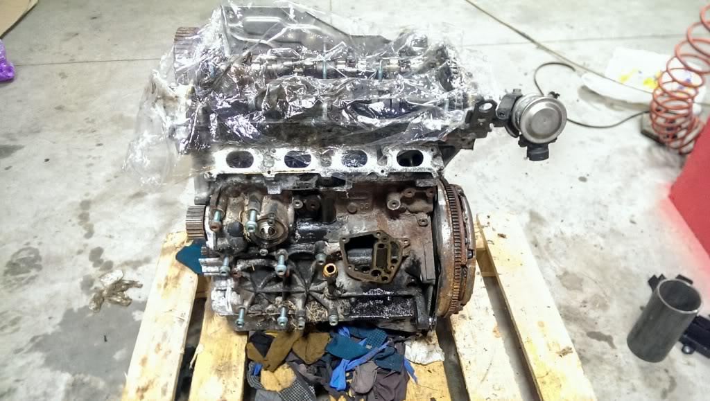

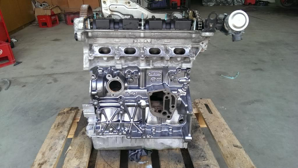

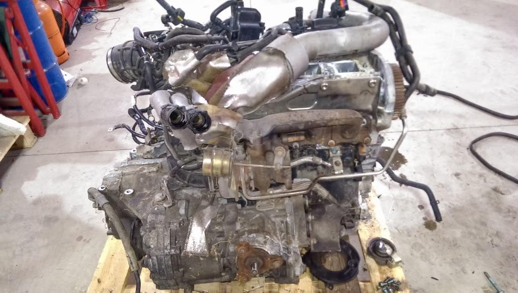

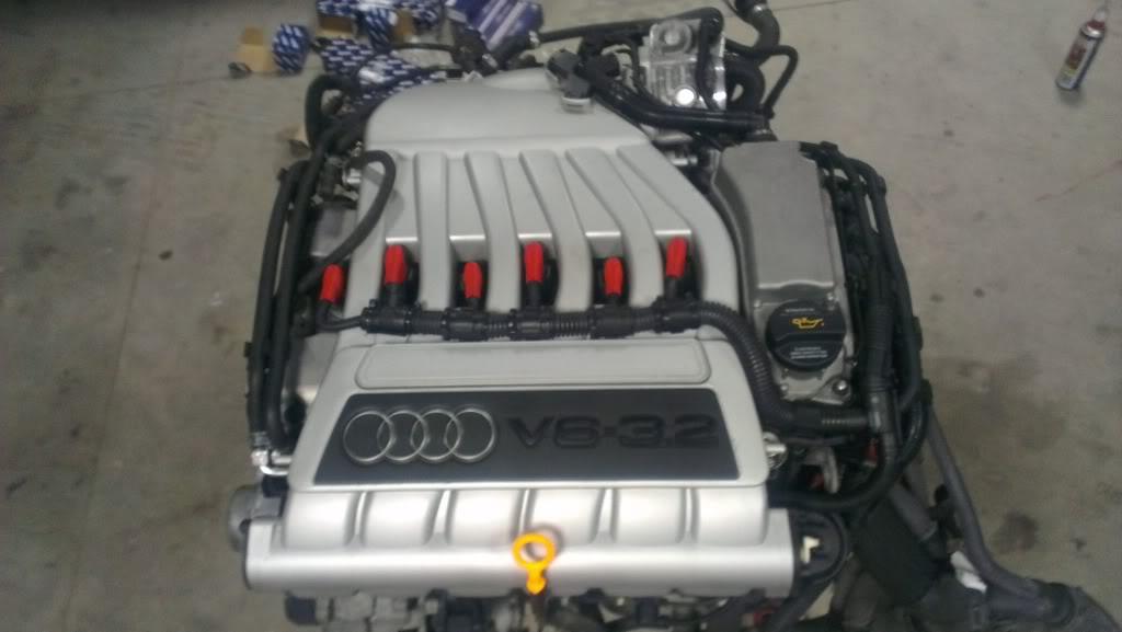

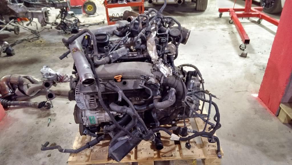

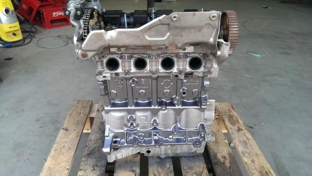

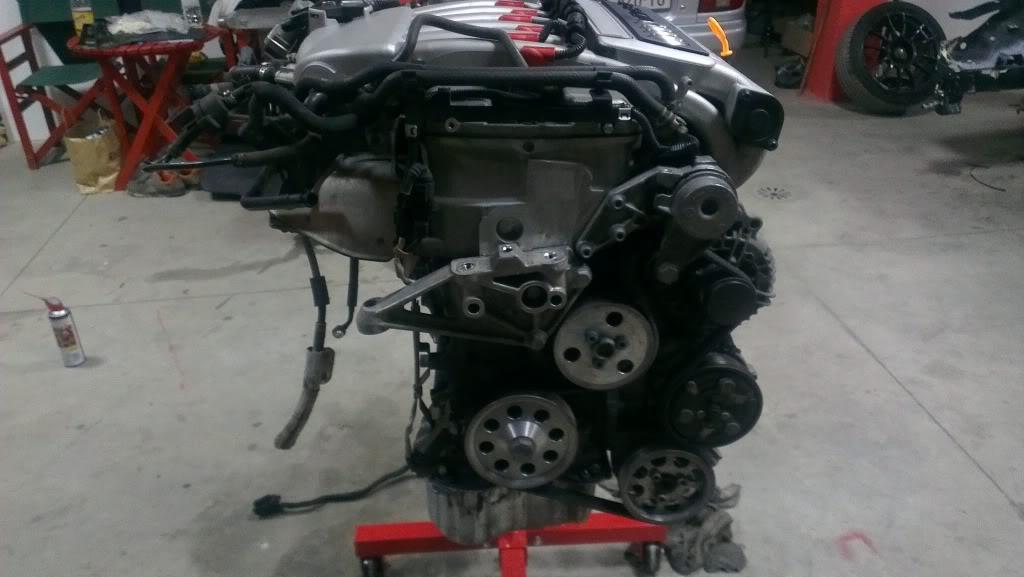

1.8T OUT

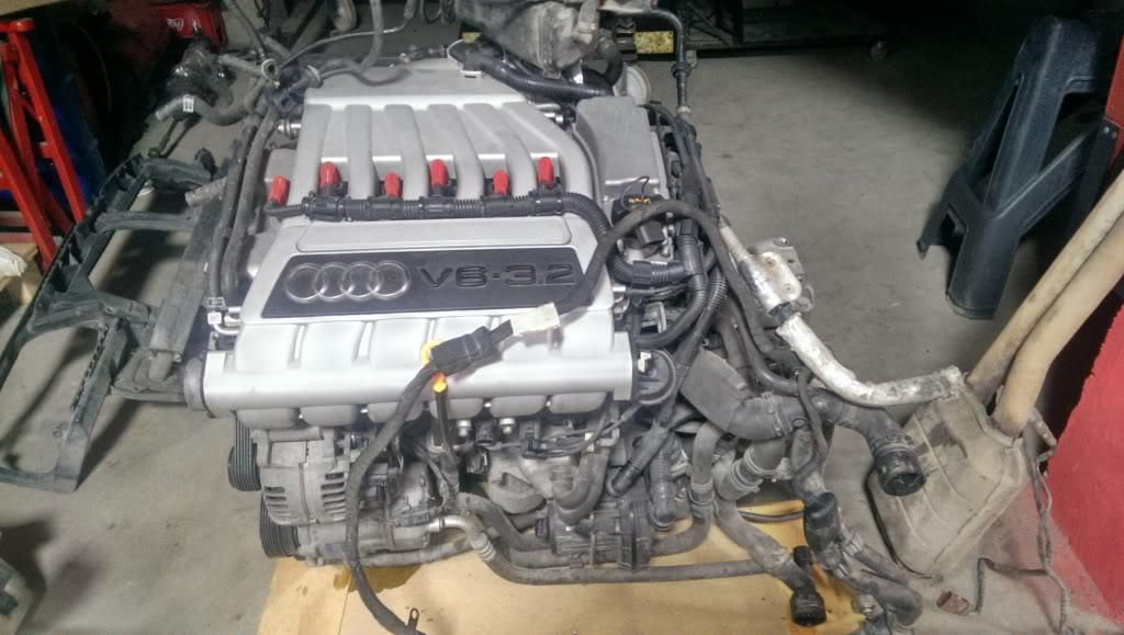

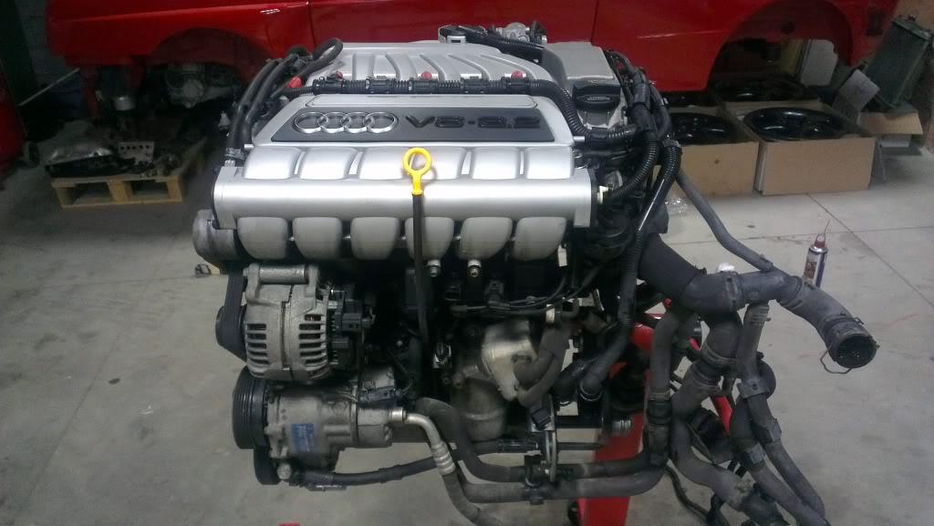

R32 OUT and SOLD!!!

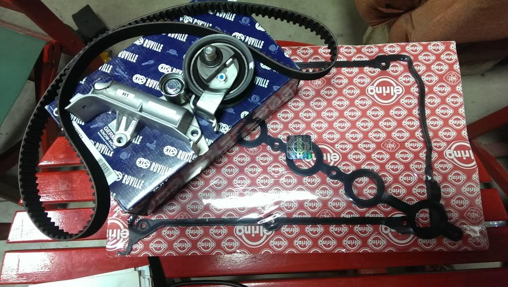

I bought a new set of belts,gaskets, water pump ... (not all in the picture)

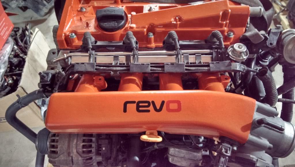

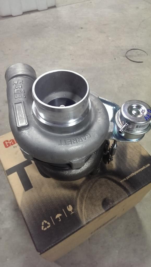

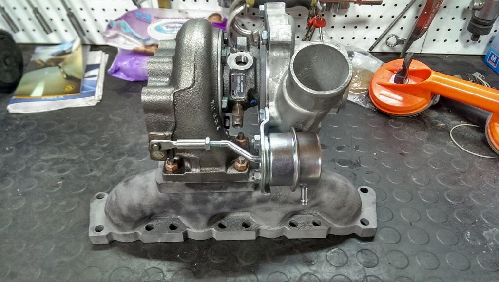

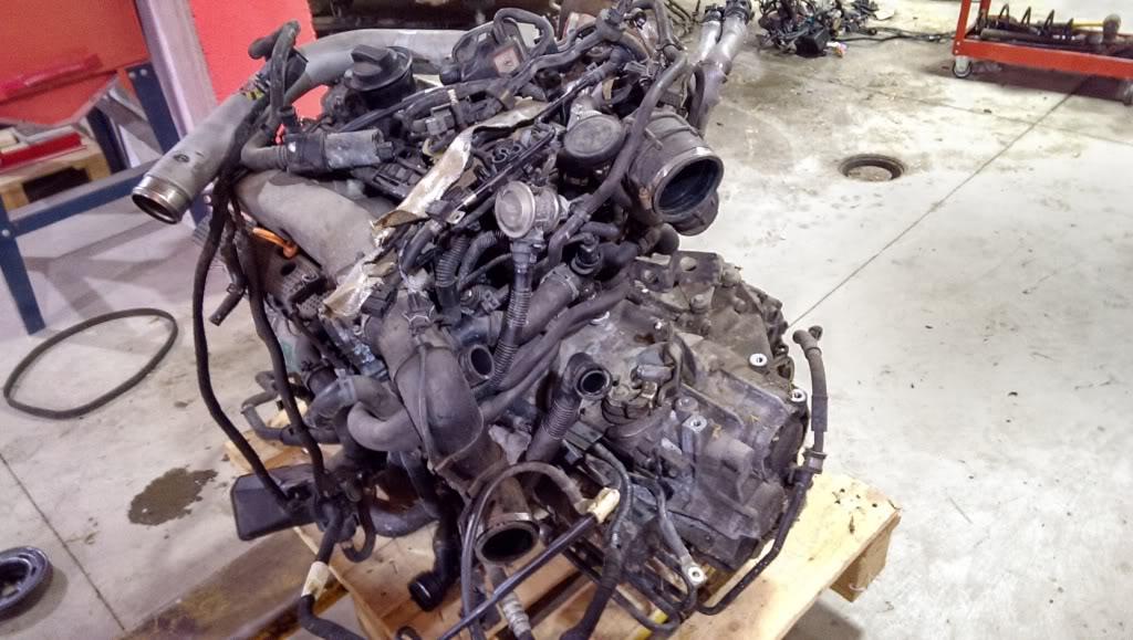

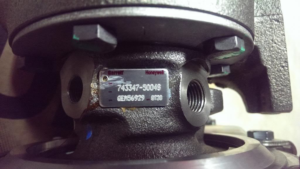

and some aftermarket pieces started arriving like the GT2871R :love:

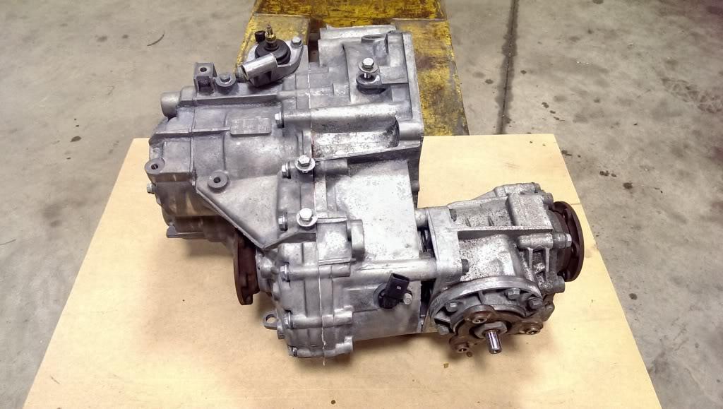

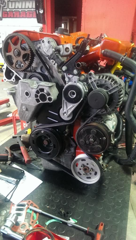

So engine separated from gearbox...and everything else  :P

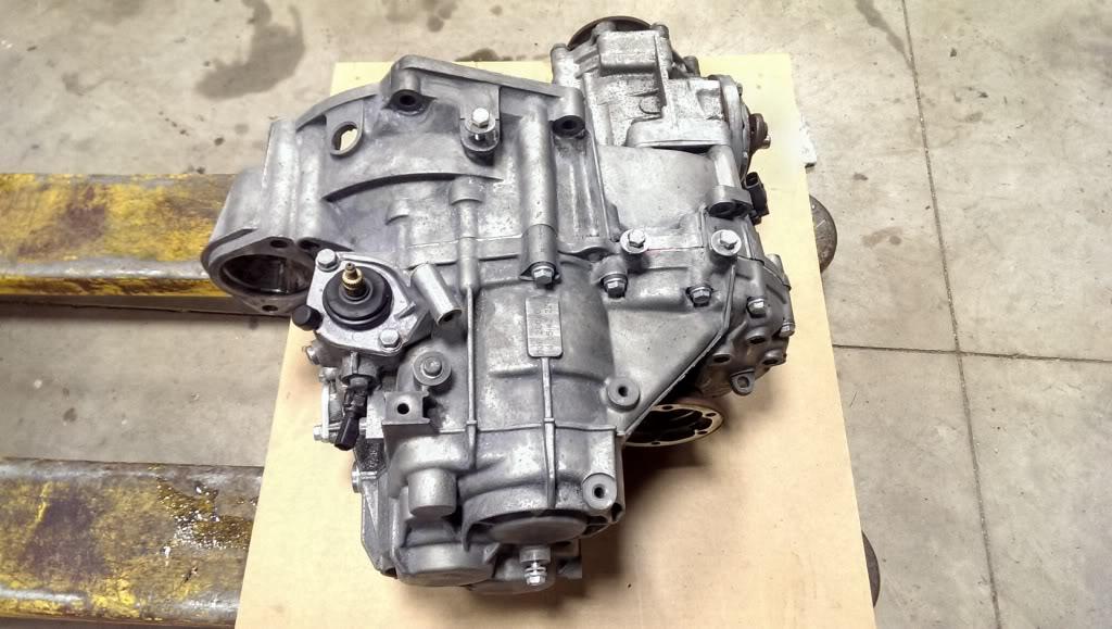

and dirty as hell  :surprised:
spent some time truing to wash the gearbox, so here are the results  :laugh:
Now waiting for the 550cc Injectors, and have to source out a good IC  :wink:

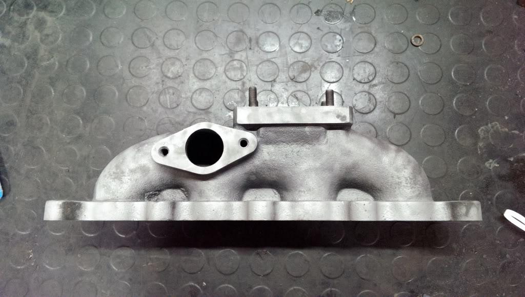

« Reply #26 on: October 31, 2013, 10:18:14 pm »

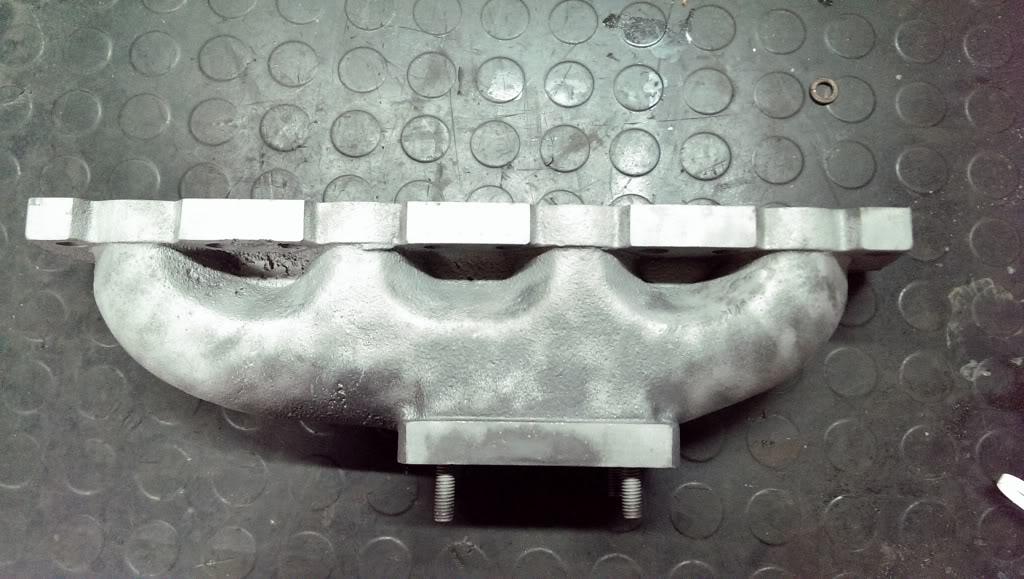

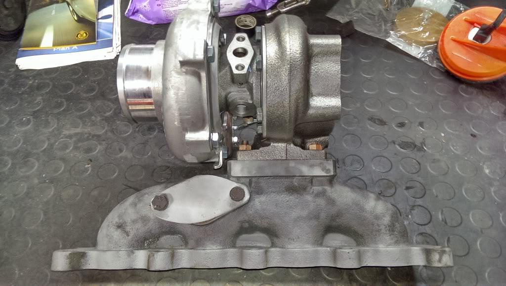

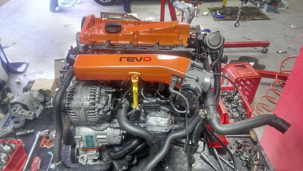

Bought and received some parts necessary this build to continue
and the exhaust manifold

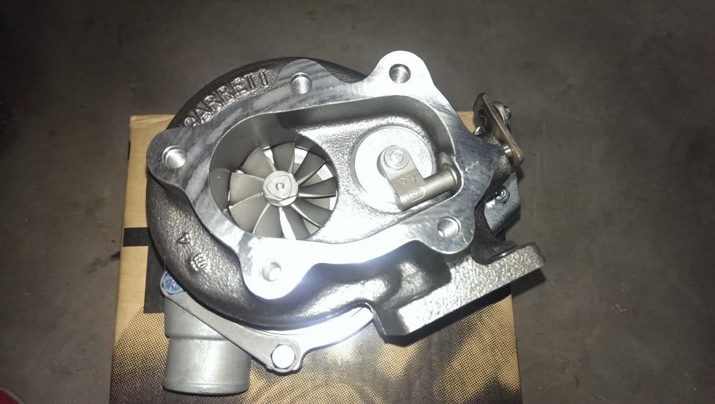

and hugging with the Gt2871R

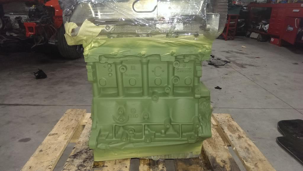

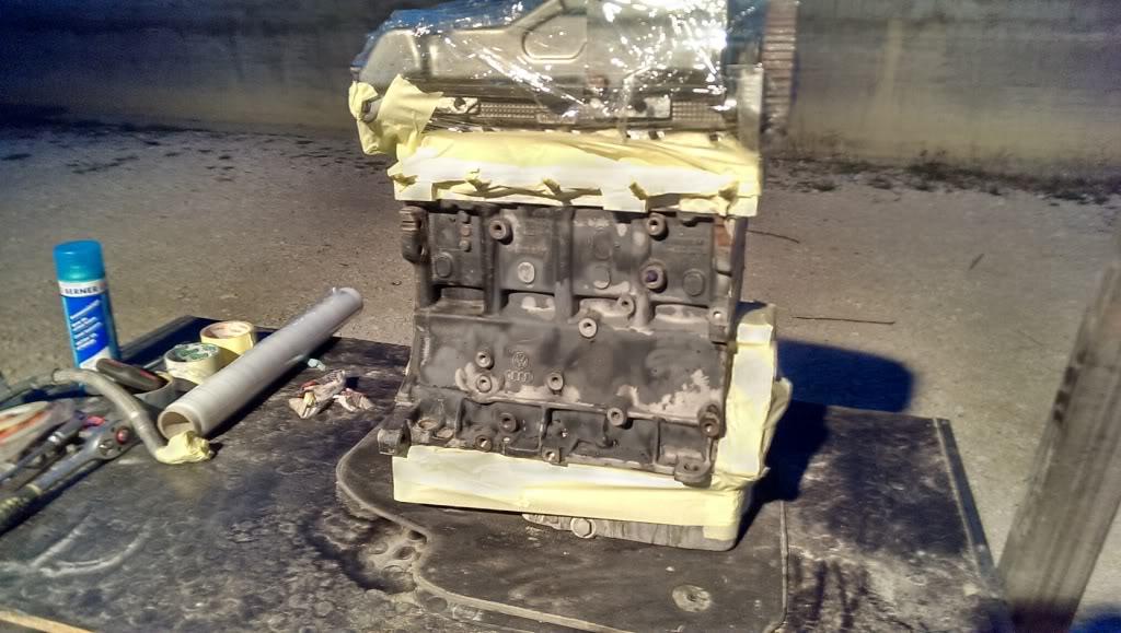

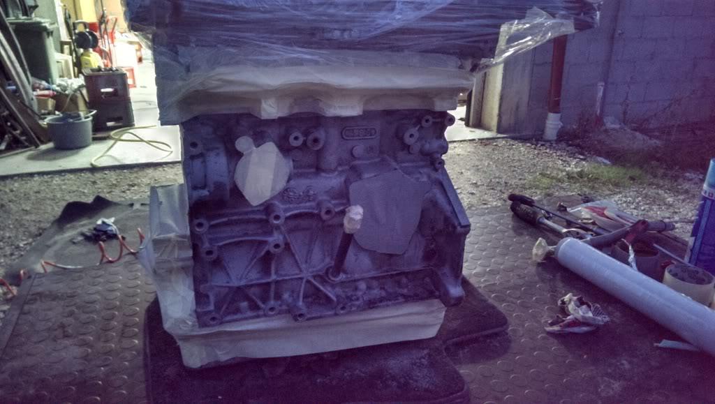

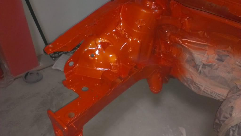

the engine was in a really bad shape so I decided to sandblast the rusted parts
the front was fully sandblasted
then in primer
and painted :love:

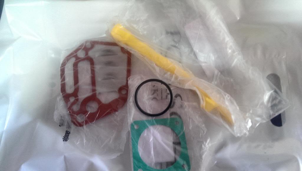

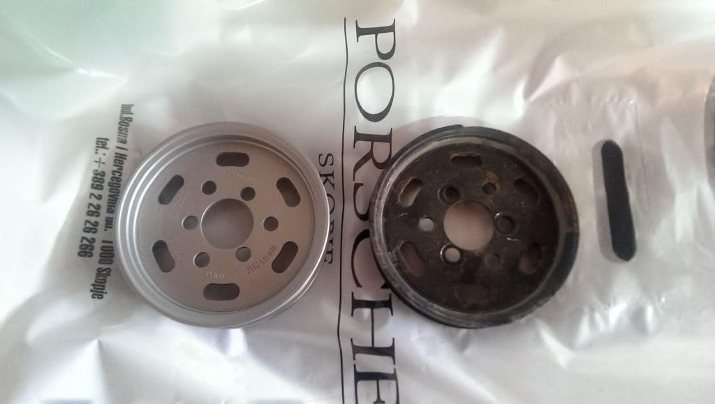

I was happy to see that VW is working on updating the parts for their engines (old one steel VS new one aluminium)
all new gaskets
AND...

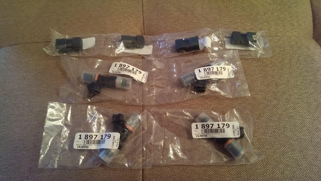

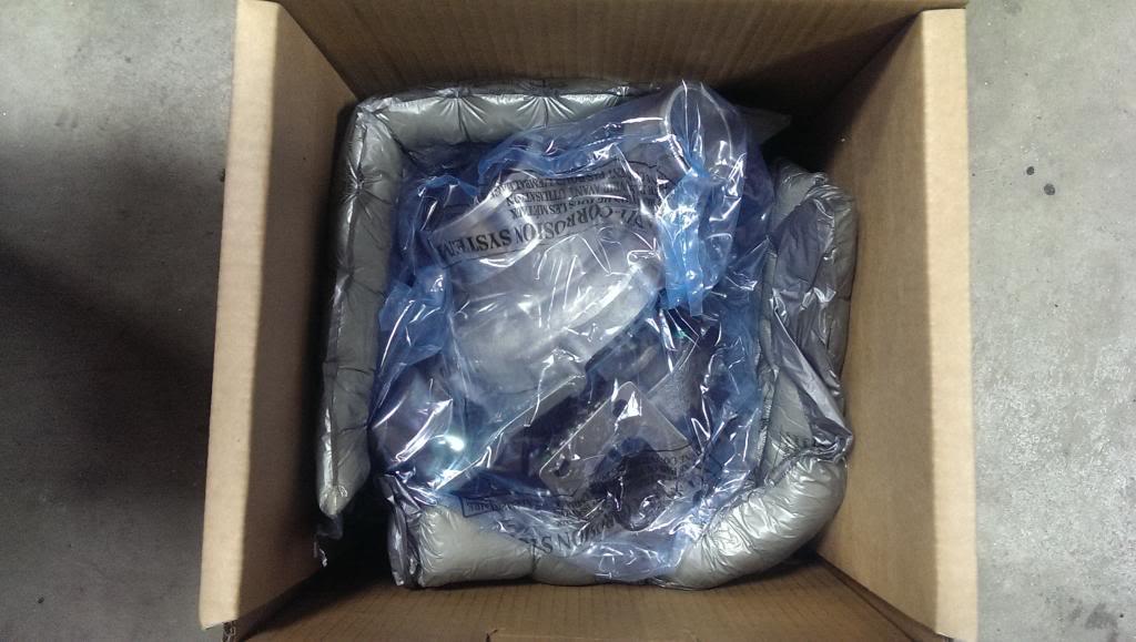

Also arrived the 550 Bosch Injectors from ECS tuning
so a quick job putting them in

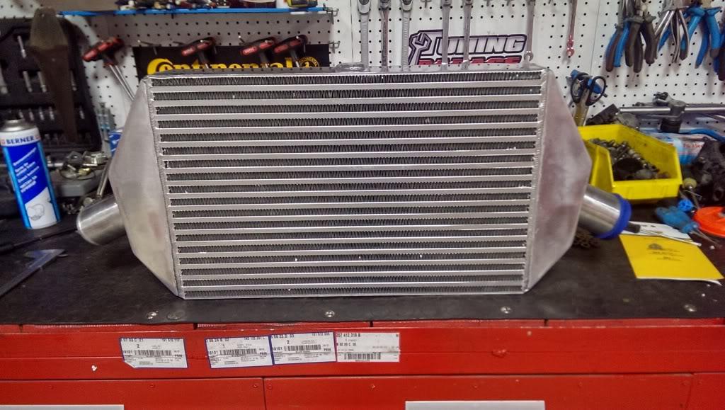

also came the IC

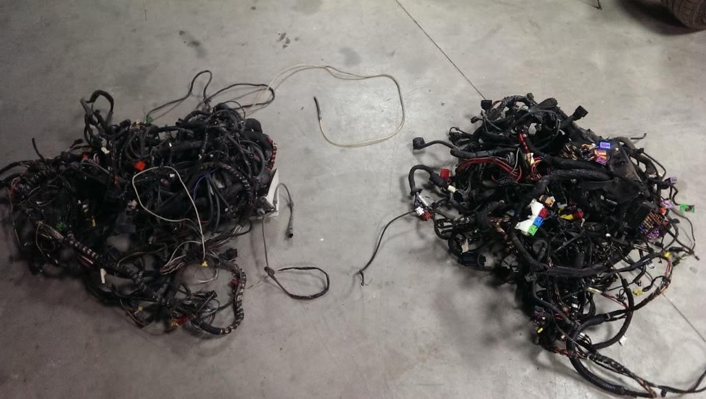

took out the old wiring
one goes OUT and one goes IN  :P

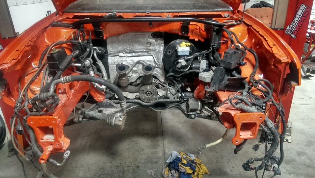

All that work yes and it's lovely but you don't smooth the engine bay?
Offline Scottymon
  • -Given: 83
  • -Receive: 125
  • Posts: 2139
  • UnNaturally Aspirated
« Reply #28 on: October 31, 2013, 10:29:35 pm »
So much work, looking great bud. :happy2:
Offline 2fast4you
  • Posts: 153
« Reply #29 on: October 31, 2013, 10:37:28 pm »
Well the whole engine bay is covered with plastics and stuff, and the engine bay is almost invisible  :happy2:
