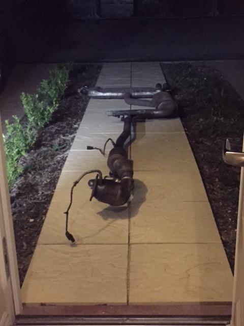

Had a fun evening wrestling off the stock exhaust ready to replace it with my Milltek - Unfortunately ran out of time tonight but this is how it stands... hopefully the Milltek goes on easier than this came off!

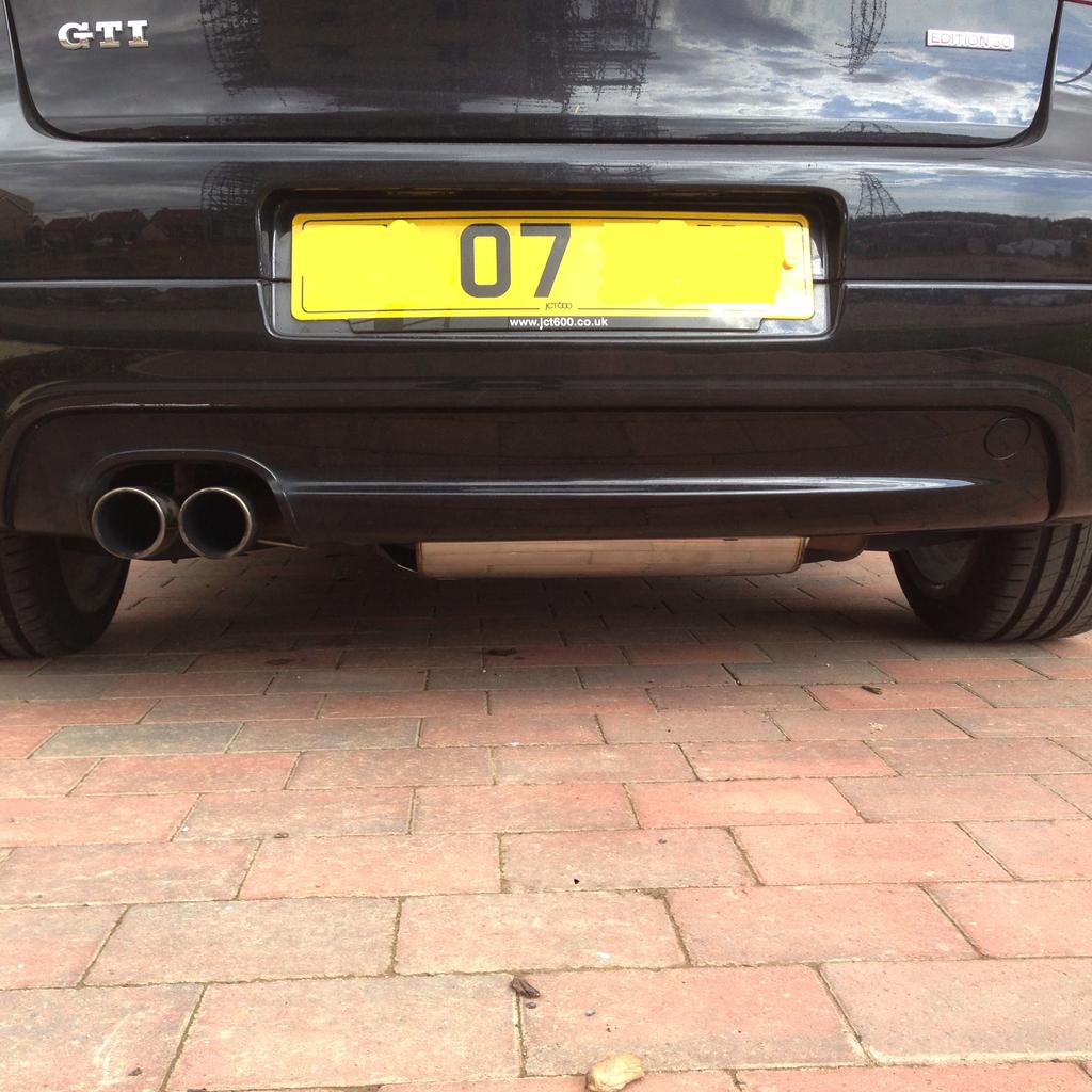

Managed to get the Milltek fitted and its bloody loud!
Checked the whole system for leaks to no avail.
Turns out its the race backbox with next to no packing! Combined with a non res centre pipe and a downpipe with race cat = TRACTOR :(
Anyone have any experience with this before?
I have 2 options, cut open the backbox and pack it up with rockwool or buy a resonated centre.
Not sure which way to go at the moment. Does anybody want to swap me a resonated centre for my non res? Mine has only covered 1000miles so its as new.

After a bit more research, I have come to the conclusion its the VWR racing system with the smaller backbox. Although its badged up as Milltek, it was purchased from a VWR employee who bought it from work.
Managed to get hold of a resonator from a member on here which should quieten it down.
Seems the VWR system flows a little better with less back pressure due to the smaller, less packed backbox.  So hopefully it will make some good numbers when I finally get her to Stage 2+  :happy2:

Centre resonator fitted now - what an improvement!

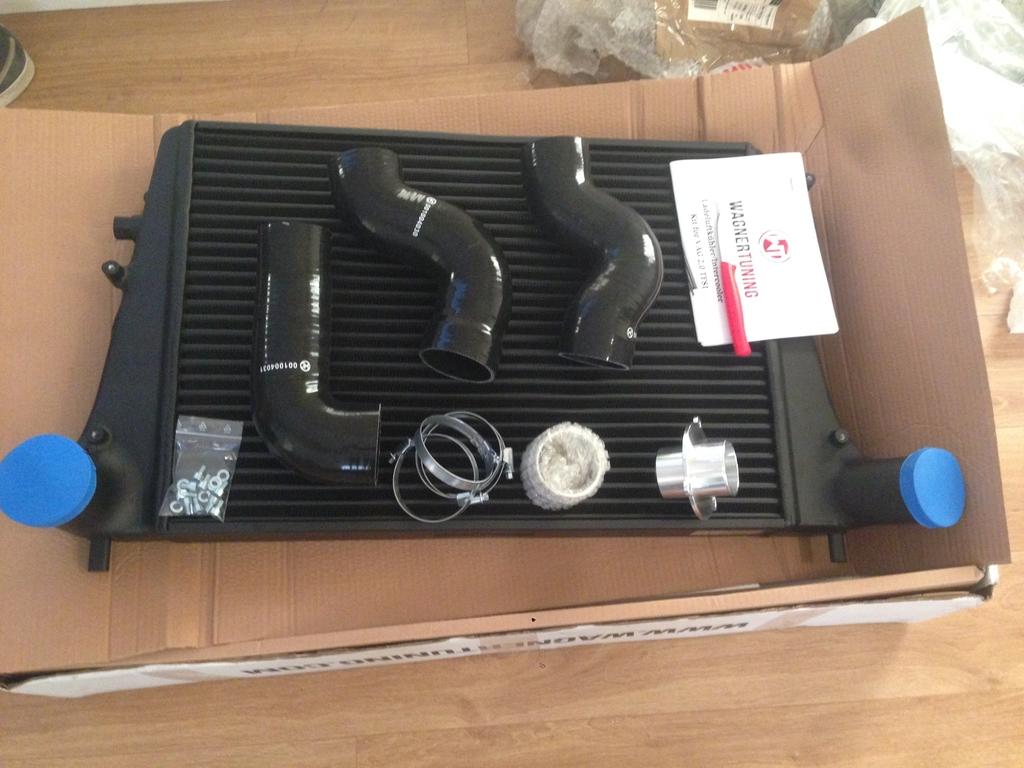

Anyway, my Wagner intercooler and turbo silencer delete got delivered today :) Hopefully have some time over the BH to fit and then off to Alex for Stage 2  :happy2:
