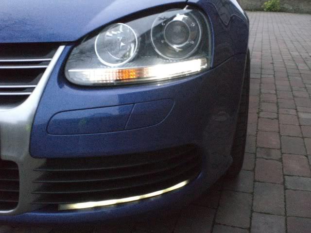

On OEM Xenons the side lights run across the bottom outer edges (about 5 inches across in terms of the bulb light output) and are clear on the headlight casing.
- to illustrate.
^ Those are Xenon look/LED side lights, OEM ones are yellow but you get the idea on location.

Ah! Ok.... Can I ask, do the indicator and sidelight 'share' the housing or are they separated? I.e. when the indicator flashes, does it look like its taking up the whole of the bottom section of the headlight? And same with sidelight?
Yes it does. They're obviously next to each other but the indicator bulbs are bright so the whole thing lights up orange when flashing.
It's going to be a bugger to try to put a bulb in if it's the case (would have been so much easier if the light was off!!
If what you've got are the same layout as OEM ones, changing sidelights is a bit fiddly but you'll get the knack of it. You push your hand in and pull the sidelight holder out it's seating to get access to the bulb. The sidelight housing (or bulb holder) is then loose but held on a set of a wires so flexible to move around with when replacing the bulb.
