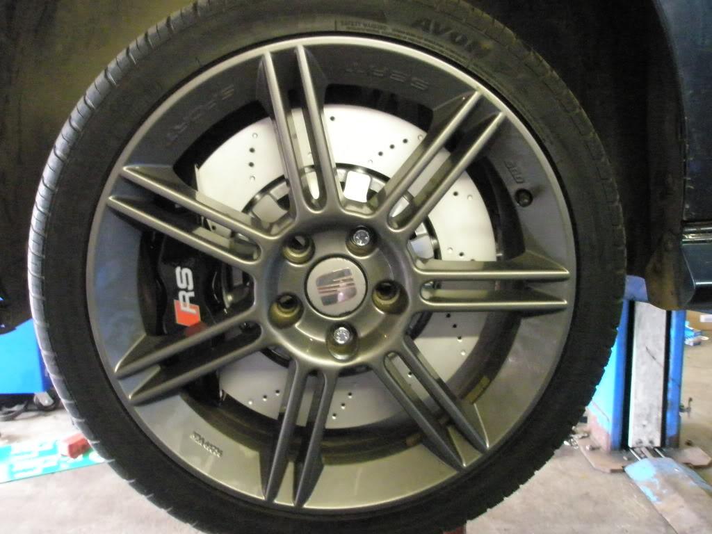

Fitted to my mk2 Leon, behind 18" BBS Seat Sport Alloys with a 12mm spacer

I think a spacer is required
Dave's/AP discs help here though as the bell offset creates more caliper clearance IIRC :happy2:

Dave's AP kit uses a 362mm discs instead of 370mm, so the caliper has about 3mm more clearance inside an 18" alloy.
