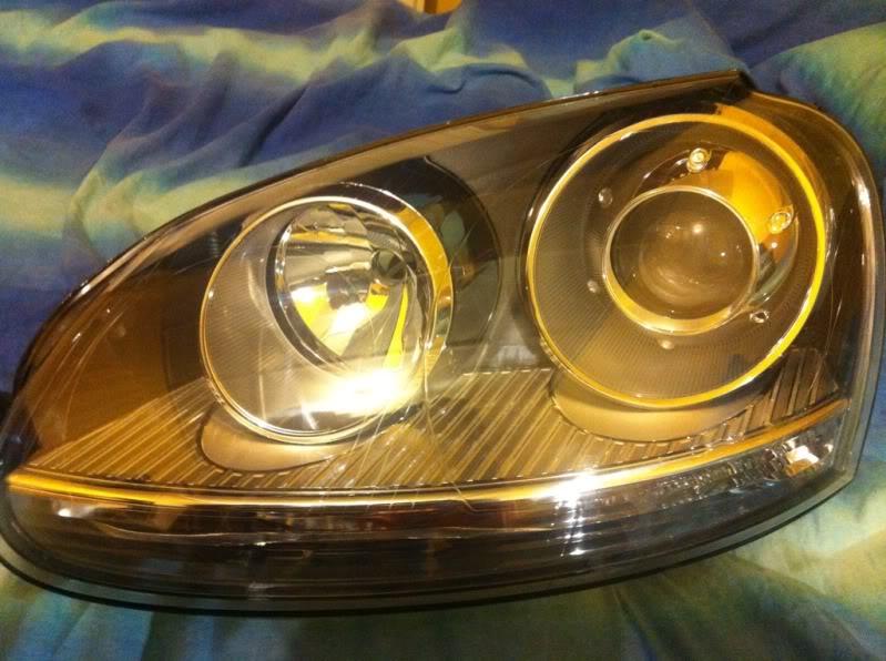

Looks good to be RHD to me... more light to the kerb side. If you don't want them I will take them off your hands bud.
Offline red6688
  • Posts: 73
Re: xenon style lights by FK any good???
« Reply #136 on: December 07, 2012, 04:01:20 pm »
but compared to pics it looks like kick on right meaning left hand drive?so confused
Offline red6688
  • Posts: 73
« Reply #137 on: December 07, 2012, 04:05:59 pm »
well i purchased through autoparts which went to fk automotive page link by keano but cant get in touch with them either by phone or email!!! to confirm lhd or rhd .so dilema dont want to sell to tim if rhd as he needs lhd .and want to keep if rhd possibly sell to someone if i get fed up anymore lol
Offline GTI_UK
  • Posts: 172
« Reply #138 on: December 07, 2012, 04:09:23 pm »
the kick is on the right so does that mean its left hand drive?
these lights driving me crazy ,if lhd tim do you still want them?
Not sure if it's just the pic/ angle but the kick up there doesn't seem to be much. But from what I can see, yes it does look like it's kicking up to the right - therefore for LHD cars.

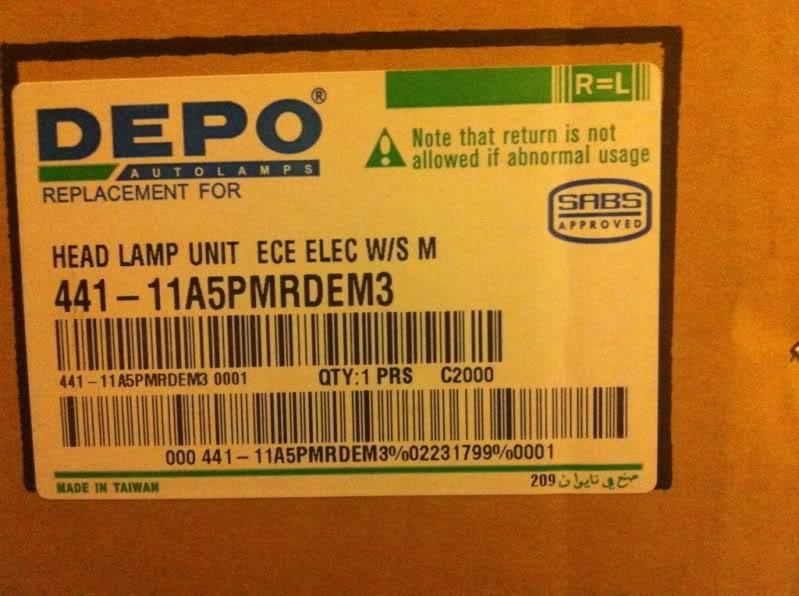

That's the right part number out of the depo catalogue for RHD!

Definitely RHD. The SABS approved logo is a total give away. SABS is the South African Bureau of Standards, and South Africa being RHD, there you go.

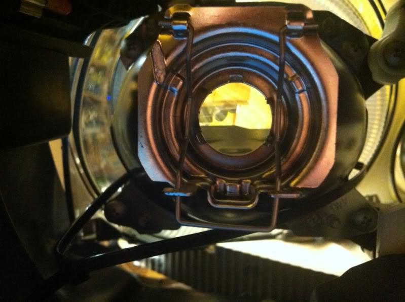

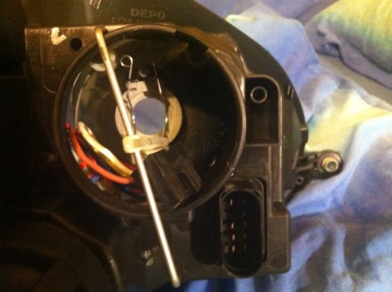

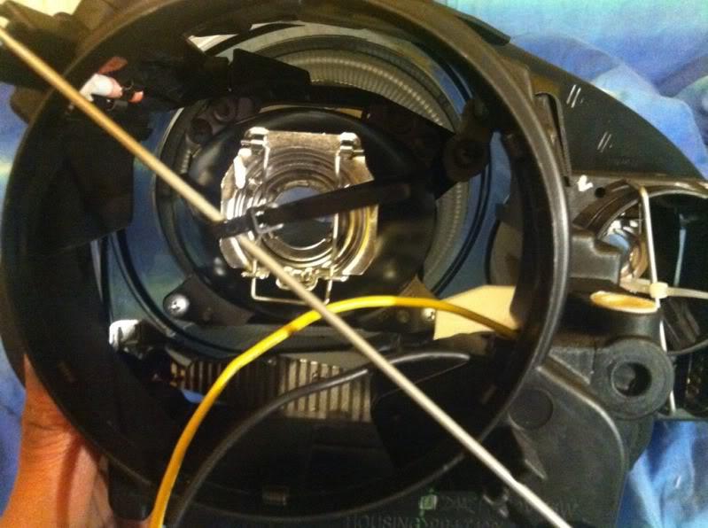

For future reference, this is what the lever and mechanism in headlights looks like:
This sits in front of the bulb and behind the projector: notice quite clearly the kick up to the left...
Most OEM headlights which have a lever are able to neutralise the kick to flat, like this:
In aftermarket lights, it's often kick up left or kick up right, rather than neutral.
