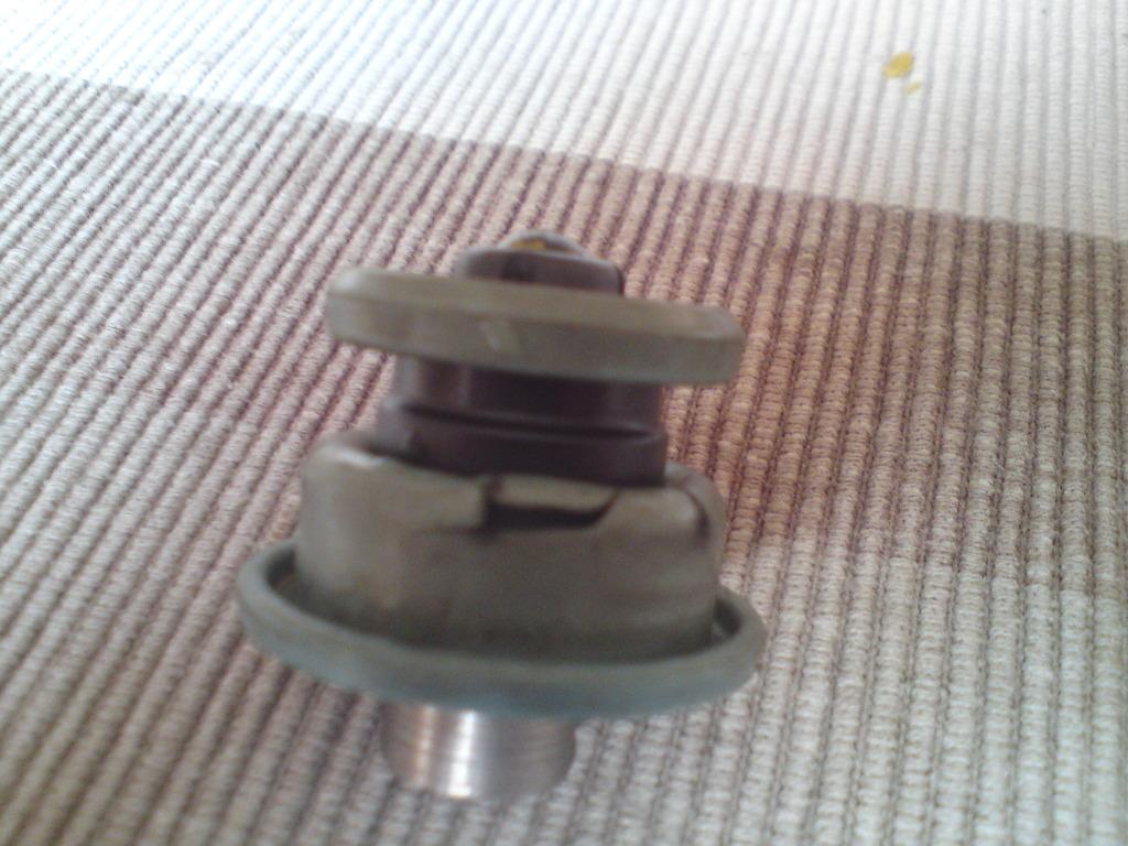

I think it would be worth checking your original DV, I can pretty much guarantee it will be split. I thought my 2005Gti was running fine but still checked it and was split!
Replaced with 'G' version no problems :happy2:
