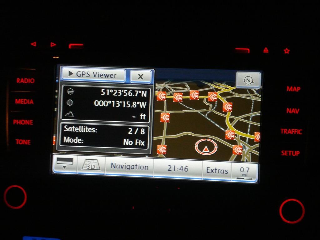

I'm having a fairly serious problem with my newish RNS510.  Its been installed for 3 weeks.
Driving home 3 nights ago from Heathrow airport the sat nav suddenly went mental and decided i was around 2 miles from my actual destination.
Ive been out since, last night and tonight and it has not rectified itself.  The pointer on the screen continues to meander across the screen through parks and rivers etc etc.  It is doing my head in.
Currently my car is outside my house but thinks it is 4.2 miles from the 'home' destination.
Is there are 'reset' button on the unit?
Can anyone help?

How many satellites has it locked on to?
Go to Map, press Map again to bring up the screen overlay and select GPS Viewer. You need min 6-7 satellites to get a lock oN.

Thanks guys.... so 2/8 is pretty appalling then??
Is this solely down to where the GPS receiver is situated? or the quality of the receiver itself?

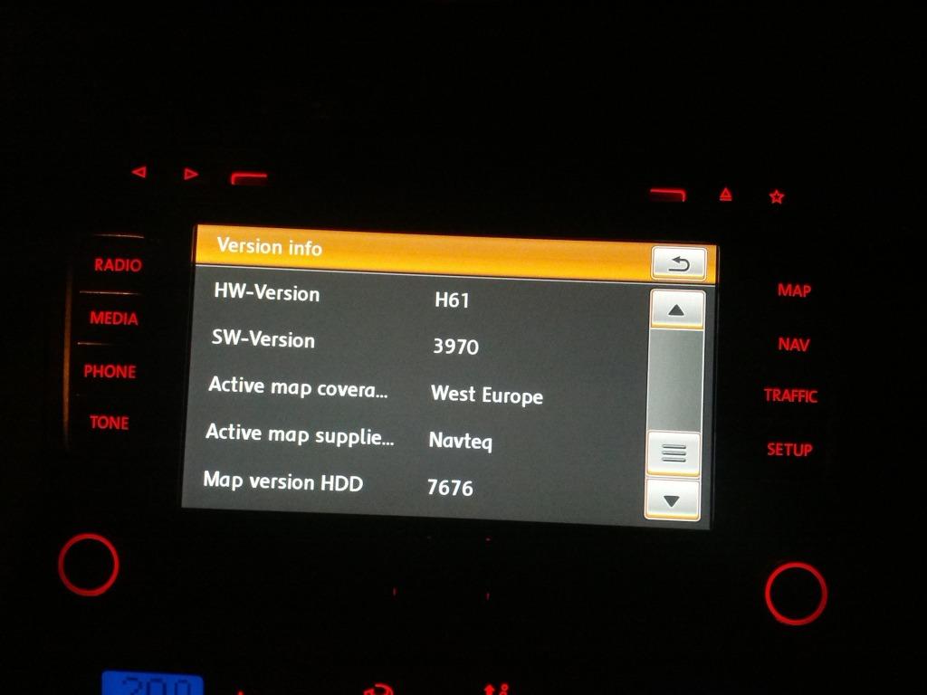

just checked my satellite coverage and I am getting 8 out of 11 satelites, how do you get the version number on the screen again ?

Re: RNS510 Sat Nav Problem
« Reply #7 on: November 21, 2012, 11:00:42 pm »
Should be able to hold 'SETUP' button and the 'secret' menu appears after the a Radio setting screen IIRC.....
Should then have a list of SW and HW versions etc.
« Reply #8 on: November 22, 2012, 12:00:34 am »
Hope that helps
PR
ahh, damn secret menus, I could have tried for a week and not found that, thanks
« Reply #9 on: November 22, 2012, 12:03:35 am »
interesting, where it says ft on your menu it is blank, mine says 275ft ? I assume that means 275ft above sea level ?
if so it aint picking yours up I guess, you can factory reset everything or individual systems radio etc in the menu under system, have you tried that ?

just checked my unit and my version is diff from yours, no pic as my comp is playing up
hw version = h70
sw version = 4120
map version hdd = 7920
dunno if me having higher numbers means you need an update but im getting 8/11 satelites ?

« Reply #11 on: November 22, 2012, 12:21:51 am »
try a different gps puck or change the position
« Reply #12 on: November 22, 2012, 09:30:57 am »
As Eddie said change the position of the antenna.
I've always fitted rns units and put the antenna on top of the unit towards the back as its magnetic so it never moves and always get great signal

« Reply #13 on: November 22, 2012, 10:51:21 am »
Thanks everyone.
Kindly a forum member is supplying a new antenna and I shall make sure it is fitted in the correct place!
Fingers crossed this does the trick!

« Reply #14 on: November 28, 2012, 09:11:31 pm »
New antenna fitted and I'm back in business.
Thanks to those who offered assistance and monte for supplying the new antenna.
