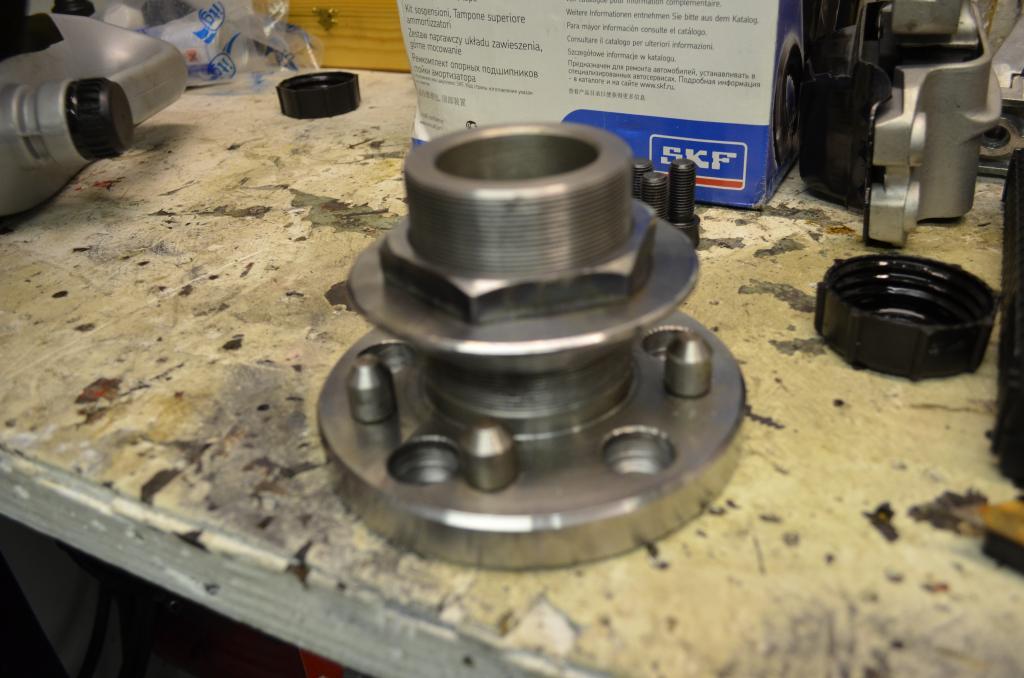

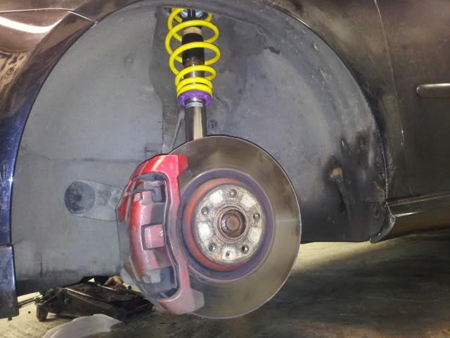

Right, so had a very productive weekend. Went down to Robins on Saturday morning and got stuck in. the plan for the day was to service the car, fix an electrical fault, get the coilovers in, get the THS engine mounts in and do a trial fit of the Speedlines. Thankfully all went well with no real hiccups worth mentioning!
Coils in :

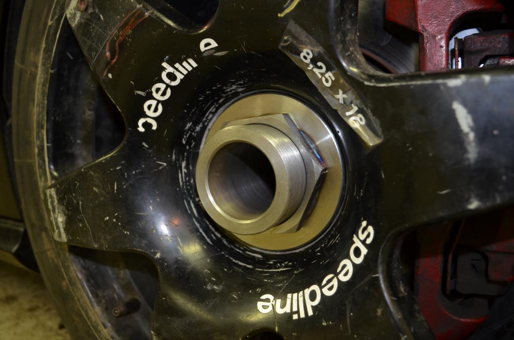

And the trial fit :

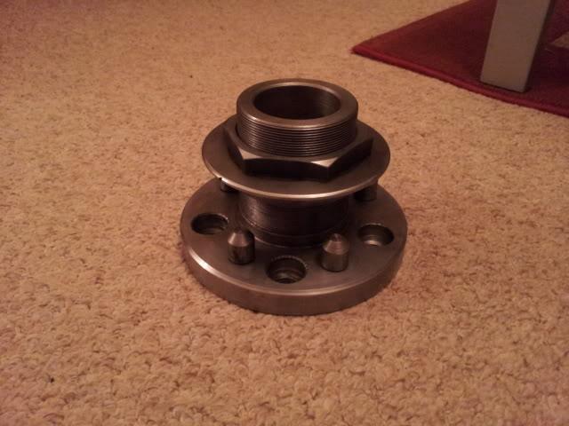

Adapters went straight on, nice tight fit on the drive splines as well as the wheel and hub centre bores. Luckily enough 18.5mm is pretty much spot on for the adpater too, so i'm in the very unexpected position where I don't really have to revise the adapter at all, barring speccing a different thickness for the rears. Was well pleased with how they looked on the car as well, I was struggling to properly picture them in my head, but it's all a bit more real now that i've seen them on.
Went for a healthy burn then afterwards to try out the new coils. We set them around the middle damping setting, and I was very, very immpressed by them. The comfort was excellent, and even on a very wet night like Saturday night, the car felt really sure footed. They were a clear step above the XYZs in pretty much every respect, particularly comfort.

Adapter looks like a awesome piece of engineering and cant wait to see all the wheels on once everything else is done.
