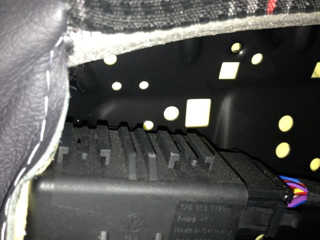

The control box under passenger seat on a 2008 looks like this
Should the thin grey wire not go into the fuse box (bottom part of the heated seats fuse) to complete the circuit so a fuse can be added?

Thanks for posting up! I cant see that module so perhaps its been taken off the seat before I got them. The Kufatec instructions read like this

I'm sure the thin grey goes to the lower part of fuse 7, and you put a 5A fuse in to complete the circuit.

Heated seat module part no
« Reply #6 on: November 30, 2012, 01:28:00 pm »
Thanks for the replies. The seat module is indeed missing - I found the loom tucked away up in the seat. I need the part number of the module if its not too much trouble.

« Reply #7 on: November 30, 2012, 01:35:54 pm »
The PN on my box is 1Z0959772B.
This was superceded by 1K0959772 and then 5K0959772 - €68 'control unit for seat heating'
