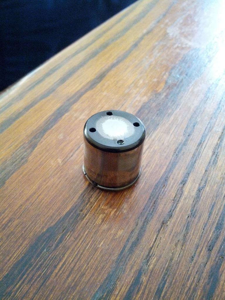

Offline ArildStavrum
  • Posts: 335
Re: Cam follower - you're all perverts!
« Reply #54 on: December 07, 2012, 12:46:20 pm »
As my car is in for the repairs to the front grill tomorrow I am having the cam follower replaced at the same time.
I am interested to see its condition after 83k and almost 7 years! (assuming it hasnt been changed, the serv history suggests it hasnt)
as per my previous post..... here is a pic of my cam follower, replaced today!
Offline Jaywoo-GTI
  • -Given: 38
  • Posts: 1050
« Reply #55 on: December 07, 2012, 01:56:17 pm »
Definatly needed replacing but doesnt look to bad for 83k,
I will be doing mine tomorrow, same age and milage.
