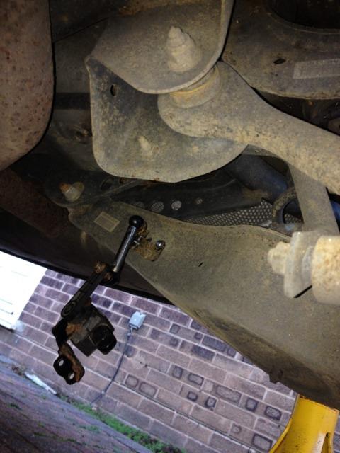

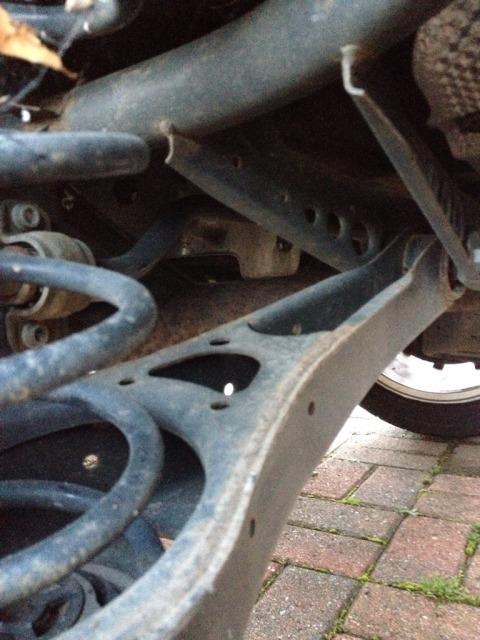

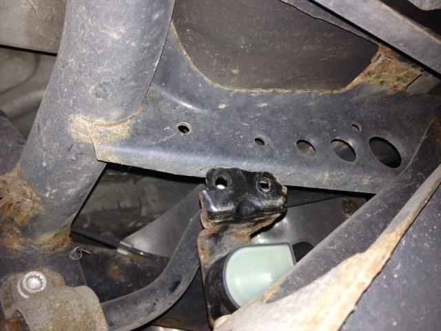

So today i decided to start on my auto levelling retrofit.
After jacking the car up and finding where the sensor goes, im a little baffled as the holes in the sensor don't line up with the holes on the car.
Looking in from the nearside...
The ones line up with the 3 holes...
Top one goes here?...
Hole spacing is out.......
Or am i being a dumbarse??  :fighting:

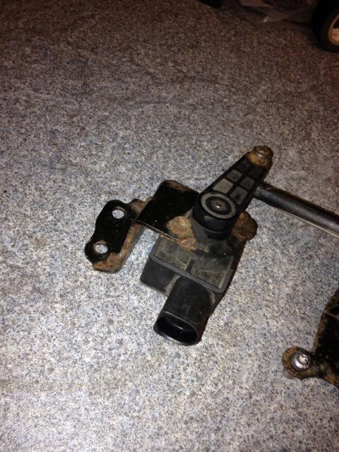

Looks like the rear one shown there has a different bracket to mine! I'll go grab a pic.

« Reply #3 on: November 02, 2012, 10:02:09 pm »

what is the part number on your sensor?
did it come from an r32?

« Reply #6 on: November 03, 2012, 08:06:09 pm »
Same problem I had, that's an r32 bracket and you need the one for a normal front wheel drive car...I ended up getting mine from eBay.de...

« Reply #8 on: November 04, 2012, 01:13:55 pm »
Rear Sensor Part number is
1K0 941 273E (which has been dropped)
New part number 1K0 941 273L (£111.48)
