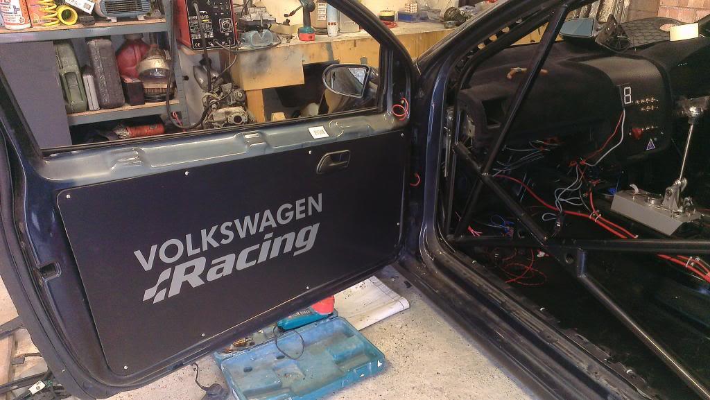

New luxury door panels are finished

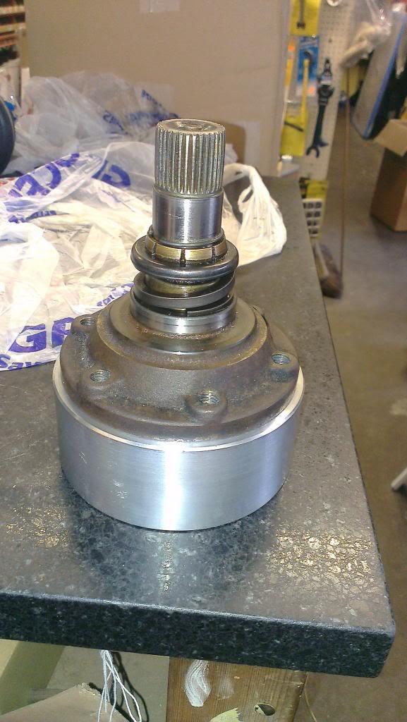

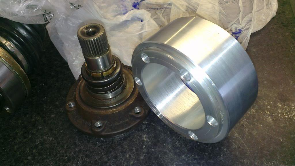

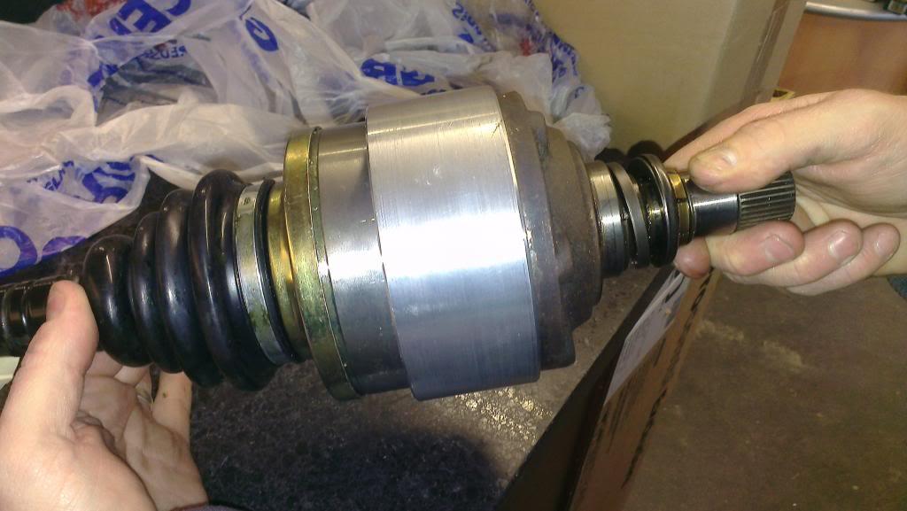

Driveshafts time well this isnt as bad as you might think as im using the 02J box a have 108mm flanges but the inner cv's dont mate up so i simply changed that for one from a Transporter VR6 so the o/s shaft fits ok however the n/s shaft is 50mm to short, after a day of trawling through ETKA and the web all i could come up with is this.
