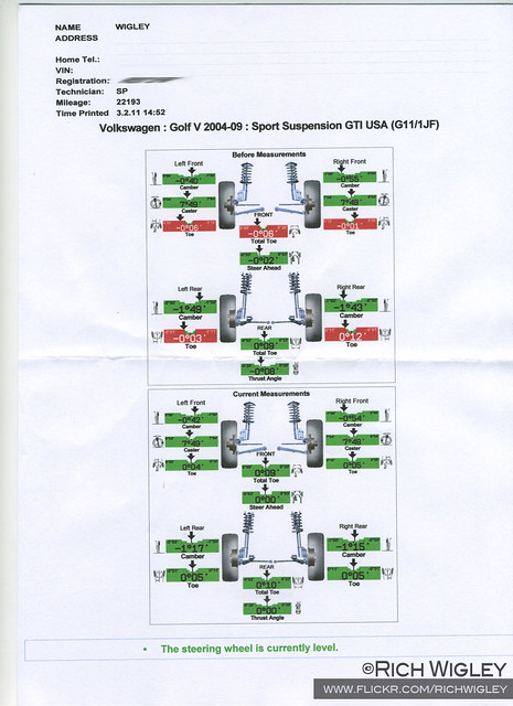

Re: Front Camber
« Reply #4 on: December 21, 2012, 04:16:39 pm »
GTI Alignment check by Rich Wigley, on Flickr
Thats what mine was with stock suspension and WALK kit.

« Reply #5 on: December 21, 2012, 06:17:17 pm »
I just noticed your alignment is US spec Rich, would this not be set up for left hand drive?
ED30, Custom stage 1 remap,  THS FR3 engine mounts, Helix clutch, AP coilovers, W.A.L.K, Powerfex lower front control arm bushes, Heko wind deflectors
Re: Front Camber
« Reply #6 on: December 21, 2012, 10:20:06 pm »
Doesnt make a difference I dont think.
