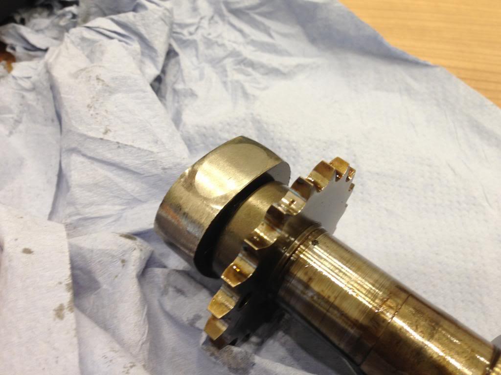

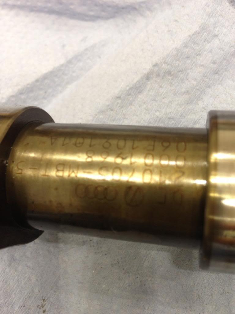

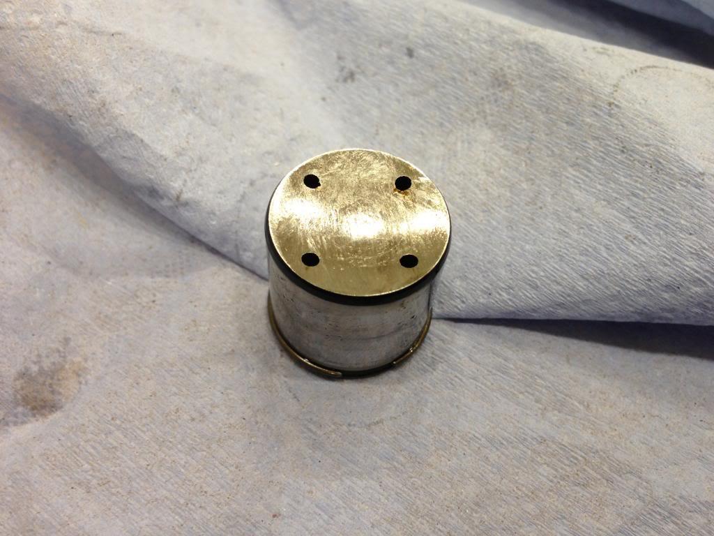

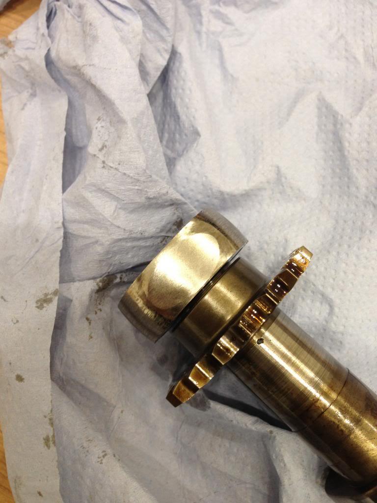

Here are some photos of worn Camshaft
Cam Follower looked ok
camshaft part number, is this the much mentioned Rev A

Post a photo of the cam 'end on' so we can see if it's 1 or 2 piece.
Part no. looks like an A which I thought had been changed by '07. Was yours built in '06 I wonder?

sorry these are the only photos i took whilst i was picking the car up, so never brought camshaft home with me

« Reply #38 on: January 18, 2013, 08:47:17 pm »
It is an A revision you had. Did you find out the build date?

« Reply #39 on: January 18, 2013, 11:18:41 pm »
How can i find that out?

Stick your vin in here and you will be able to see when your car was built.
www.cybertects.co.uk/scirocco/vincheck.php
Offline micaerin
  • -Given: 19
  • Posts: 444
Re: Car running rough now with photos
« Reply #44 on: January 21, 2013, 11:14:17 am »
Thanks  :happy2:  comes up as 2006
