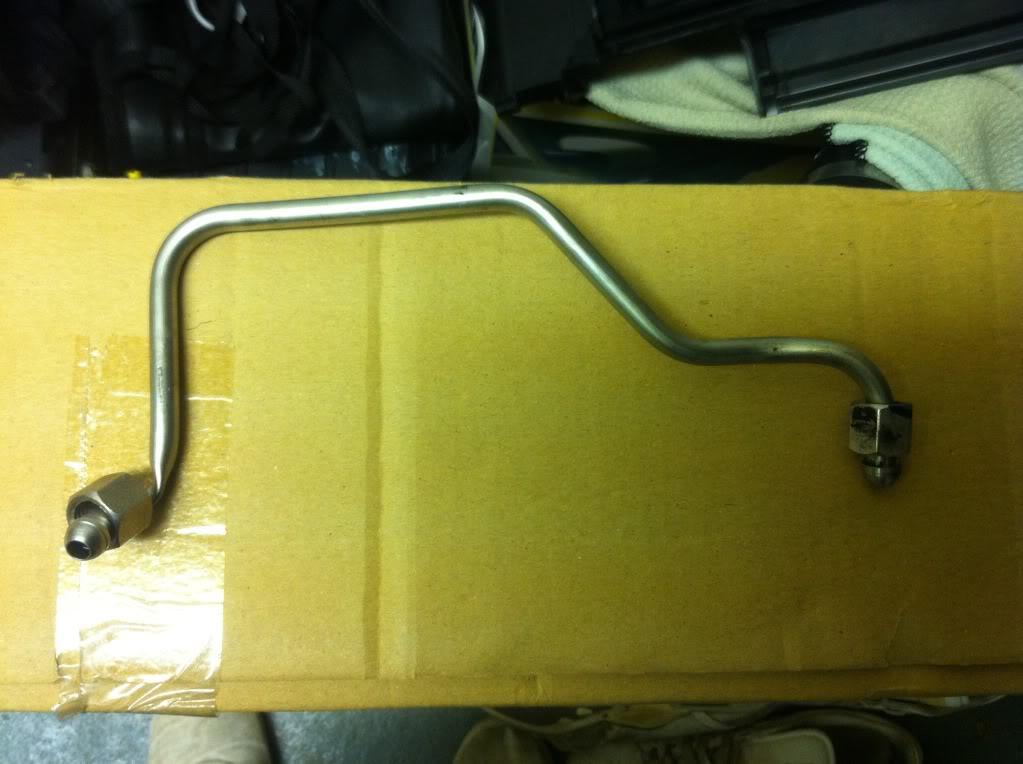

A word of caution, I think it is the right pipeline.
When you go to the Dealer, make sure you have the VIN number and Reg at hand, he should be able to input either and get the correct version pipeline, based on the correct engine number fitted to your car.
It should cost around £20-25.

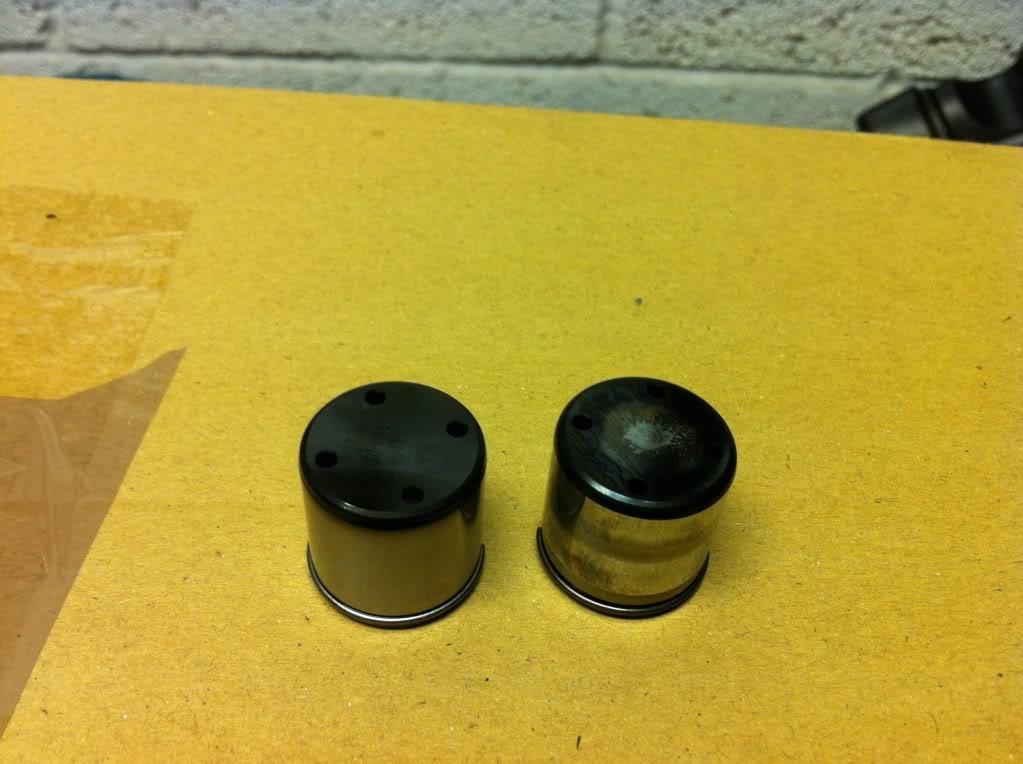

cheers guys went back outside and got the fuel line off so i will take that to the dealers with me, also got the pump off and the cam follower changed then put back on, for 62,500 miles it is hardly worn, feel so much better for chaning it though

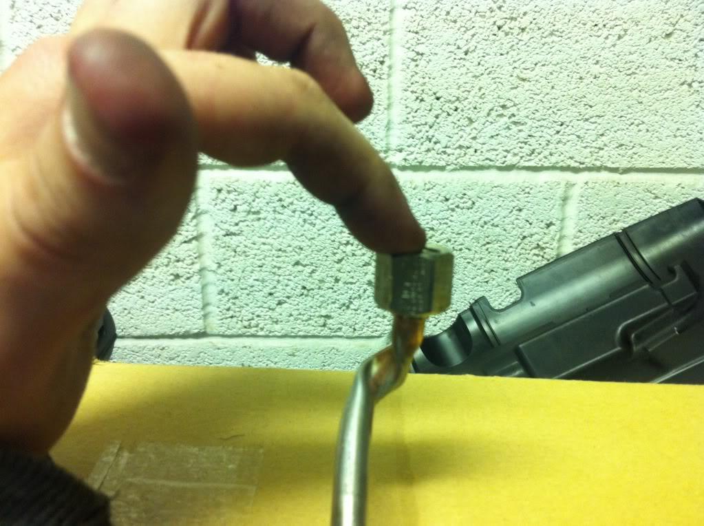

looks like the union is siezed on the pipe pal, which is what has twisted it, the union should be free to spin on the pipe. Not your fault realy pal :smiley:

Were you turning the silver bolt or the brass one when this happened??

If he was turning the brass nut then it will twist, you need to loosen the silver bolt then move the fuel line out of the way to take the brass one out.
