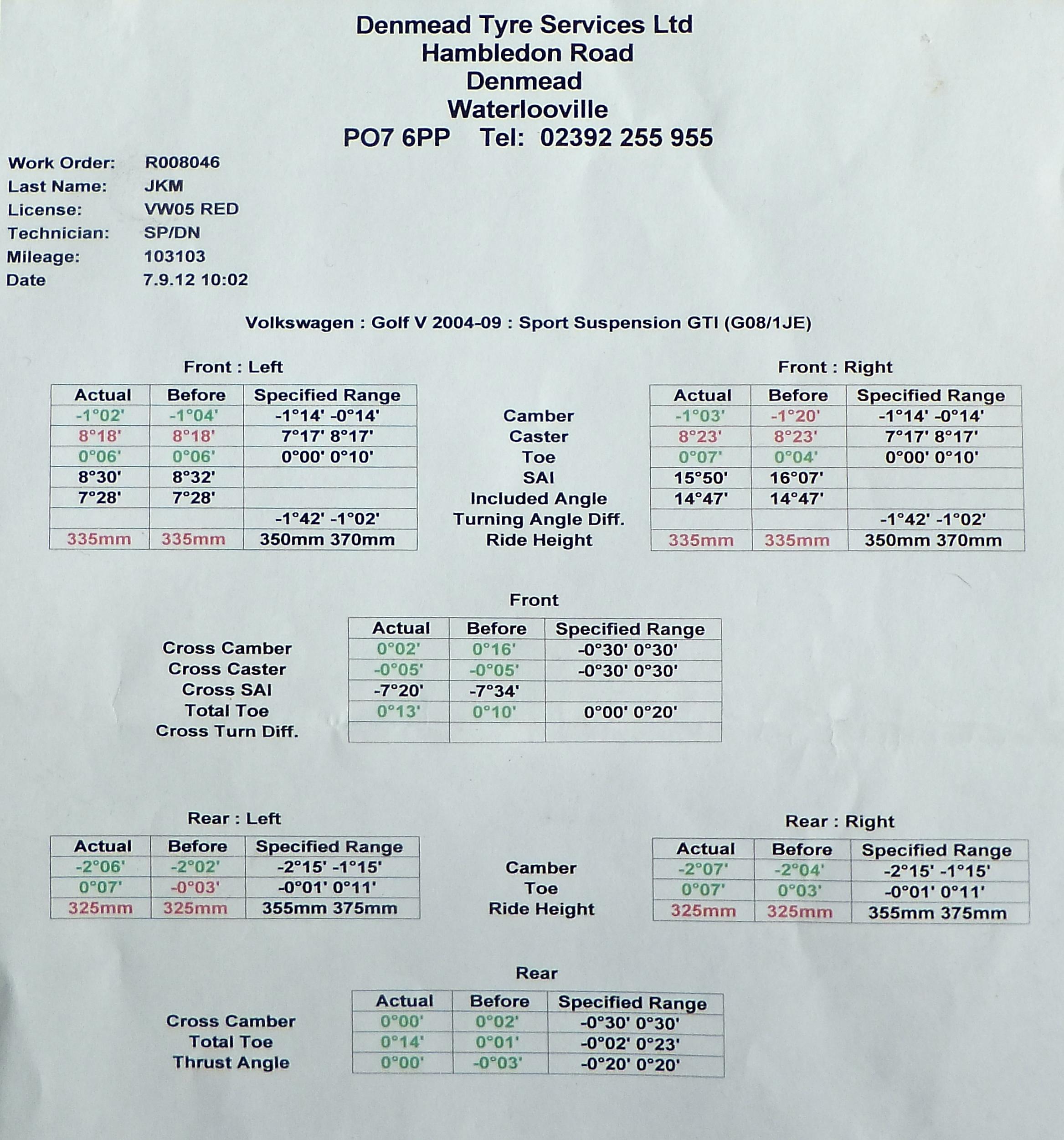

Yep, here's a pic:
I remember after having my ARBs fitted and the GEO setup by JKM a few years back and after my car felt really really bad, so much so I put it on ramps when i was at home to check if anything had become loose.  I then took it to Wheels In Motion for a geo check and found the geo was way off.  £112 sheets later and the car felt fantastic.
Get some money back from Awesome for the half arsed attempt, then go to a garage who has the correct alignment gear.  I normally check to see if the garage is using Hunter alignment gear, if so then ill consider them.

Just for info this is my alignment prinout after Alex had done with it. Superpro ALK, H&R springs and rear arb. Handling is fantastic. So much fun to drive.
Would that setup be applicable to a car with no suspension upgrades?

Yes, but not 100% the same.

JKM use guys with a Hunter rig................
^ My car feels extremely well planted on this setup ^
they did it in the workshop when i was there, but that was  back in 2007/2008
