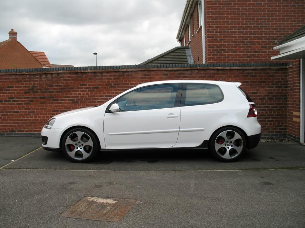

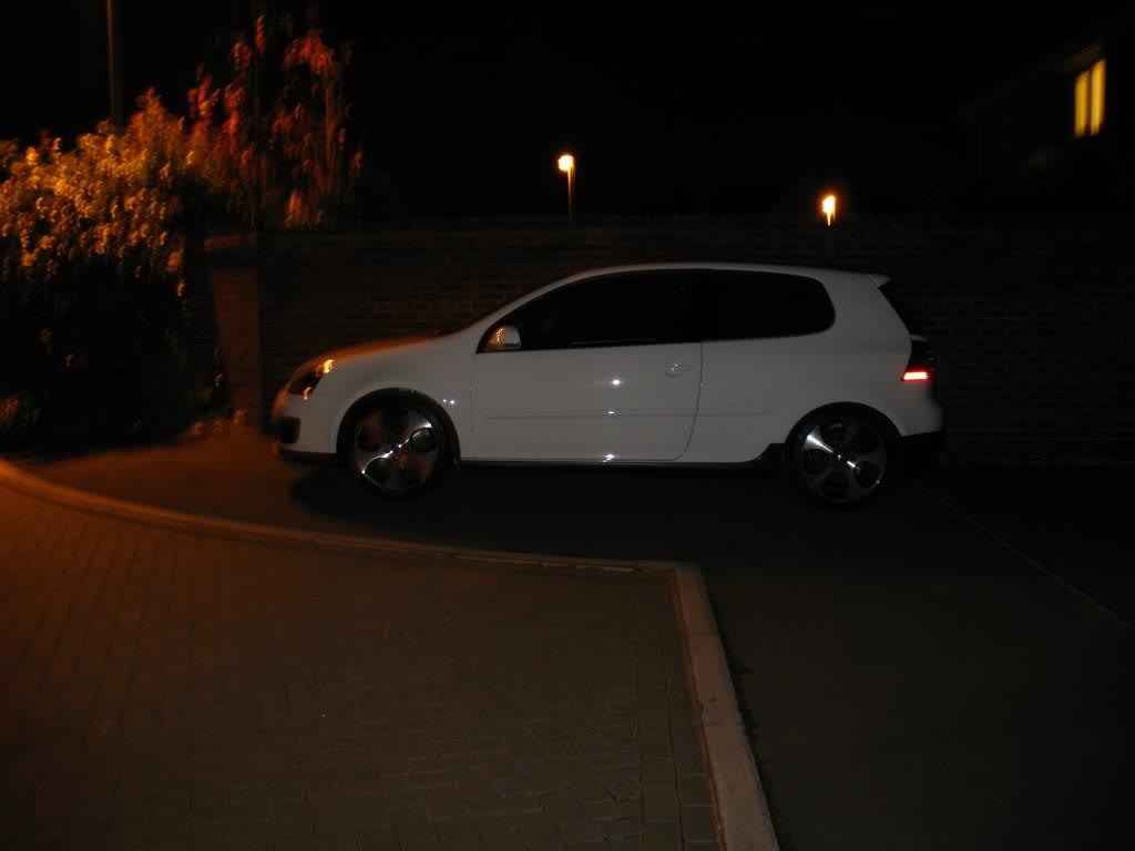

so with this in mind Votex set the back at a perfect height for me and the front looks a bit high but can be altered to suit plus they should settle 5-10 mil over the next couple of days. i took a pic but its not to clear. roll on tomorrow i cant wait.  :driver:

Good news TC, even from that dark pic you can see that there has been a healthy drop, looking  :rolleye: I hate these forums, everytime I come on them I want something new for my car  :sad:

Just seen the height for the first time in day light and i think its about right it should settle a bit as well.  :smiley:
                                                                    Before
                                                                      After
Re: *** Coilovers going on tomorrow ***
« Reply #28 on: November 01, 2008, 02:23:34 pm »
Looks really nice that TC. As you say it will eventually get lower when all has settled. You are well on the way with the mods now, what other plans do you have?  :party:
