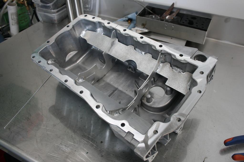

Quite a lot of track cars run baffled sumps to help prevent oil surge.
e.g. If you have a long left-hander the oil will more to the right-hand side of the sump and may potentially lead to starvation and BOOM!
These are the baffled sumps I make for the 1.8T engine:
Cant do them for the TFSi's though.  No room, but I can convert them to the 1.8T oil pump.
I can vouch for this great piece of kit as I have one on my track mini. IHMO - Anyone who takes their car onto a track on a regular basis needs to think about a baffled or dry sump setup. Otherwise, its a gamble on the engine going pop.
