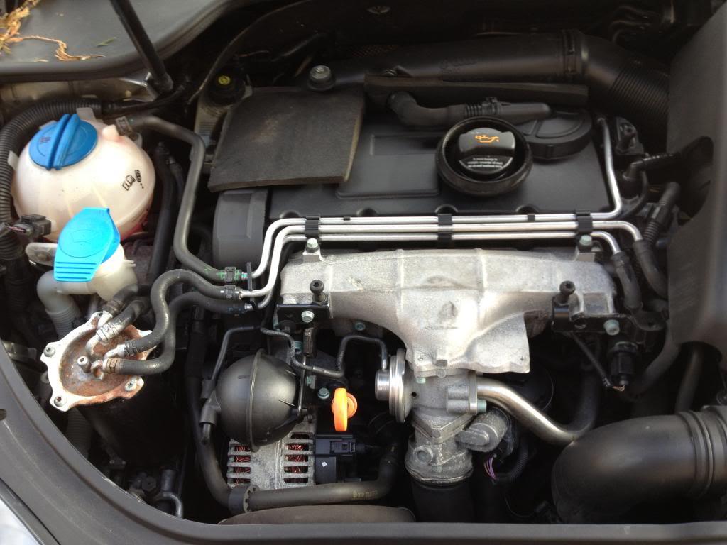

What engine?  2.0 tdi 140?
Ill get you a pic of mine when its light tomorrow.

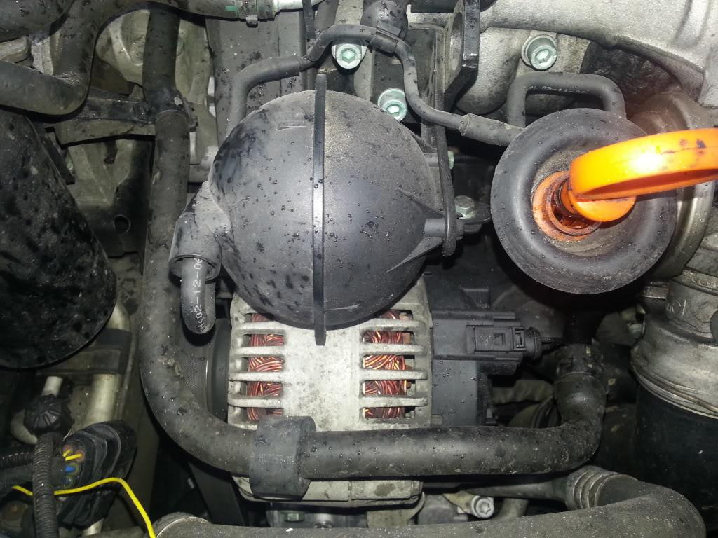

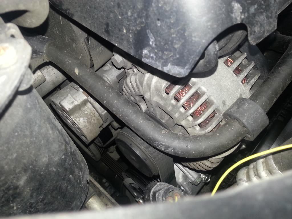

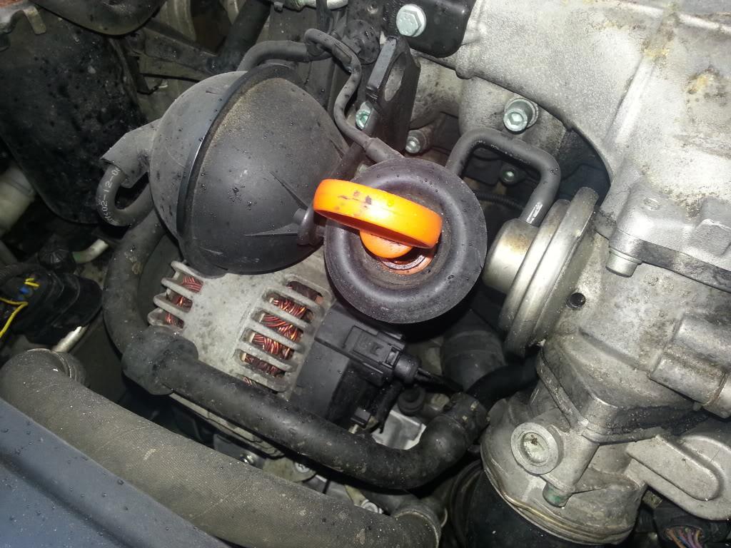

Here's a couple of pictures of the engine bay, and the pipe itself as it was resting and a picture of the damage caused from the heat off the alternator.
Any idea if there's anything to protect it from touching the alternator?

Apologies.  I didnt get chance to get some pictures.  Well get some today and compare to see if anything is missing?

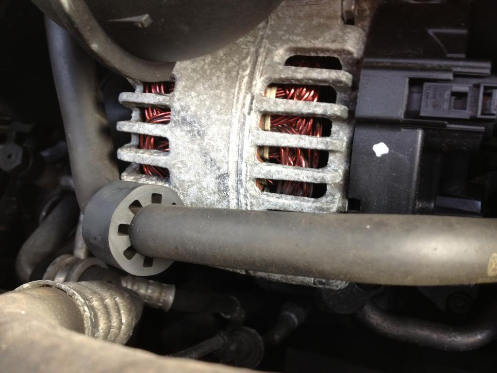

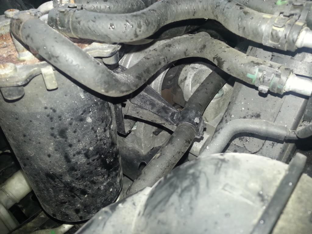

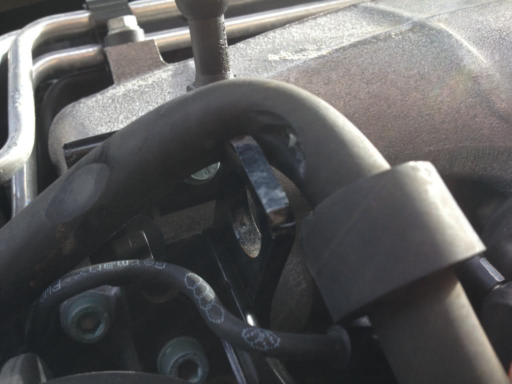

« Reply #7 on: February 05, 2013, 02:24:02 pm »
Looks like there is a plastic arm that holds the coolant pipe up and fixes to somewhere near the fuel filter, although mine is loose, see pic:
Other than that, the rubber bung rests on the alternator as in your pic.
Does that help?
