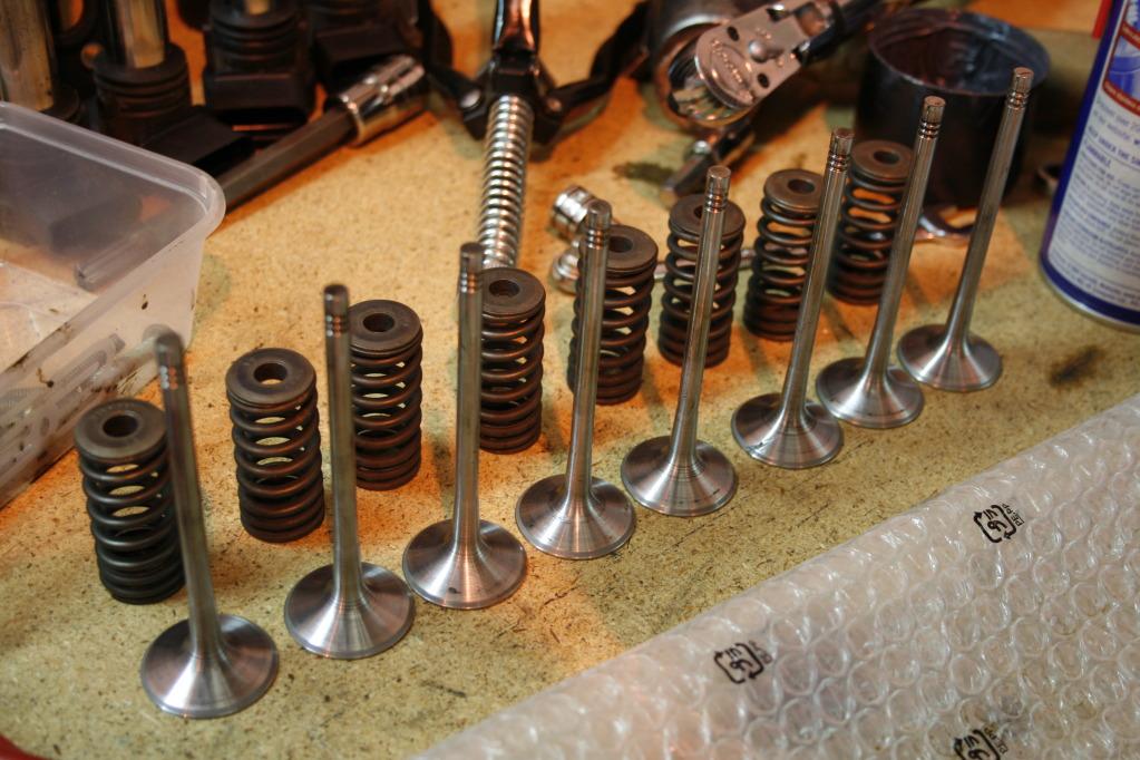

After 10k or so my inlets are getting gungy again even after I removed my valves and fully cleaned the ports:
I cant find th pics I took after 10k of the ports again.  I run a catch can so imo these make bugger all difference to keeping the ports clean.
