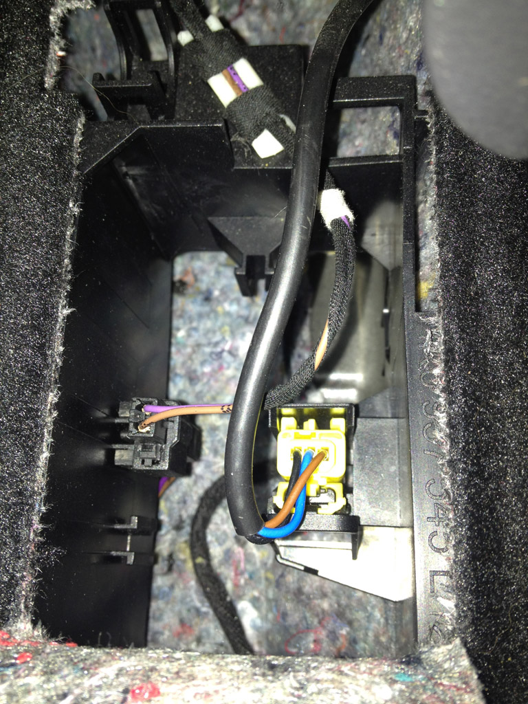

So I managed to find the flap with the wires under it... mine looks like this...

The picture I put up is from above - i.e., the seat to the floor.
Even if your seats have elements and the heated loom (look for the wide rectangular plug same as my pic) then you'd have to buy the Kufatec loom (the one that runs under the carpet from both seats to the heater panel/fuse/CECM).
It seems you don't have either.
