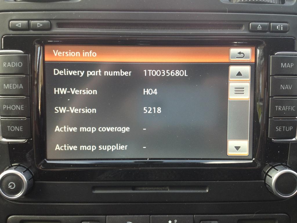

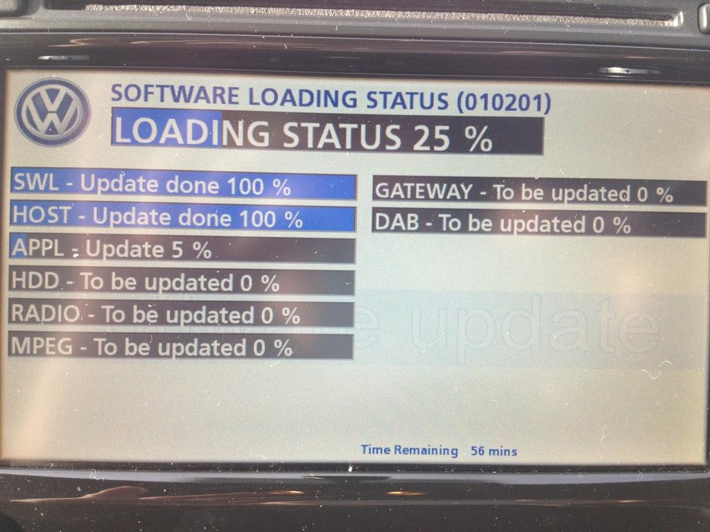

But when I tried going from 3810 to 5218, it loaded fine (see pictures below ) but when the unit restarted it had no sound at all, not on radio, phone or media no sounds at all, apart from that the unit was working fine.

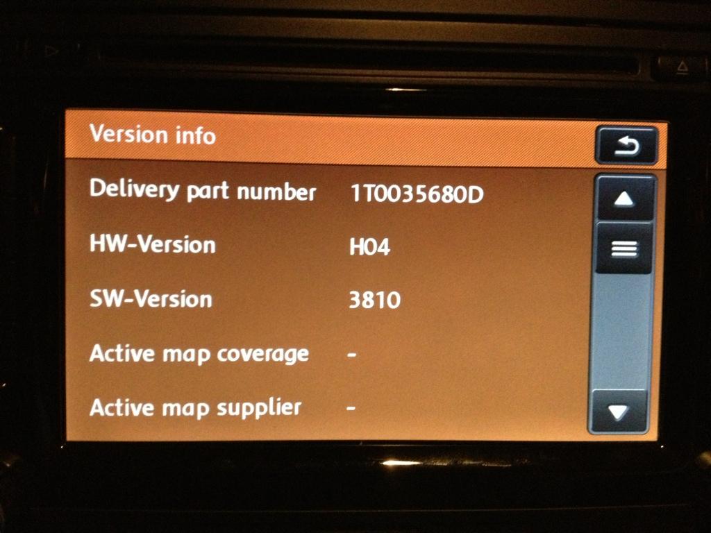

So had to roll it back to 3810, and everything is back up and running fine.
