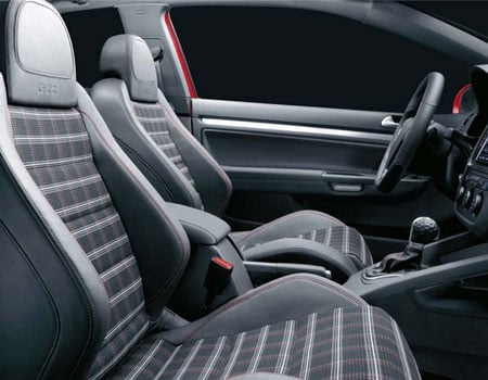

Sounds great but do they fit these? : -
And also chungster's question about door side fixings.

RR - yes, you'll need to undo the shoulder straps to feed them through though.
....I hate to tell you guys this but those like TC and myself will be better off with our Recaros with the belts slotting through. Forces on the easily removable headrest won't be quite as safe in some collision circumstances. However, by sliding the joint closer to the rear of the stock headrest, that factor should improve.
On the other hand, our Recaros don't have such effective 'headrests' and we don't have seat airbags.

friends of mine have used these for ages, will be curious to see how these work out given the GTI head rests have the lip down on the front which goes over the seat back and go over the shoulder, that said we have our cranked up a fair bit
....Unless you choose to crank up your GTI headrests yourself, I wouldn't be surprised if the Schroth belts will crank them up for you! They would surely 'crank' upwards as the belt is subjected to forces while driving - and then the belt straps would then become looser?
I'm just playing Devil's Advocate on this subject and am exploring what limitations these otherwise excellent Schroth belts may have.
« Last Edit: July 23, 2009, 01:24:11 pm by RedRobin »

Yep, you're absolutely right, Robin. Yours have the guide holes for a very good reason, to keep the straps on your shoulders.
I would only use these on the track no matter what seat I had, mainly for the reason on certain types of junction you have to lean forward to see. This would mean loosening the belts to enable you to move and if you were to be shunted, you wouldn't be safe.
In terms of track use:
They're still better than a 3 point seatbelt.
You MUST have them tight
You MUST guide them through the headrest poles to ensure they don't/can't slip over the shoulders of the seat. Doing this makes them no different to the style of seat below, and to be fair the headrest should be raised for most people anyway to work properly.
If it all were to go wrong though, I think a bit of belt marking on the neck would pale into insignificance compared to everything else.
