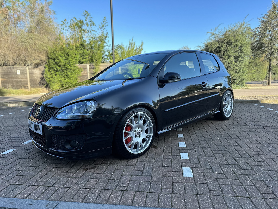

Hello all, I purchased my new to me edition 30 a few months now and it's running superpro bushes all round, b14 coilovers with ARB front and back.. It's very neutral with no added understeer, no lift off oversteer either.. Fitted an lsd and will get to stage2 plus next week...
Talking to Area Motorsport regarding Verkline LCA and some hardrace parts they are suggesting nitron r1 coilovers which they use in their race cars... That's all great but they are £3200 so would like to know if anyone is running nitron?
From people who spend time on track, are the kw clubsport 2 way worth it? They are £2500 or should I go with ohlins or the b16 with single adjustment...
I don't daily the car it's my weekend car / Track car which will see 6 to 8 track days a year if not more... I'd like to be able to soften for road use and have a very good track setup with 255 front 235 rear setup on track wheels.
