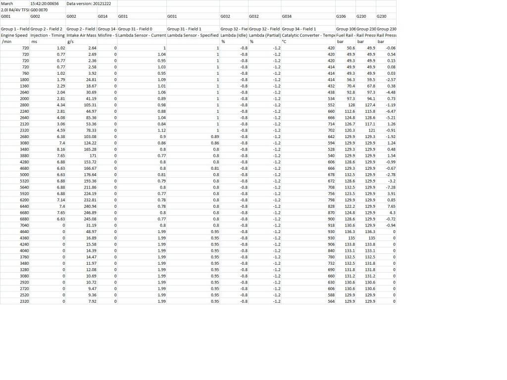

« Reply #16 on: March 15, 2013, 04:45:35 pm »
Here is a 4th gear run log from today
Offline krisbutler02
  • Posts: 46
  • Product development @ Forge Motorsport
    • Forge Motorsport
Re: Very lumpy idle
« Reply #17 on: March 15, 2013, 04:47:57 pm »
logs on idle
Marker   TIME   Group 1 - Field 0   TIME   Group 2 - Field 2   TIME   Group 2 - Field 3   TIME   Group 14 - Field 2   TIME   Group 31 - Field 0   TIME   Group 31 - Field 1   TIME   Group 32 - Field 0   TIME   Group 32 - Field 1
   STAMP   Engine Speed   STAMP   Injection - Timing   STAMP   Intake Air Mass   STAMP   Misfire - Sum Counter   STAMP   Lambda Sensor - Current Value   STAMP   Lambda Sensor - Specified Value   STAMP   Lambda (Idle) - Self-Adaptation   STAMP   Lambda (Partial) - Self-Adaptation
       /min       ms       g/s                         %       %
   0.64   760   0.78   1.02   0.78   3.64   0.91   0   0   0.98   0   1   0.13   -0.7   0.13   -0.4
   1.63   800   1.76   1.02   1.76   3.17   1.89   0   1.02   1.1   1.02   1   1.14   -0.7   1.14   -0.4
   2.66   760   2.79   1.28   2.79   3.25   2.93   0   2.02   0.95   2.02   1   2.15   -0.7   2.15   -0.4
   3.69   760   3.82   1.02   3.82   3.28   3.96   0   3.05   1.04   3.05   1   3.18   -0.7   3.18   -0.4
   4.72   760   4.85   1.02   4.85   3.61   4.99   0   4.08   0.96   4.08   1   4.21   -0.7   4.21   -0.4
   5.75   720   5.88   1.53   5.88   6.03   6.02   0   5.11   1.02   5.11   1   5.24   -0.7   5.24   -0.4

« Reply #18 on: March 15, 2013, 06:03:31 pm »
Car needs to be running for a while before the missfire detection becomes enabled.
Trims on 032 look fine.

« Reply #21 on: March 15, 2013, 08:55:34 pm »
Was that log taken in 4th gear at WOT?
At 4.2k your making about 191HP, less than a Stage 1 K03 - however you then go on to make a full 307HP at max revs (estimated). :confused:

« Reply #22 on: March 15, 2013, 09:22:51 pm »
Yes thats at WOT it does seem low but i havent a clue why.
Any ideas ?

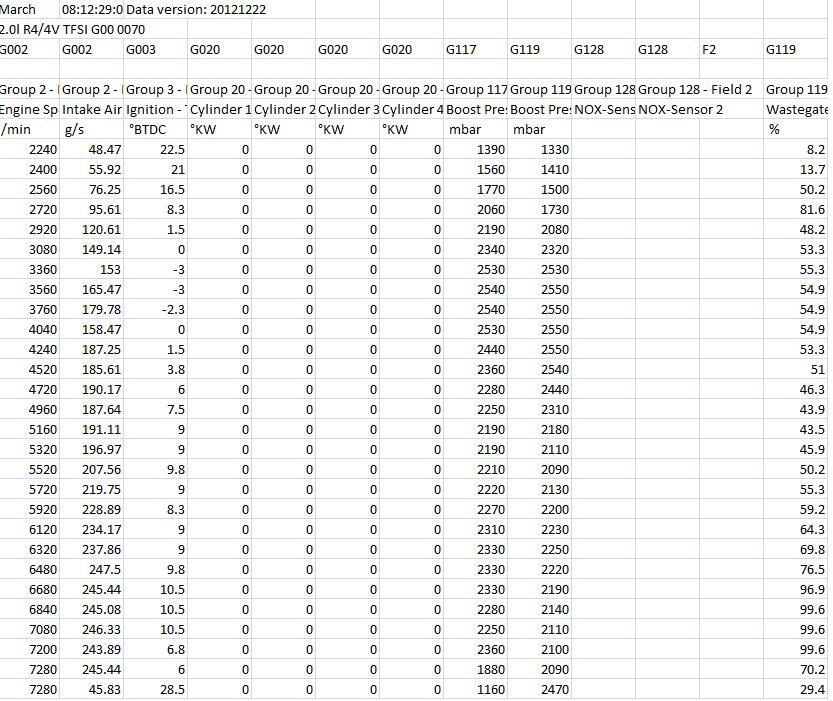

« Reply #24 on: March 16, 2013, 09:08:20 am »
Here is a log from today with a bit more info

« Reply #25 on: March 18, 2013, 08:04:02 pm »
The boost seems to be requesting low values and also fluctuating along with the maf reading fluctuating.
What could cause all these problems.
I need to take it to someone with the know how as im stumped.
This is stage 3 with all the mods you can get bar WMI so surely should be making alot more power than the calculated 307 bhp!
