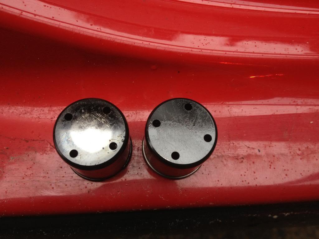

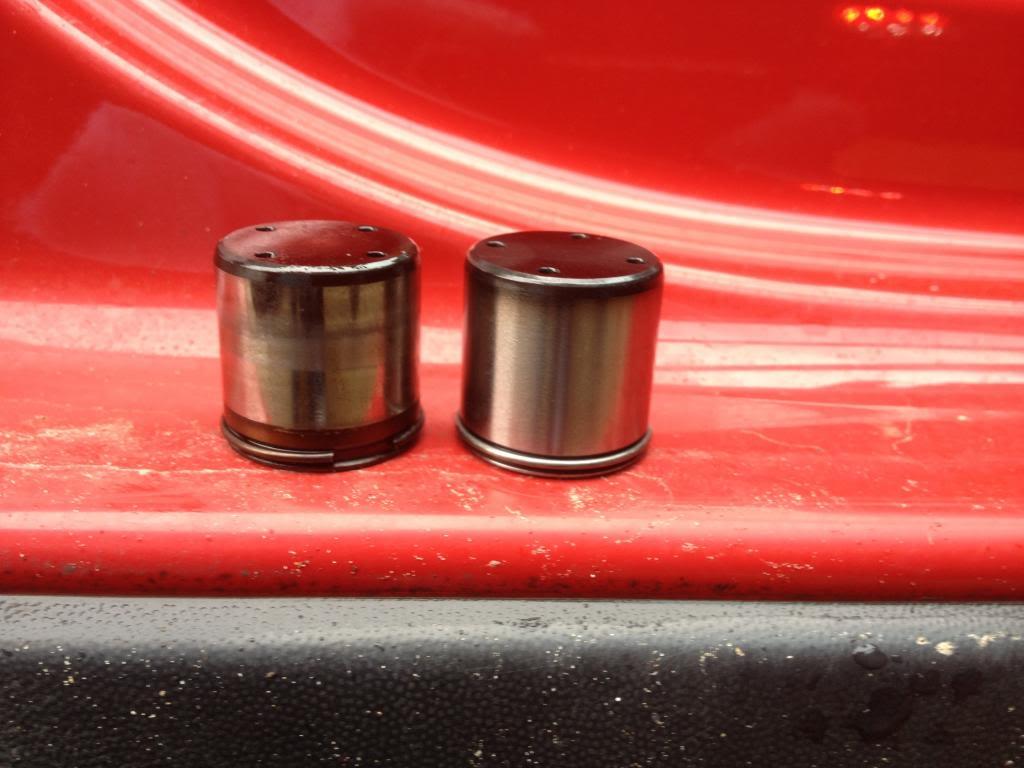

After considering doing my follower for a couple of months and seeing numerous threads appearing I ordered the part yesterday and collected it form the dealers this morning.
I was a little anxious about doing it as I'm going on holiday next weekend (not with the car) and last time the turbo on my old car failed a few days before my holiday and it was all I could think about whilst away. My GTI is a 05 AXX on 65K, therefore as you know it has the banjo bolt with the M8 spline / triple square. After spending over and hour trying to find one on the high street without avail. I had to resort to using on I already had, firmly in a 1/2 socket. To my surprise I managed to remove the bolt with this and was relatively easy. I think this was mainly helped by the fact of the hype of difficulty of removing it. Anyway, it was good news as you can see below:
As you can see it was in ok condition with expected ware but feel it was worth doing and have got piece of mind for another 15k. Thanks go to the guys who support the awareness of this issue  :happy2:

Good news there mate, that's not too bad that.  I'm waiting for the weather to get more friendly to do mine again, it's been in ~25k.
Out of interest were those 65k miles, tuned or standard?
Yeah I was waiting for the weather but just wanted to get it and see what it was like. It has a stage 1 remap at 55k, also got the revision G DV whilst at the dealers, think ill await better weather for doing that.
