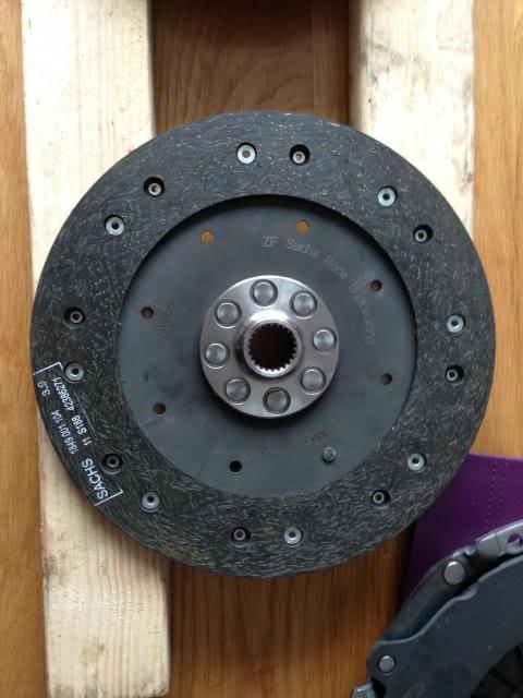

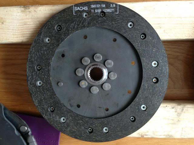

Anyway for my own sanity can someone firstly confirm the image of the clutch disc below is the side that faces the transmission I can only vaguely remember my clutch install from last year?
And the image below is the flywheel facing side?

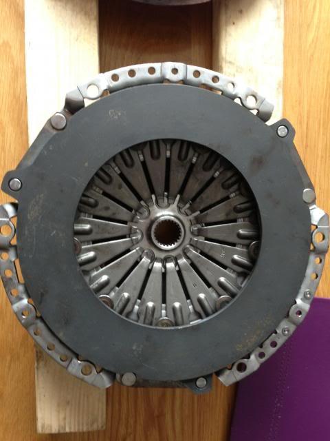

I thought it was quite strange how the clutch cover has no marks on whatsoever which made me suspect whether the release bearing (Sachs) was working properly, which it does seem to be and as a safe measure i compared it with the original Seat one.

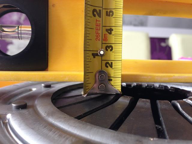

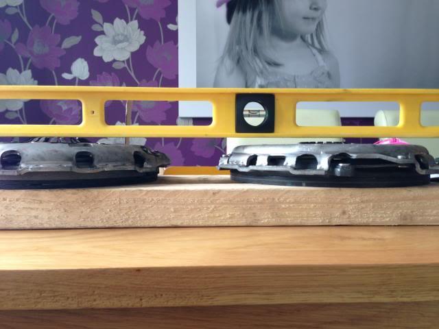

I then thought as a safe bet I would compare the clutches and found that there is a 7-8mm difference in the height of the clutch and this makes me wonder if it is in range of the bearing?
Sorry about the use of a tape measure I couldn't find my vernier calipers lol
