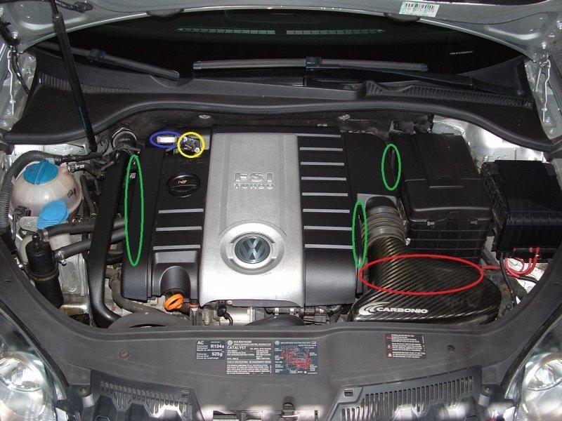

It's back so looks like I need to get the part replaced etc. looking at the engine bay front on it's the part connected to air flow pipe drivers side with two Torx screws and has a bit that you clip in/out. Before I make a ... Of myself what's this part MFW???

MAF is circled yellow.
Remove the elec. clip and 2 torx screws and pull it out.  :happy2:
